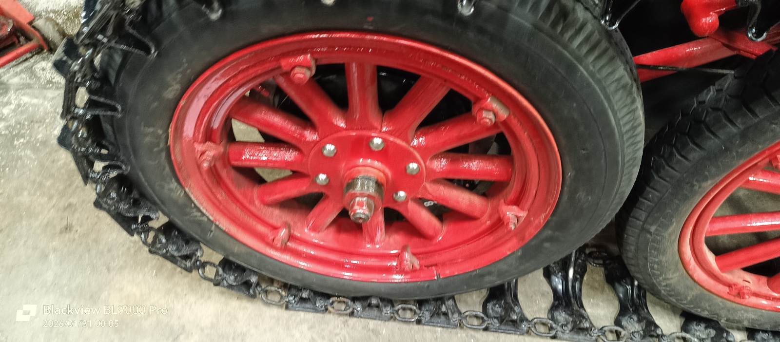

I am new to the wonderful world of the Model T. A little background: I have been involved with the Maine Forest & Logging Museum in Bradley, Maine, for quite a few years now. Back in December, we received a generous donation of two Ford Model TT trucks with Virgil White snowmobile conversions. Needless to say, we are pretty excited about this. One is a 1926, the other is a 1927. However, we suspect the 1927 is a bit of a mix and match.
We are currently working to recommission the 1927. In addition to changing out the fluids, etc., we have replaced the bands since the cotton bands were way, way beyond their expiration date. Hopefully, over the next week, we can rack up some running time to work out any remaining bugs.
We are a Living History museum, meaning that our vehicles and exhibits all function and are operated and demonstrated on a regular basis. In fact, the 1927 TT snowmobile will debut during our Winter in the Woods event on February 7th. As we move forward, we will no doubt be seeking advice.
The TT's will be operated alongside our steam-powered Lombard Log Haulers and Lombard Tractor-Trucks.

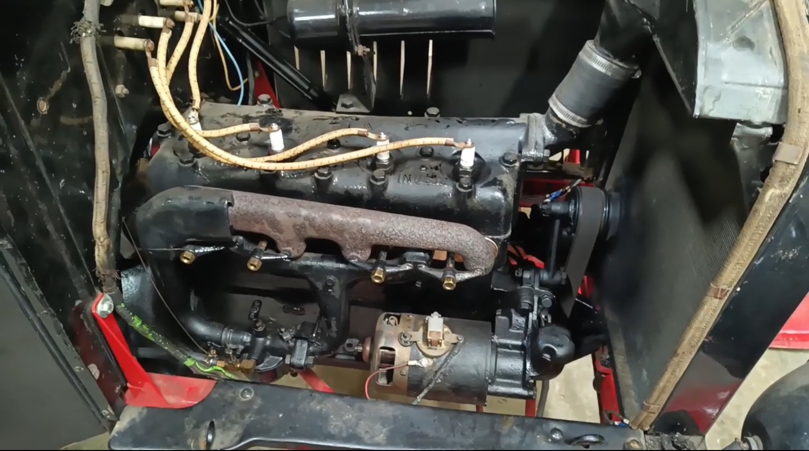

Back to the TT
There was little left of the bands in 1927. This also presented our first surprise. When Tim opened up the transmission, we found that it's an older version with the narrow brake band. We have not checked the engine numbers. Both TT's have Warford transmissions. The drums had some scoring and tapper, but not too deep or bad—no deep rivet gouges. After a bit of debate and going back and forth, we decided to go with wood bands. Our reasoning, whether flawed or otherwise, is that wood bands might be more gentle on the drums than Kevlar, given novice drivers and less-than-perfect technique. Additionally, and thankfully, Winter doesn't last forever, so it's not like we will be touring for thousands of miles.
We decided to replace the springs as well. Big difference in uncompressed length between the new and old springs! Tim did have a problem with the magneto cutting in and out. It turned out to be a piece of an old band that had found its way to the Mag post.
The 1926: This is a running chassis. Currently, we are debating what style body to go with. Our first thought was a depot hack or bus so we could carry passengers; however, our insurance underwriter would probably not be happy. They have been great to work with, but they would undoubtedly prefer if we were a "normal" museum with all stuffed and mounted (static) and boring exhibits. In short, we are tolerated, which is understandable.
We are open to suggestions!
Here is A view of the 1926 chassis as we found it. The stack of stuff to the right are runners, and bunks, etc, for two heavy Lombard patent logging sleds.

Re: New here and an Introduction
The above picture of the transmission shows it is an up to 1925 block and transmission and band, not 1926-27.
It is a matched set and goes together.
The magneto ring coil could really use to be rewrapped but that will open up a barrel of snakes for you.
Serial numbers and engines got swapped around as these vehicles passed through their service life.
Trucks and work vehicles were more prone to this since it just had to work!
Since you are not doing a numbers matching restoration make sure to use what you have and not what it is called on the title.
The type of band is your choice, everyone has their reasons and preference.
But you can wreck even the best parts so careful driving helps the vehicle and parts last longer.
Model T't are made to take rough treatment, but it leads to higher maintenance.
Keep up running this living history and showing how it used to be done.
Having them locked up behind the velvet rope is so boring to me.
Mike

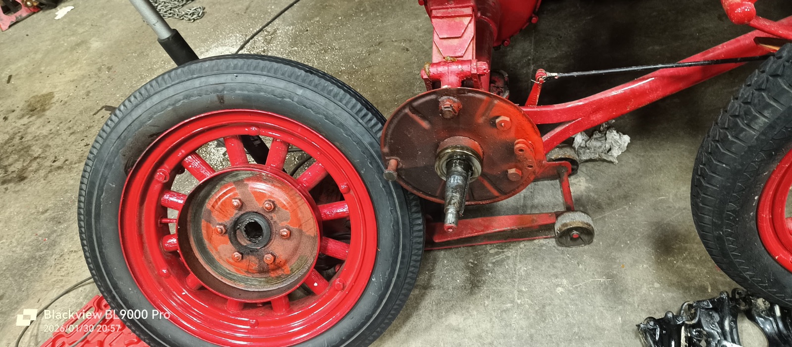

And this would explain why the emergency brake doesn’t work. Good grief! Note the bolt that backed out and was rubbing on the drum.

I see a WTB add coming.

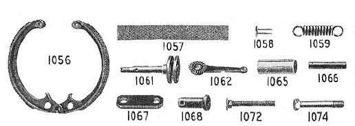

The TT rear brake parts are TT only so make sure not to get 26-27 parts and try to make them fit.
The vehicles have history - Some good, Some bad.
And they will work "fine" in amazingly poor condition.
Keep at it, eventually you will get to the bottom of the list.
Mike
Mike

Just to clarify, the shoes for the 26-27 TT are NOT interchangeable with the shoes used on the 26-27 car correct?
Lets see if I get the 3C's right, if not I am sure someone will correct me.
Concise, Complete, & Correct
Hopefully someone who has one apart can post pictures of a correctly assembled one.
I do not currently own a TT truck but I have seen plenty of their parts on friends vehicles so I am not a TT "expert"
While the TT Truck and the 26-27 Car share a similar looking rear brake drum don't be fooled into thinking they share parts.
And the same is true for A or AA parts.
Other than a bit of hardware there is nothing shared between them.

You have 2 of the 5 rim bolts that have been "Farmer Fixed" with regular bolts and washers.
Plus
The reason your drum was dragging on the bolt could be a couple reasons.
It is supposed to be a thin head and someone put a regular head one there?
The hub and or axle are worn moving the drum in farther making it drag?
There is a problem inside the rear axle making parts move around?
So grab the axle and see if it moves in/out or up/down. Hopefully it will all be nice and secure and no issues inside the rear.
How Far Does The Wormhole Go?
Mike

The shoes for a TT are completely unique to the trucks, and are different and much larger than the car brake shoes.
They are cast shoes, with a riveted lining.
I don't know what availability exists today, but it took me forever to find a pair in the snail mail want ads world of the 80's.

Thanks Mike,Mike Silbert wrote: ↑Sat Jan 31, 2026 9:34 amThe reason your drum was dragging on the bolt could be a couple reasons.
Mike
Very good info! Tim checked for play in the axles and they are good. The bolt either just backed out or it was left loose last time someone was in there. There are a number of farmer fixes on this gem but we are getting there.

Already installed! Tim, Brian and James started around 8:00pm last night and had it all done by 1:00am this morning.speedytinc wrote: ↑Sat Jan 31, 2026 7:18 pmTerry, I dont believe there is an off the shelf sure stop brake system offered for a TT.
Not to say you couldnt build a disk brake system for your TT.
Brian had to fabricate some custom spacers for the calipers so they line up properly with the disks. They also installed the reservoir the under the seat rather than on the firewall Brian ran the longer carriage bolts that come with the kit through the CNC lath to shape the heads to better match the originals.
The brakes work great!

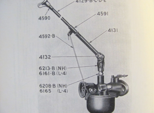

The mixture/choke control rod is missing. It’s got a hokey wire setup so you can operate the choke from the cab. That is on the to-do-list. I am assuming this is the correct setup? Yes, it pays to be methodical. What isn’t the problem is just as important as what is!
We do have the heat pipe in place. We are getting full timing travel. They set it per the manual and adjusted the rod. Before that we had very little retard when using the lever.
We will check the coils

The picture gives lots of information, thanks
You have an up to 1924 (& some of 1925) carburetor so it takes a mixture and choke setup not like in the drawing you sent.
It could be converted if desired but that means more parts.
The dashboard and control rod slots in the firewall determine what pieces you need. You also do not have a mixture adjustment control inside the cab hooked up.
This will prevent you from adjusting it while driving to test and fine tune what is going on.
See: https://www.mtfca.com/discus/messages/7 ... 1506901129
If it were mine I would make something work with what you have and look good.
There are several styles over the years and I don't know your exact combination of parts.
Your carburetor fuel shutoff valve:
I recommend installing a shutoff valve on all but the show winning cars but..
That style is not known for flowing very much fuel.
If it acts like you are running out of fuel, it might be the problem.
This can be tested by adding a bit of choke when it is acting up to see if it fixes it.
I think I see a missing pan bolt, and it's not leaking?
The missing generator band and cutout cover are not a big deal. You might want to upgrade the cutout in the future someday.
Make sure your rubber fuel line stays far away from the exhaust pipe or you may have an "overheating" issue.
The route places them closer than comfortable causing problems sometimes

Mike is correct - as best as I can discern from the photo, that "shutoff" is really a plumbing needle valve for water lines to refrigerator water dispensers. The flow path is tortured and very very tiny. With trucks being geared down, and higher RPMs standard, you will most certainly be starving for fuel to some extent, quite often. Change it to a 1/4 turn ball valve and be done with that weak link in the system.
Over the years, I've come across this valve on 3 occasions. In all instances, the car did not really run "right" at any speed over idle. Changing it out fixed that problem in each case.

Gravity flow fuel systems will not tolerate any added restrictions to the fuel flow. That includes added filters, many types of non-stock shut off valves, dents in fuel lines, improperly routed fuel lines, low float level, plugged gas cap vents, and incorrect carburetor needle and seat sets. That's in addition to dirt, rust, moisture, gum, or anything else that might in any way obstruct the free flow of fuel. It's best to keep fuel tanks at least half full, and more is better.

A few years ago we were working on a TT truck that would run fine then go for about 1/2 a block and die.
In a minute or two it would restart and run great then die when you drove away.
Frustrating!
After going through everything we discovered the problem.
The replacement ball valve right angle shutoff was drilled off center blocking 1/2 the hole, and 1/2 the fuel flow.
And it was a brand new part!
When we replaced it the truck ran all over the place with no problem.

A few more photos of the TT out and about before it became unhappy.
