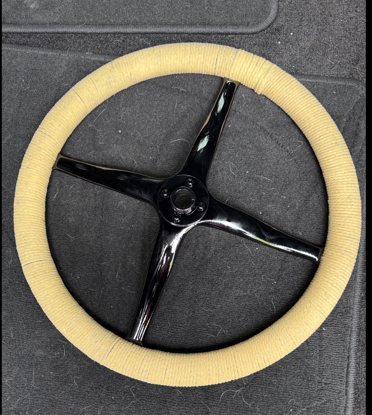

Just got done wrapping the steering wheel on my speedster. Wondering what the best finish is to put on the jute. Shellack, varnish...?

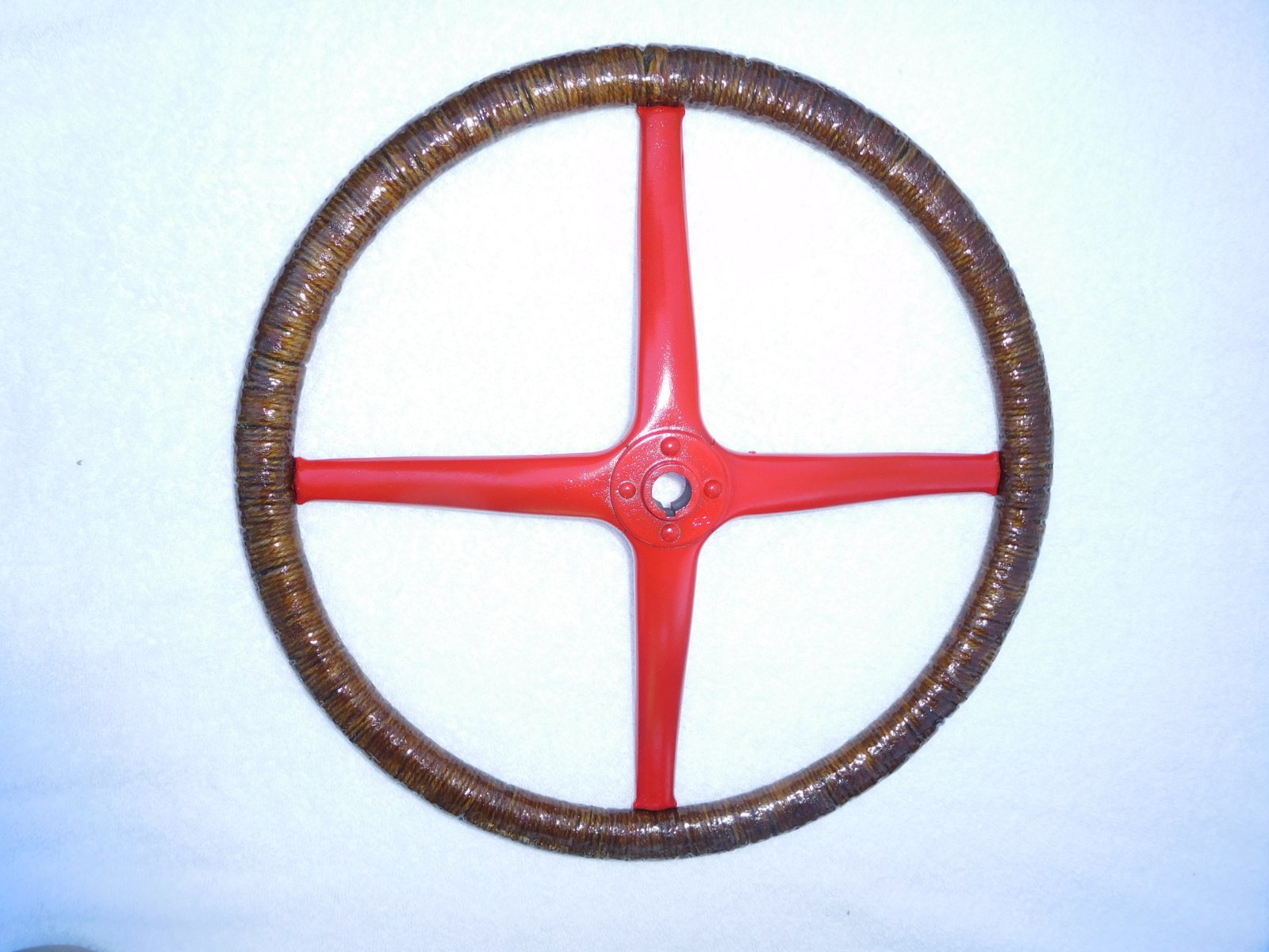

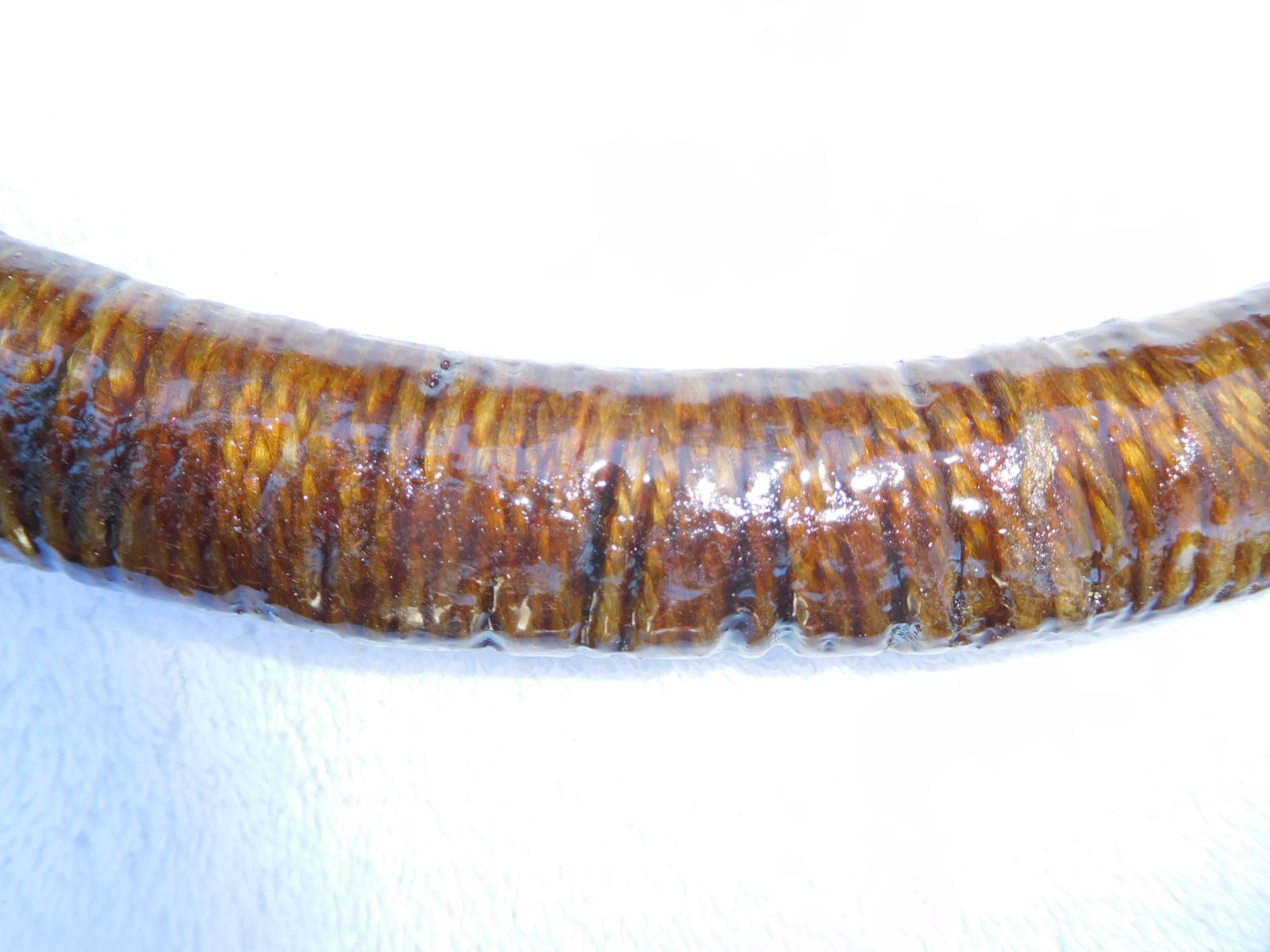

I saw this on the forum several years ago and used cotton rope/ twine for this wheel.
I applied spar varnish, as I had a can handy.
As you can see, it turned the cord a light shade of yellow.
Scott

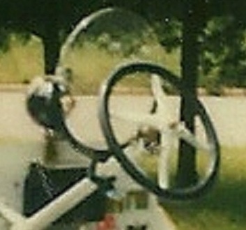

Built a '15 speedster years ago and wrapped the Fordite wheel with overlaps of friction tape, then applied coat of clear spar varnish. Looked good and felt like a race car in my hands. :D
Pic is a scan and blurry......
