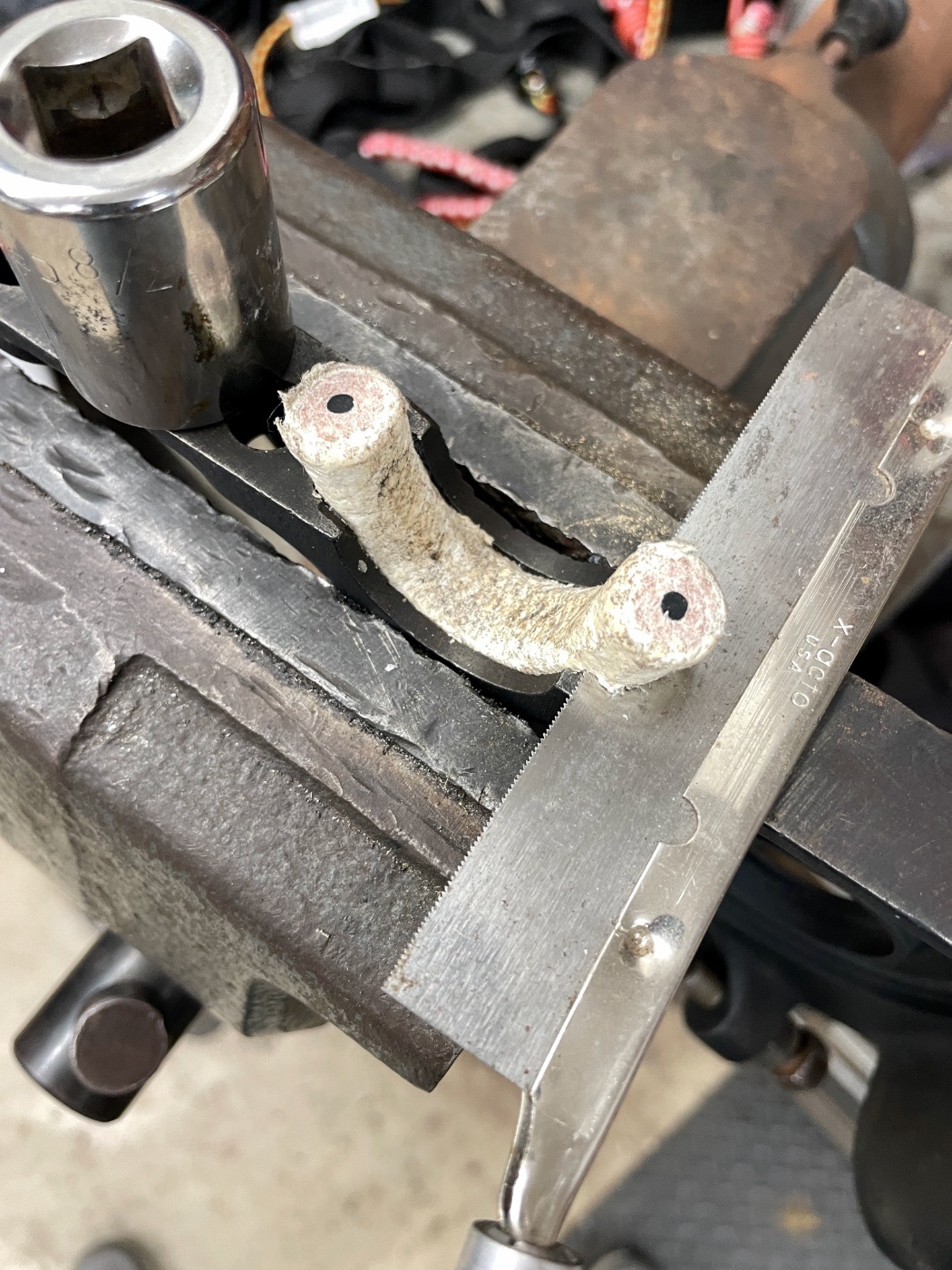

I always use the white rope seal used in A models. The two halves are longer than needed. I fit the seal to the pan, forming it into round with a socket of appropriate size, and trimming off the ends, leading them a little long. Same s=fitting in the timing cover. The pan gasket is cut around the proud part of the gasket. When the pan is fitted , the extra crush on the proud sections of the gasket make for a firm seal.

I have always used the rope seal installed the same a Allan with no issues.

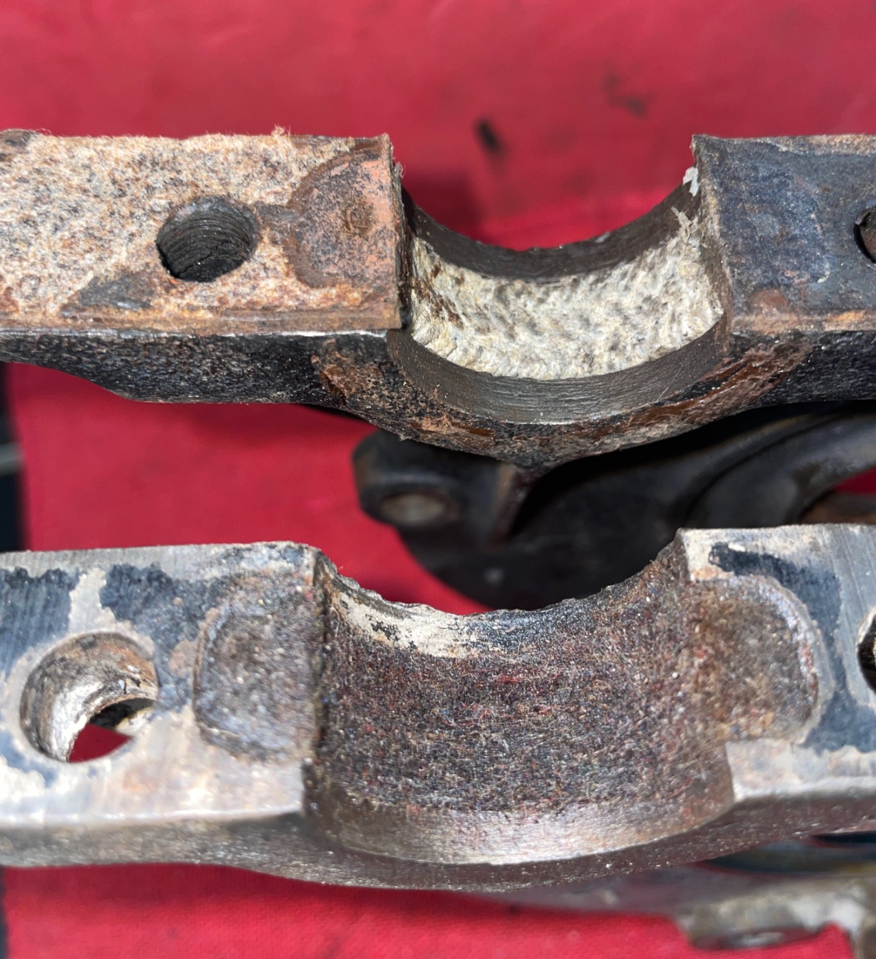

Comparison of felt (lower) and rope seal (upper)
Install of rope seal in timing cover

The rope seal is superior to felt. The white-colored rope seal is probably impregnated with white lead or teflon. It needs to be snug, but not jammed extremely tight. Oil it before putting the pan on. Care in installation will give a good result. The surface finish of the crankshaft will affect how well the seal works and how long it lasts.

Good, dense felt can be an effective grease seal. Think front wheel hub seals and LH rear axle seals. It is not so effective as an oil seal. Think timer seal, land in which T crank seal fits and RH axle seal, often diluted with engine oil.
Modern lip seals require an accurately machined land into which they are pressed. T front camshaft seals often need to be deformed or shimmed to fit. The receiving land in the pan and timing gear cover is not such a machined land, and using a modern seal in this application comes with its own set of fitting requirements. The lip may seal well but the outer diameter of the seal in the cast-in grooves of the pan and timing cover present their own work-arounds. There are no such requirements when using the white rope seals .Each half can be fitted in separate operations and there is no chance of damage negotiating a somewhat experienced crankshaft snout when fitting same.

The felt seals provided in the gasket kits today is not up to snuff. It is way too loosely felted. Fit one to a timing cover and fit the cover to the block. Then see just how much you can punch the felt tighter on each side of the crankshaft. Just another repop part not fit for servise. No such problem with a trimmed A model white seal.
