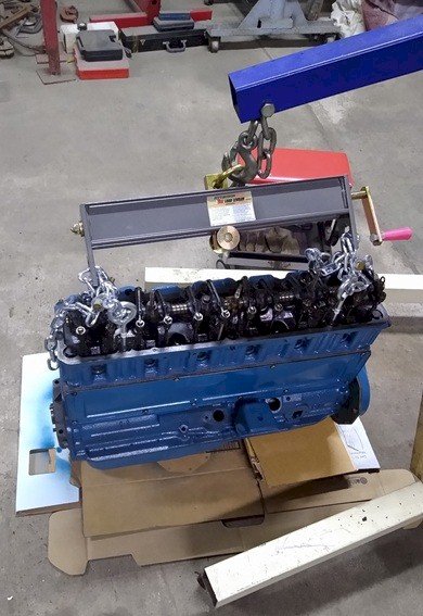

There is nothing wrong with using 2 eyebolts like they show in the above picture if
you think that is a better way to go. I do not think anyone used the ice tong method anymore.
I have always used the one eyebolt method and so has our club.

Like these?

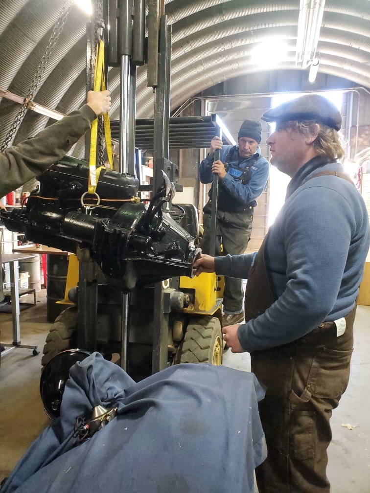

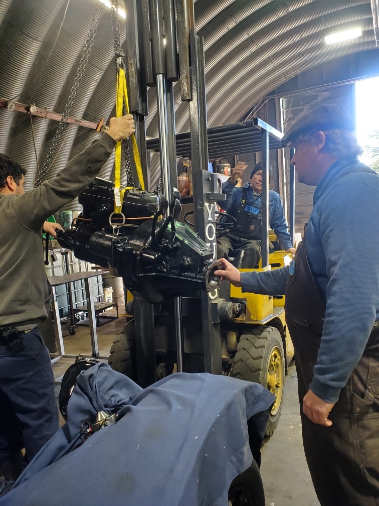

I just use a nylon sling. I move it forward or back depending what angle I need.

The 3rd plug hole allows engine to lift straight up off the frame rails, pull forward to clear the pan mounting ears from firewall brackets.
Then switch chain to 2nd hole to give tilt balance to angle engine under firewall and free the pedals.

Buy, rent, steal or borrow one of these gems… …maybe I’m spoiled since I got one, but it sure makes it safer and easier, especially pulling an engine out from the chassis or installing one that has its transmission attatched. Good luck and have fun! -Chris, in Boulder

I have a load leveler and have used it before.
If you use them on a Model T when you tip the engine to clear the pedals it jams the back into the firewall.
They work great on other cars but be careful rigging them on a Model T to stay away from the back.
Stay biased forward where it looks all wrong. The firewall can be removed but the cowl is much more difficult to remove.
Henry did not design the engine compartment to use one for some reason.
When balanced, the screw should be way towards the back end and not centered like normal.
Personally I use it on other cars but not my Model T's.
Everyone has their own personal preference, you have to figure out what works for you.
All good tools can be used badly and create problems.
Since this is your first time, take your time and be careful.
Getting help is also good since there is a lot going on when the engine starts coming out
Mike

One old cheapskate's approach was to remove a couple of head bolts and bolt a short chain to those two holes.
