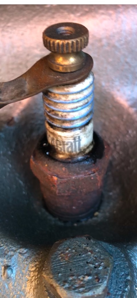

Corey Walker
Posts: 680
First Name: Corey
Last Name: Walker
Location: Brownsboro, TX
Re: Autolite spark plug number
Post by Corey Walker » Sat Feb 07, 2026 12:04 pm
I took a screenshot from a video of this Motorcraft plug. It was arcing on top between the porcelain and threaded section. That’s the only problem I’ve ever had with them.
