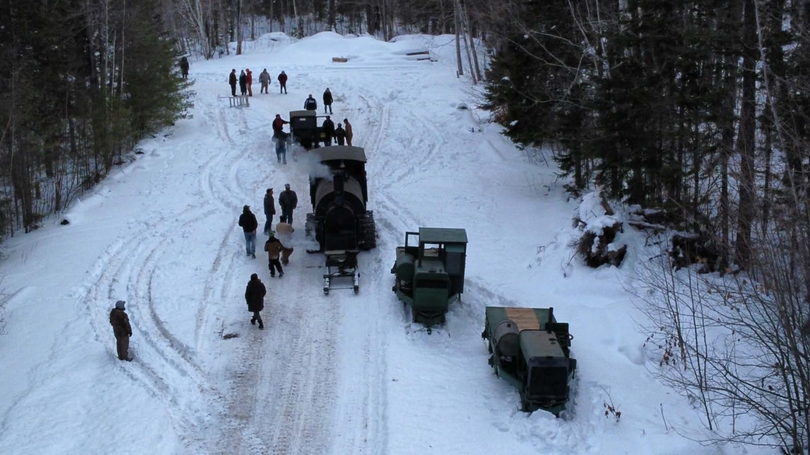

The TT's will be operated alongside our steam-powered Lombard Log Haulers and Lombard Tractor-Trucks.

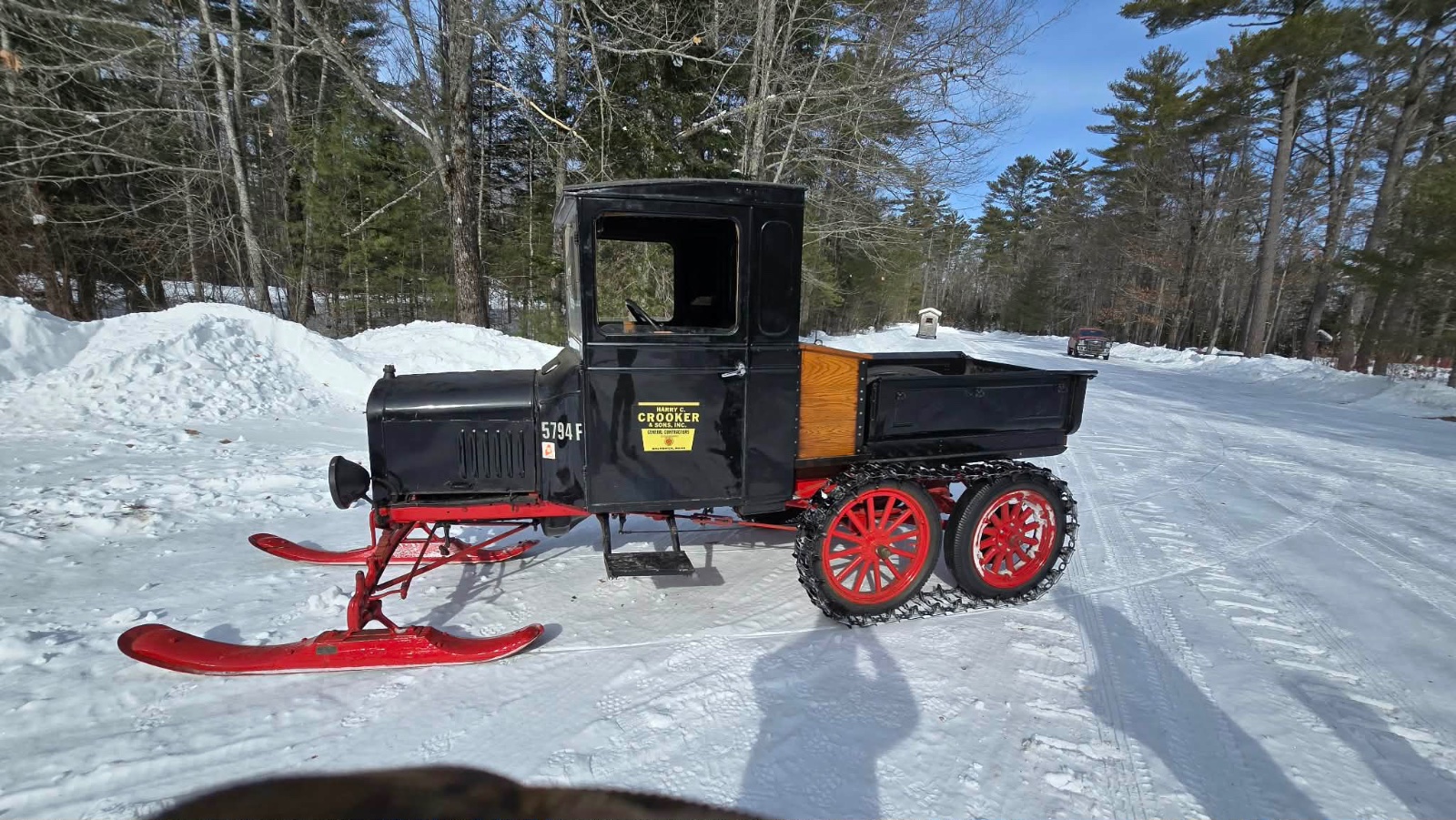

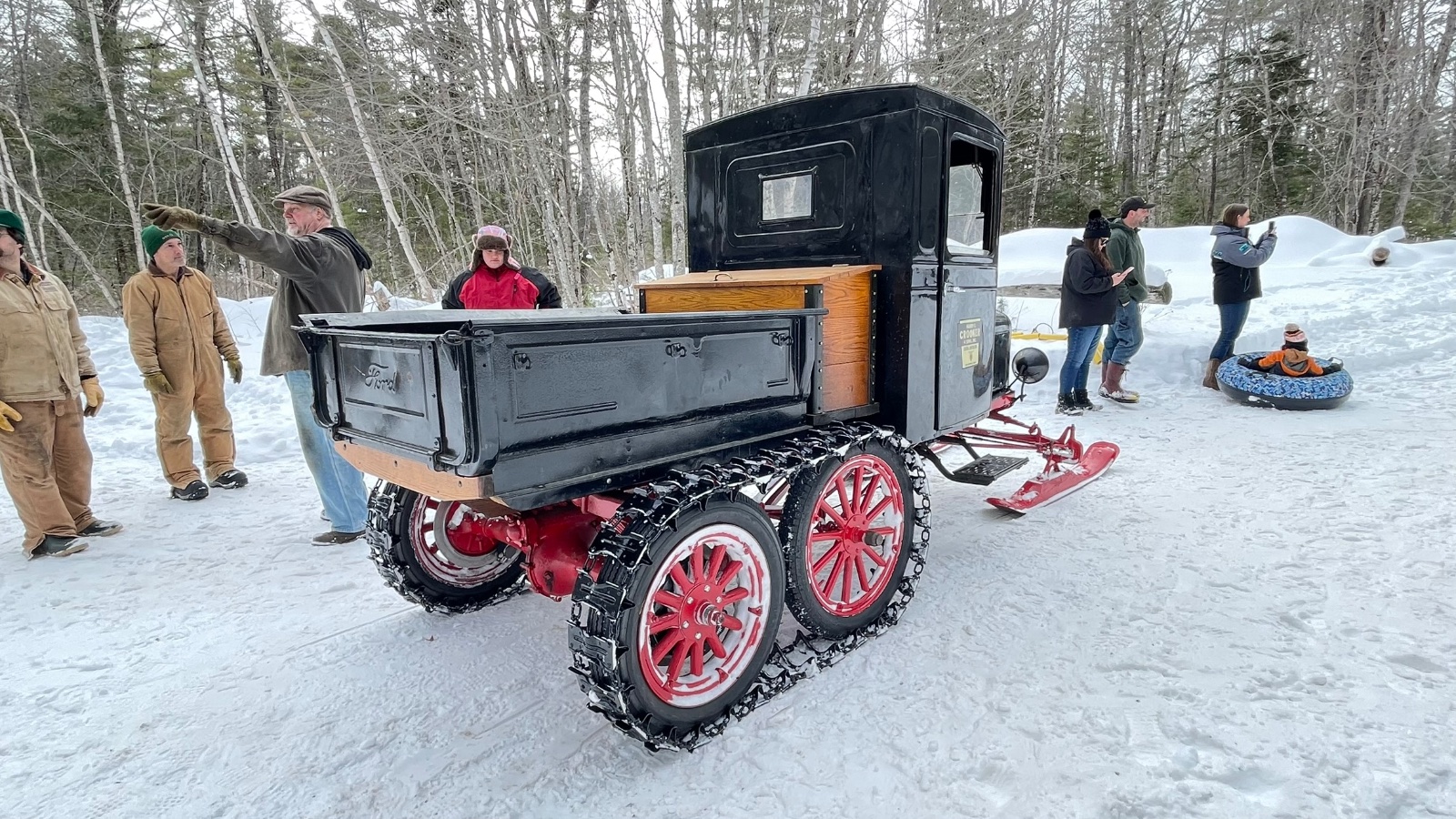

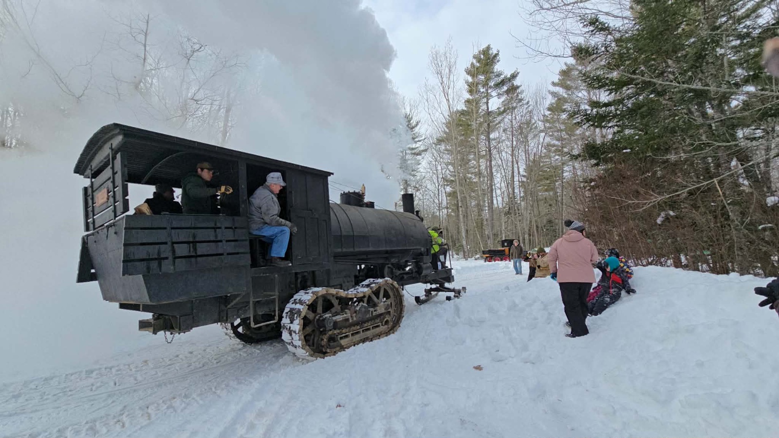

In addition to the two model TT snowmobiles, we were also gifted a 1914 steam-powered Lombard Log Hauler restored by the late Harry Crooker. It’s been on loan to the museum since 2013 and is now a permanent part of the collection.
This shares space with our 1907 steam-powered Lombard Log Hauler which is fully operational and frequently under steam and out and about during our events. On February 7th we will have it out on skis for the first time in over a decade.
We do have another Model T… to clarify, before you get too excited - it’s an eight-ton, 1928 Lombard Model T dump truck. It’s an interesting beast. It has a four speed Cotta transmission. However, reverse is in the differential and is engaged with a separate lever so you have four speeds forward and in reverse. The hoist is a Garwood mechanical unit.
From time to time it does make itself useful.

Location: Sykesville Md
Re: New here and an Introduction
Post by Mike Silbert » Mon Feb 02, 2026 9:35 am
The picture gives lots of information, thanks
You have an up to 1924 (& some of 1925) carburetor so it takes a mixture and choke setup not like in the drawing you sent.
It could be converted if desired but that means more parts.
The dashboard and control rod slots in the firewall determine what pieces you need.
Screenshot 2026-02-02 092401.jpg (11.61 KiB) Viewed 1699 times
You also do not have a mixture adjustment control inside the cab hooked up.
This will prevent you from adjusting it while driving to test and fine tune what is going on.
See: https://www.mtfca.com/discus/messages/7 ... 1506901129
If it were mine I would make something work with what you have and look good.
There are several styles over the years and I don't know your exact combination of parts.
Your carburetor fuel shutoff valve:
I recommend installing a shutoff valve on all but the show winning cars but..
That style is not known for flowing very much fuel.
If it acts like you are running out of fuel, it might be the problem.
This can be tested by adding a bit of choke when it is acting up to see if it fixes it.
I think I see a missing pan bolt, and it's not leaking?
The missing generator band and cutout cover are not a big deal. You might want to upgrade the cutout in the future someday.
Make sure your rubber fuel line stays far away from the exhaust pipe or you may have an "overheating" issue.
The route places them closer than comfortable causing problems sometimes
The metal line won't melt and may be in your future someday.
Steel brake lines work fine but sometimes more expensive than buying the correct part.
I prefer the reusable rubber seals over felt if you go that way.
I like it!
Mike

Post by Scott_Conger » Mon Feb 02, 2026 10:55 am
Mike is correct - as best as I can discern from the photo, that "shutoff" is really a plumbing needle valve for water lines to refrigerator water dispensers. The flow path is tortured and very very tiny. With trucks being geared down, and higher RPMs standard, you will most certainly be starving for fuel to some extent, quite often. Change it to a 1/4 turn ball valve and be done with that weak link in the system.
Over the years, I've come across this valve on 3 occasions. In all instances, the car did not really run "right" at any speed over idle. Changing it out fixed that problem in each case.

Post by Tharper » Sun Feb 08, 2026 3:02 pm
Well.. yesterday’s “Winter in the Woods” event went very well. We had over double the number of visitors from last year, the weather cooperated, we met many new friends and everyone seemed to have a fun time.
The TT snowmobile was a big hit and ran pretty good. It seemed to be improving as we went through the day. However, on the last run the magneto quit and when we went to start it the starter locked up. Tim performed a bit of investigating and found one of the magnet clamps wedged in the bendix! Needless to say, it was towed back to the its storage space (with the Warford in neutral) and ended the fun with the model TT for awhile.
We will need to pull the motor, assess and damage and dive into the magneto. While we are there, we will access if we need to rebuild the engine as well.
This was the first time since 2015 that we had the 1907 steam-powered Lombard Log Hauler out in the winter as it was originally designed to be.
It was late in the day so it’s kind of dark and the crowd had thinned out but here we have the 1919 and 1934 Lombard Tractor-Trucks along with the steamer and the model TT. at this point we where trying to diagnose the problem.
Running old vehicles and equipment is always a challenge but it keeps life interesting!

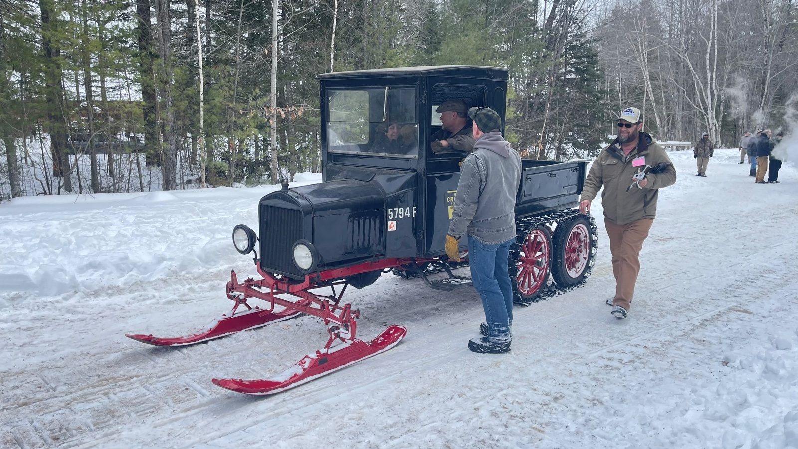

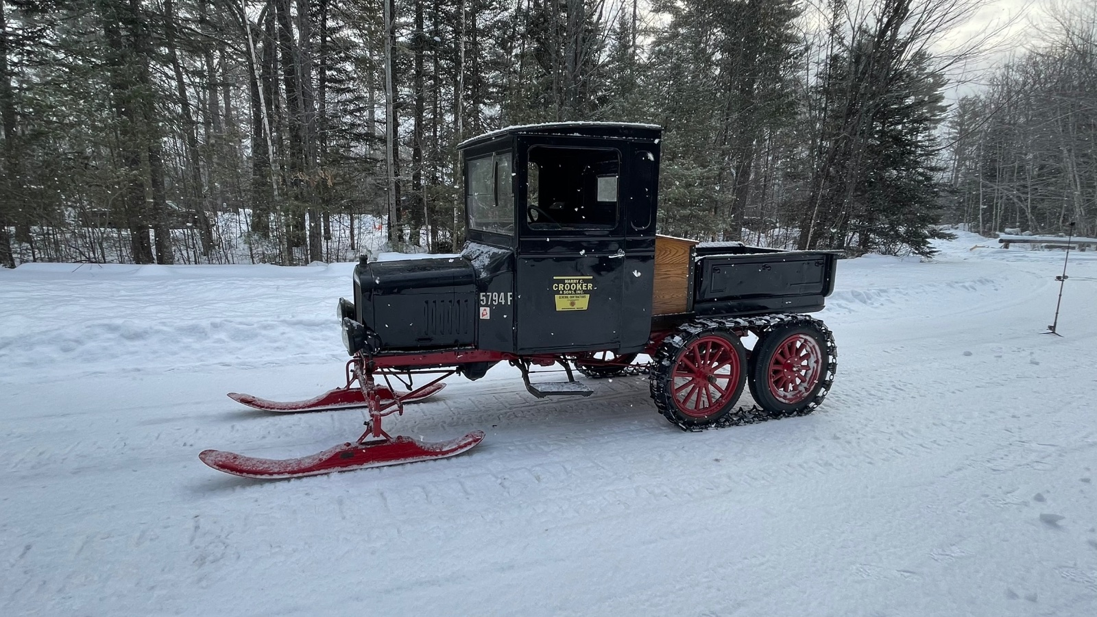

Post by Tharper » Mon Feb 09, 2026 7:00 pm
A few more photos of the TT out and about before it became unhappy.
Posts: 8605
Post by TXGOAT2 » Mon Feb 09, 2026 8:40 pm
Steam powered equipment is wonderful, but deadly dangerous if not handled correctly. Boilers can explode with incredible force.

Post by Tharper » Mon Feb 09, 2026 10:00 pm
Yes they can. The original boiler was made in 1907 and was lap seam which is not legal here in Maine to run in public. It was also well beyond its life span. The current boiler was fabricated in 2013 to ASME code. It undergoes a State boiler inspection every year. We are very careful in regards to water treatment and layup. Our operating crew includes four licensed boiler operators.
It’s an amazing machine to operate.
