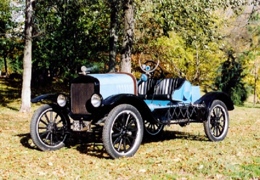

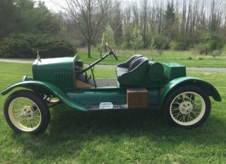

There were several Speedsters in Maryland about 50 years ago, when I moved here.
Most were copies of a kit that Sears and Roebuck sold, just for Model Ts in the earl 1915s and later 1925.
I have copies of some of them and some kit photos that someone sent to me.
Here are two I remember.

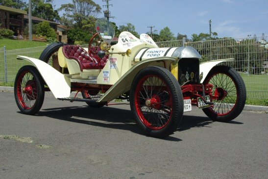

Is this the kind of thing you are looking for, the original builder of my speedster had a metal curved shape built in the shape of a tiger moth cowling.
It just goes back from the normal wood dash and around the sides.
