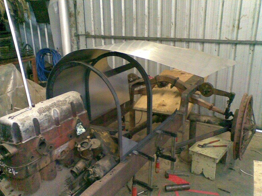

Here are some old threads with pictures of making a single seat metal cowl. Enough to modify for a two seater
https://www.mtfca.com/discus/messages/2 ... 1329706112
https://www.mtfca.com/discus/messages/2 ... 1330934603
Another example
