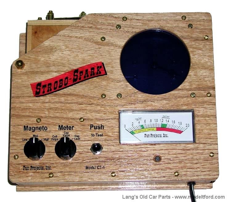

When I started out in T's I did my own coils setting them on a home made tester. Then I got much better results HCCA local club member using his own tester (he is now deceased). I then had Ron Patterson do my coils for my 1913, and later my 1927. Eventually I discovered that Roger Barrett (Erik's father) does coils.
By far the best were Ron or Roger. Sending to Ron will cost more than to Roger and will entail at least a week or two wait. You live in Folsom so you are about 30 minutes from Erik and Roger. Roger will set them on his Strobe-O-spark unit. The will run just like Ron's coils and last just as long. The advantage to you is that Roger is so close, you can drop in for a visit and immediate adjustment if there are any problems. The downside is I don't know how long Roger will continue doing this, I bet he will retire sometime... when he gets old enough!
I suggest you call Roger and chat about it. If you can't find the phone number then send me a p.m.

Forgot to mention that Roger can rebuild including points and capacitor replacement. I
I don't know Roger's prices, but I know I can pinch a penny harder than anyone and I always smile when leaving Erik's. I will be dropping a full set of coils with Roger when I go to Erik for new rods and babbit in a week. The coils are destined to sit on a shelf awaiting the restoration of my Omnibus.

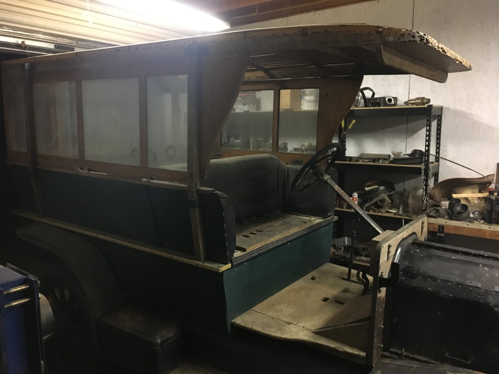

Thank to all for the valuable advice. I really appreciate the input. Terry that's a beautiful car! Where on earth did you find it? Does it fit on a TT or T chassis?

Richard,
The body is a perfect fit on a T chassis. That body came out of Pasadena, Kim Dobbins generously sold it to me so it wouldn’t have to meet a fate of conflagration. The running gear had lots of high powered stuff and went to someone for a speedster.
My 1912 running gear come from Penny Miller. Her late father Mel collected it.
This is an English Station Omnibus body exactly like the plans published in the September, 1916 issue of “The Fordowner”. These rear-entrance tonneau bodies were produced in 1915-1918. It is typical that an aftermarket body would go on an older chassis such as my 1912.
Here’s what I am shooting for:
