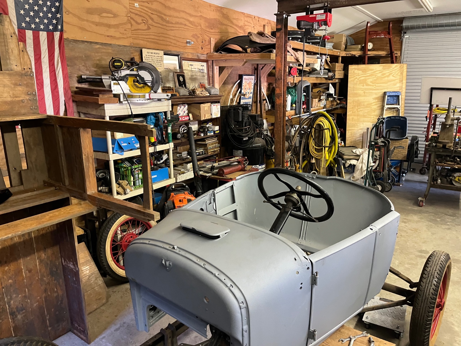

Post by Corey Walker » Sun Feb 08, 2026 5:52 pm
I’m about ready to drop my motor in a speedster I’m building. I’ve got the front and rear axles done, next comes the body. It’s an Overland body but I might want to go for a spin before I take it off for bodywork and paint so I had to drill holes for a coil box. Never used one of those step bits before.

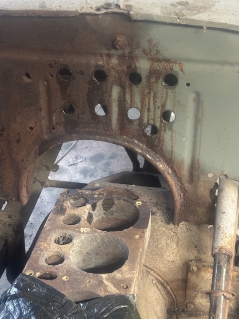

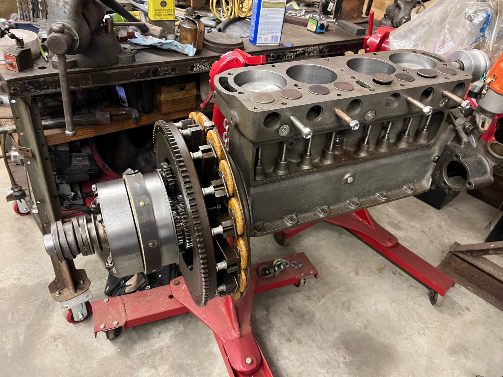

Post by MossPointMachine » Sun Feb 08, 2026 6:16 pm
Pulled wooden truck body from the 25 my Dad passed on to me. Sheet metal mostly painted and Dad was building the engine when he passed away 2 years ago. Finishing up the engine and playing around with front half touring car on the frame. Wheels are NOS Fords dad bought years ago.

Post by speedytinc » Sun Feb 08, 2026 6:29 pm
Dont leave your engine sitting horizontal.
That puts a big strain on the crank from an unsupported transmission. Tip it up vertical.

Post by MossPointMachine » Sun Feb 08, 2026 7:28 pm
Yes thanks for that, I just bored the fourth main and installed it with engine vertical.

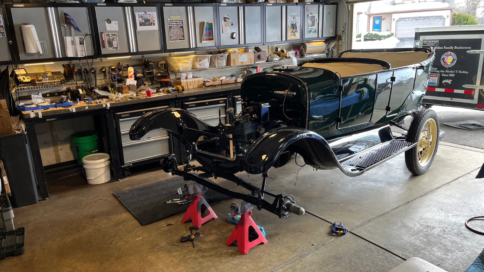

Post by Brent Mize » Thu Feb 12, 2026 5:50 am

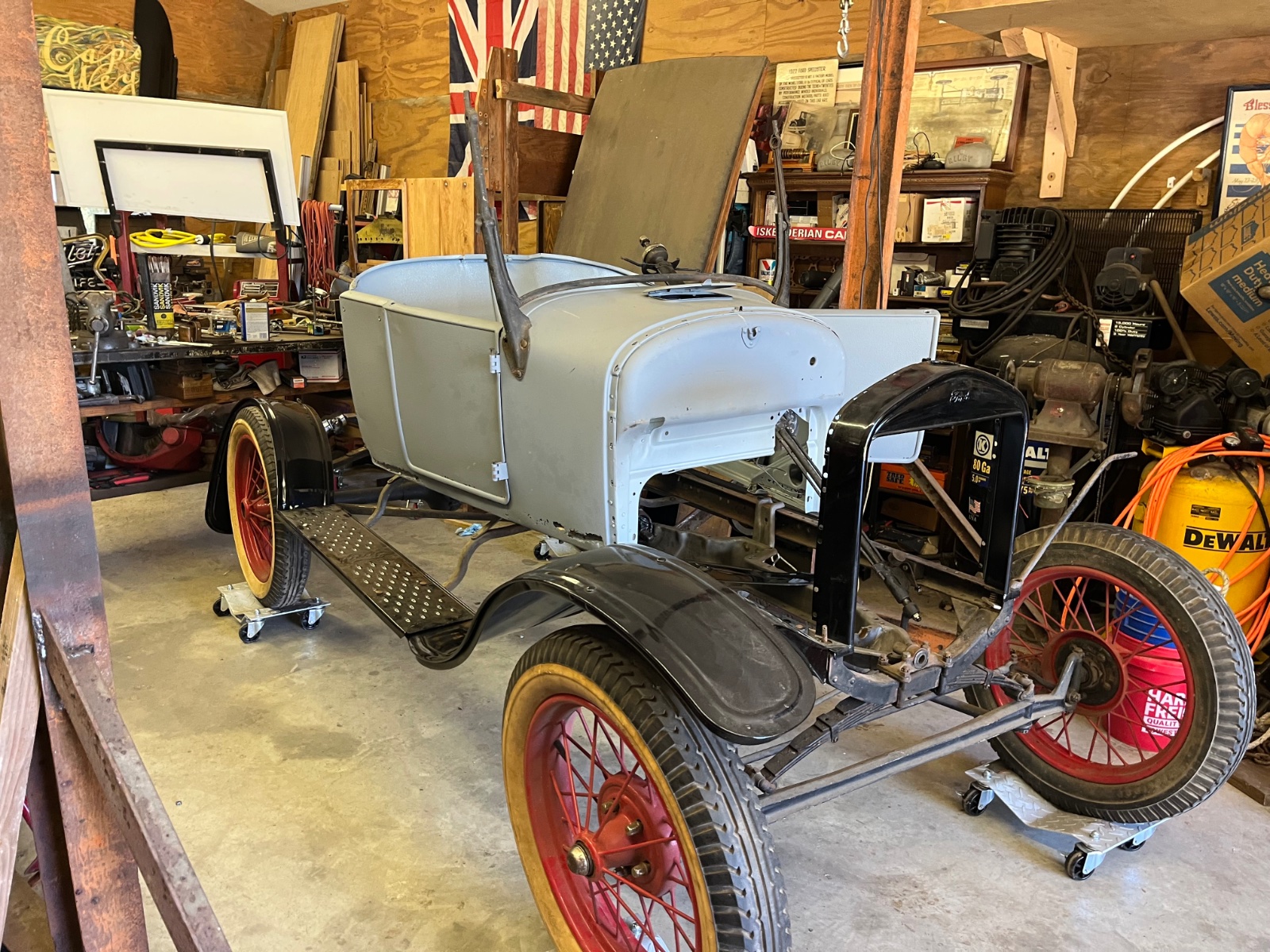

Today we hung the front fenders on our 27 Sport Touring.
It’s starting to look like a car!

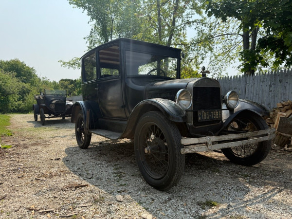

Living in WI i have not done much with my Ts they are all in storage. But 2 of mine celebrate their build days. My 27 turns 99 next week and my 16 turned 110 last week. Neither car has changed much since they were built especially the touring. It's still rock its orignal interior and wheels the engine has never had main or even a valve job done in all its years and still runs very well.

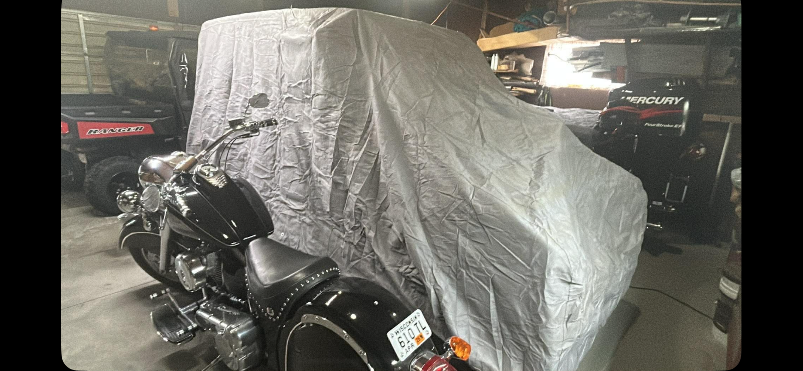

Nothing lately, she’s still taking her winters nap.

Wow that's a nice paint job! Info regarding it?

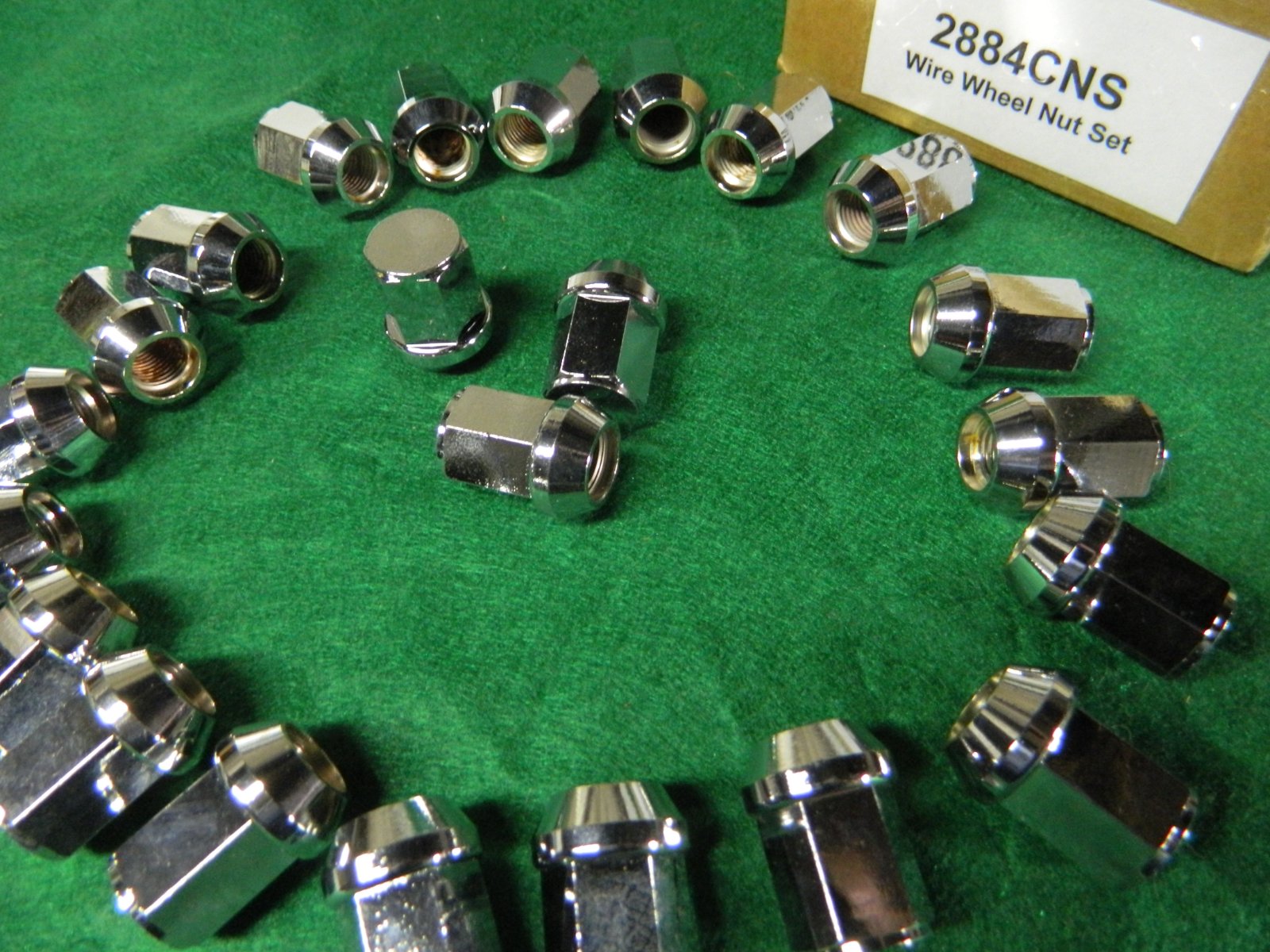

Got some bling for the old feller, another week of this heat wave and it might be warm enough in my building to put them to use. Chaffin's does really nice work, My thanks to them. Jim

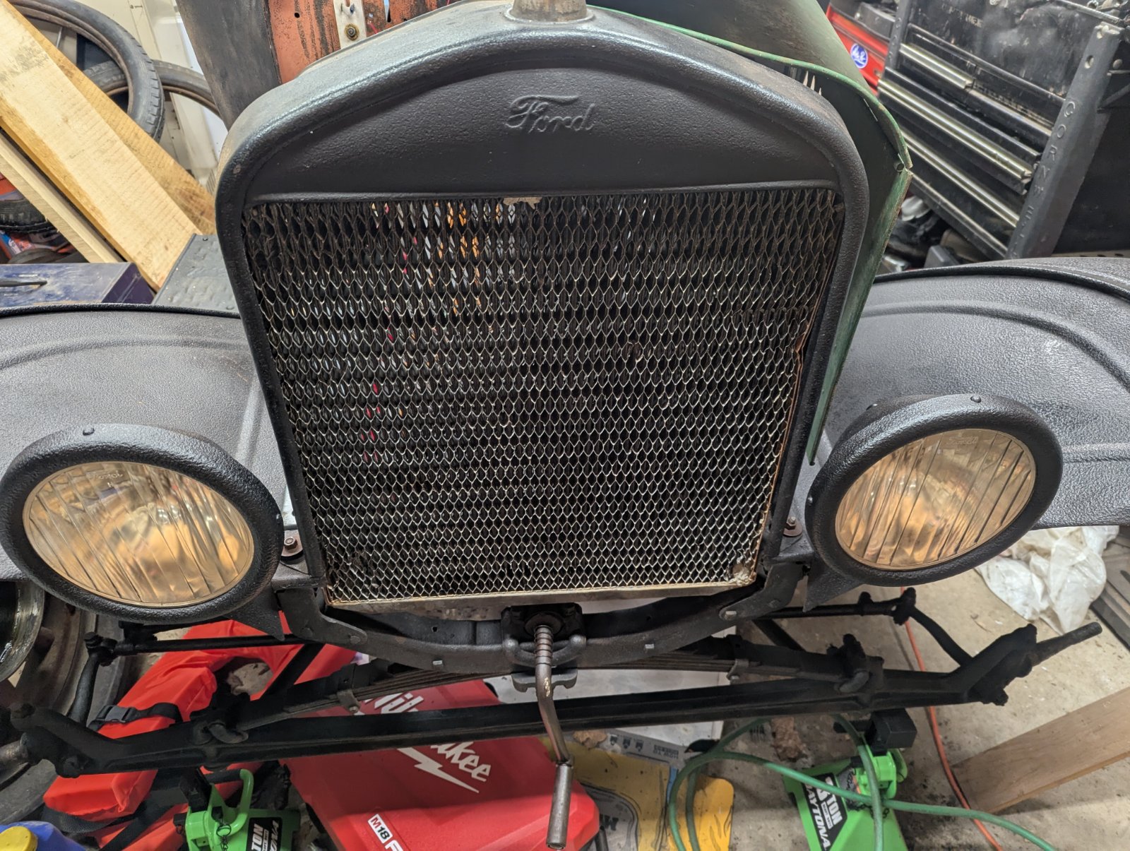

Rebuilt the $10 headlights and gave them a lick of paint.

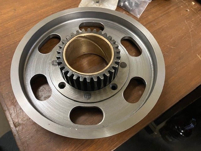

Post by TMiller6 » Sat Feb 21, 2026 1:08 pm

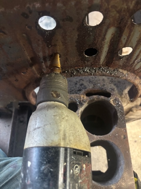

I was able to salvage my four dip pan that came to me with bolted on repair ears. I had a rusted out three dip pan that had the correct three rivet ears and I used a frame checked for square to align everything before tack welding them in place so I could remove the bolts and rivet and braze.
While inside my engine I took a better look at my drums. The reverse had a hairline crack across one of the webs and my low speed had rivet marks and other wear on the OD. I ordered three drums from Dave Nolting and used a centerdrill to remove the old riviets and my press to reset the rivets. I am delighted these quality replacements are available versus salvaging old drums.
