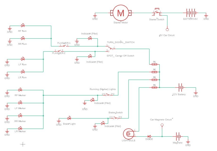

What I do on my cars is to leave the stock 6 volt system intact and add a small 12Volt computer battery under the seat.
Something like this one but there are many, many options out there.
https://www.tractorsupply.com/tsc/produ ... ls-2273564
Add a little fuse panel for charging in and power circuits out.
If someone is interested I could draw it up the circuit, currently the design is only in my cars and my head.
I install all 12 volt LED lights for brakes, turn signals, side marker lights, running lights etc so the maximum load is very low and can run for a very long time without charging.

I thought about it and decided to draw up how I wire LED lights for my car.
It is a totally custom made out of parts.
The fuse block uses glass fuses and is brass from a marine supply store.
I make a control panel with the switches and indicator lights.
I mount the control panel in the middle so the driver and passenger can see and work the controls.
Mike

It was brought to my attention that when I drew my wiring diagram I made an error, thank you Michael.
After 20 years of using other programs work closed and this was my first ever use of the Fusion360 schematic program.
Things in life change and we have to learn new tricks sometimes.
I corrected and edited my previous post.
Please replace any versions that were saved to be more accurate.
I try to be as accurate and clear as possible in my posts but am not perfect.
The forum is used as a reference and I prefer it to be as good as possible.
If (when) I make an error in the future please bring it to my attention so I can correct it.
Mike

And Jeff,
You forgot that the starter bendix spring is also a very, very, bad inductor.
It would be interesting to see how many zeros are in that value of Henries.
It will have a a very, very, small reluctance.
You are 100% correct about the fact that it only makes some people feel better with no real results.
I agree that even converting a starter to 12 volts is a band aid and should be done only for special reasons.

Using a smaller than standard battery can limit total available current to the starter, but that will affect cranking current more than the initial engagement current, and I would expect an undersized battery not to last very long in a car that is started often, since the small battery will be overloaded during cranking. Starters operated with weak or undersized batteries will not last as they should and they will not crank the engine as they should, especially under demanding conditions. I believe it would be less expensive and more effective to operate the starter and generator on 6 volts (nominal) as they were designed to be, with a full capacity 6 volt battery, and use a 6 to 12 volt converter for any modern low current devices that need 12 volts, such as a distributor, LED lights, and any kind of modern electronics.
- Posts: 8640
Re: Power reduction at the starter
Putting an inductor (or resistor) of sufficient capacity to buffer the starter engagement in series with the starter would probably cause too much current drop once the starter was engaged and cranking the engine.

Absolutely right! You can get a 6 to 12 volt converter for less than $20 that will supply 3 or 4 amps; more than enough to charge a phone or run some LED lights. The converters are very compact; smaller than a pack of cigarettes.
My T is still 6 volts, but i have a converter hidden under the dash that supplies 12 volts to my E-Timer. It works great.
