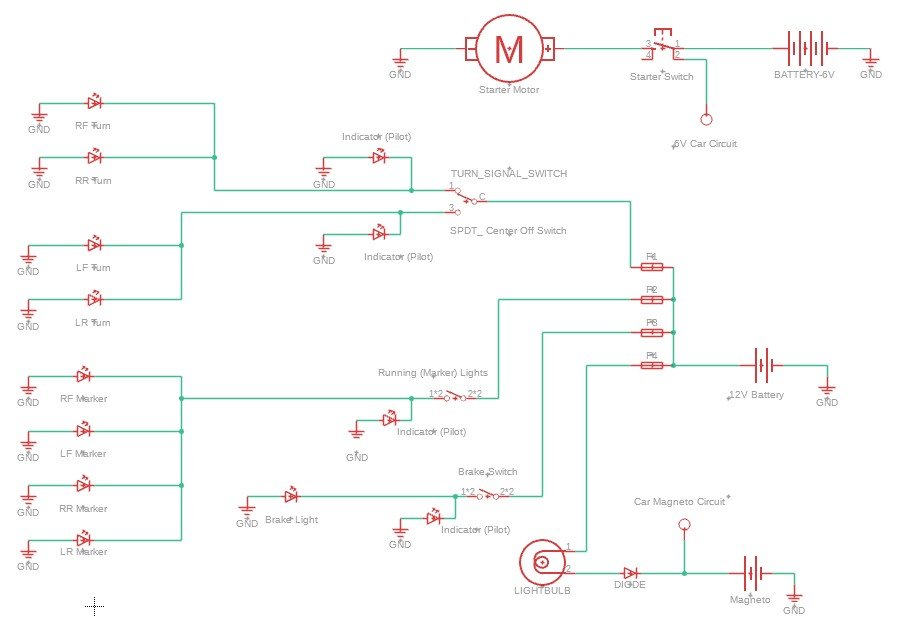

Turn Signals and Extra Lights:
It is easier to get 12 volt lights but there are 6 volt ones out there.
The last "problem" area was good 6 volt headlight bulbs.
Recently there have been some good ones finally appearing on the market.
What I do on my cars is to leave the stock 6 volt system intact and add a small 12Volt computer battery under the seat.
Something like this one but there are many, many options out there.
https://www.tractorsupply.com/tsc/produ ... ls-2273564
Add a little fuse panel for charging in and power circuits out.
If someone is interested I could draw it up the circuit, currently the design is only in my cars and my head.
I install all 12 volt LED lights for brakes, turn signals, side marker lights, running lights etc so the maximum load is very low and can run for a very long time without charging.
But I charge the battery using the built in magneto to charge the battery.
The magneto charger is described in the MTFCA electrical book
https://www.modeltford.com/item/RM1.aspx
and also described in the following
https://www.mtfca.com/discus/messages/4 ... 1416288062
viewtopic.php?t=24793
With my bulb mounted under the hood and it lighting up when charging I get a really cool nighttime effect.
I look like bright shark gills from the side and it lights up my pedals while running along.
Just a very interesting unexpected side result.
I prefer simple, easy, reliable, and something that I can get parts for when I am away from home on a trip.
When you have a problem with too custom of a part you could get stuck if there is an issue away from home.
That is how I do it, others do it differently.
You have to do what works best for you.
Mike

I thought about it and decided to draw up how I wire LED lights for my car.
It is a totally custom made out of parts.
The fuse block uses glass fuses and is brass from a marine supply store.
I make a control panel with the switches and indicator lights.
I mount the control panel in the middle so the driver and passenger can see and work the controls.
Mike

It was brought to my attention that when I drew my wiring diagram I made an error, thank you Michael.
After 20 years of using other programs work closed and this was my first ever use of the Fusion360 schematic program.
Things in life change and we have to learn new tricks sometimes.
I corrected and edited my previous post.
Please replace any versions that were saved to be more accurate.
I try to be as accurate and clear as possible in my posts but am not perfect.
The forum is used as a reference and I prefer it to be as good as possible.
If (when) I make an error in the future please bring it to my attention so I can correct it.
Mike

Absolutely right! You can get a 6 to 12 volt converter for less than $20 that will supply 3 or 4 amps; more than enough to charge a phone or run some LED lights. The converters are very compact; smaller than a pack of cigarettes.
My T is still 6 volts, but i have a converter hidden under the dash that supplies 12 volts to my E-Timer. It works great.
