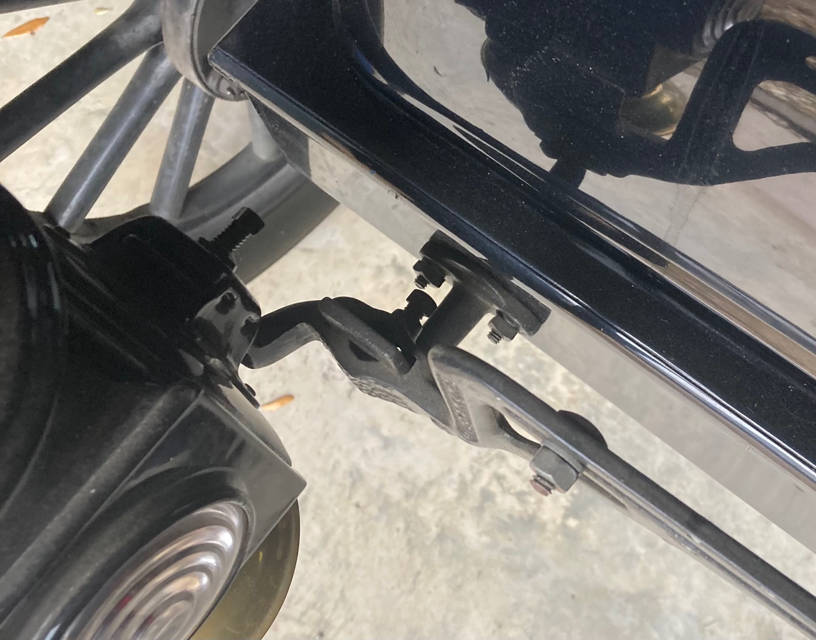

My 14 Runabout has a taillamp bracket with vertical mounting holes but the vendors show them with horizontal holes. Which is correct? Thanks, Art
Posts: 3016
Last Name: House
Re: 1914 tail lamp bracket
Post by George House » Sat Feb 14, 2026 5:56 pm
This is correct….and don’t go using hex nuts. They’re square

Thank you for the confirmation Larry, but we Need our many vendors. I have a question however. You’ll see in my photo a Neverout accessory bracket was inserted between the Ford taillamp bracket and the Ford taillamp. Does anyone know the license plate procedure 112 years ago when a new Ford was purchased ? Was there a municipal ‘grace period’ in which the new owner was expected to go to ye olde Autozone and procure a license plate bracket ? We’ve seen 1915 Ford tail light/license plate brackets but what was expected the previous year ? ….I’ll now donate the balance of my time to Wayne Shelton..
