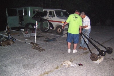

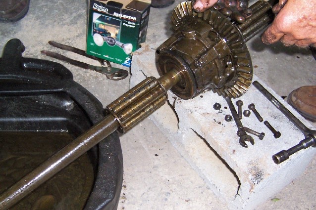

Interesting, that rear wheel hub separated from the mounting plate. Same happened on a mountain tour in NC years ago.
Driver felt drive line skipping, we all thought the rear axle must have lost thrust washer or gear tooth, so out came the rear end.
Took it apart, found nothing. So late in the nite installed the axle back. When fitting the left rear wheel over the axle, did the culprit appear.
The wheel and hub turned, just a bit at a time, jerky like, the plate / hub forging was cracked, jagged like, so it held some, and turn some, but that was what caused the initial skipping....... Something else to check carefully when restoring a wheel hub!
Pulled axle apart found nothing wrong.

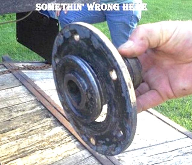

Not the same hub, (picture lifted from another forum post) but this shows what can happen to a worn hub, perhaps starts with a crack that propagates.

Dan, I have seen a couple of hubs welded up to make repairs back in the days. Not something I would do today, but one does as one must in some situations. In the one I mentiond above, the over thick eproduction hubcap was the saviour..
