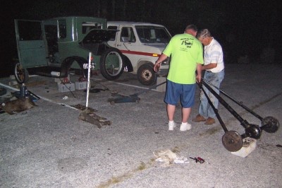

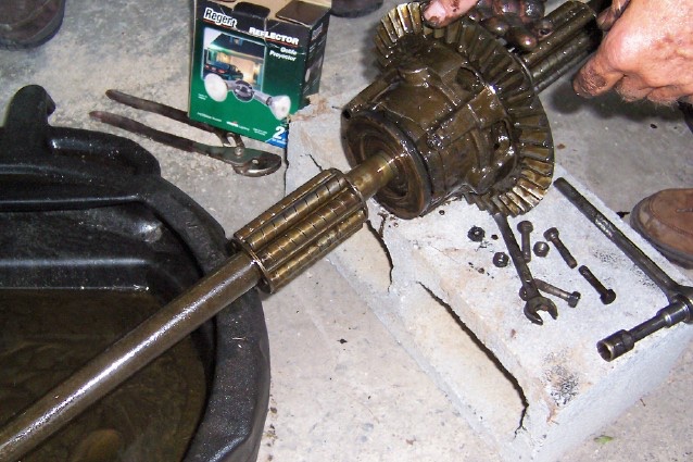

Driver felt drive line skipping, we all thought the rear axle must have lost thrust washer or gear tooth, so out came the rear end.
Took it apart, found nothing. So late in the nite installed the axle back. When fitting the left rear wheel over the axle, did the culprit appear.
The wheel and hub turned, just a bit at a time, jerky like, the plate / hub forging was cracked, jagged like, so it held some, and turn some, but that was what caused the initial skipping....... Something else to check carefully when restoring a wheel hub!
Pulled axle apart found nothing wrong.
Back to the T with the axle, then found the problem when fitting the rear wheel

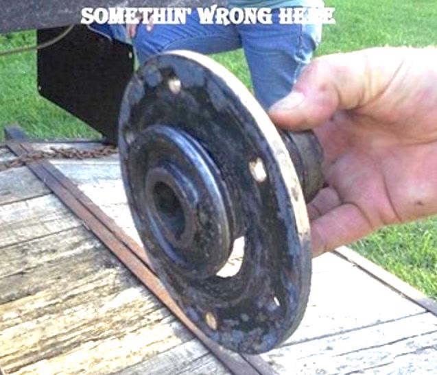

Not the same hub, (picture lifted from another forum post) but this shows what can happen to a worn hub, perhaps starts with a crack that propagates.
