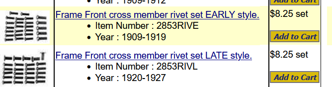

No assumptions :roll: No guess work buy them. What year

Frank, I did purchase the kit from Lang's. My concern was/is that with the crossmember bolted securely in place, the 5/16" x 1" rivets will protrude 11/16" and the 1/4'" x 7/8" rivets will protrude 9/16". That appears to be excessive to get a nice neat result and I'm hoping to not have to experiment too much.

I need to make a corrction from my previous post.I bought individual rivets from Chaffin's and not Lang's kit. Lang's kit may very well have shorter rivets than what Chaffin's lists.
