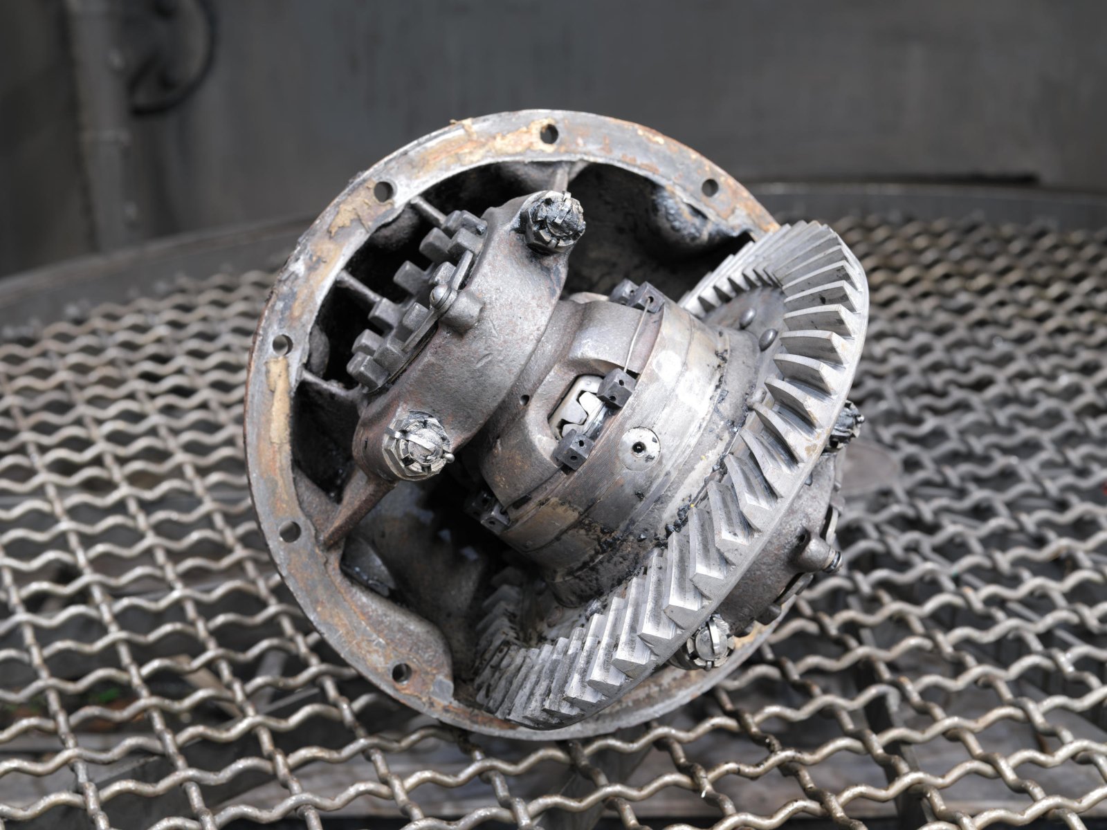

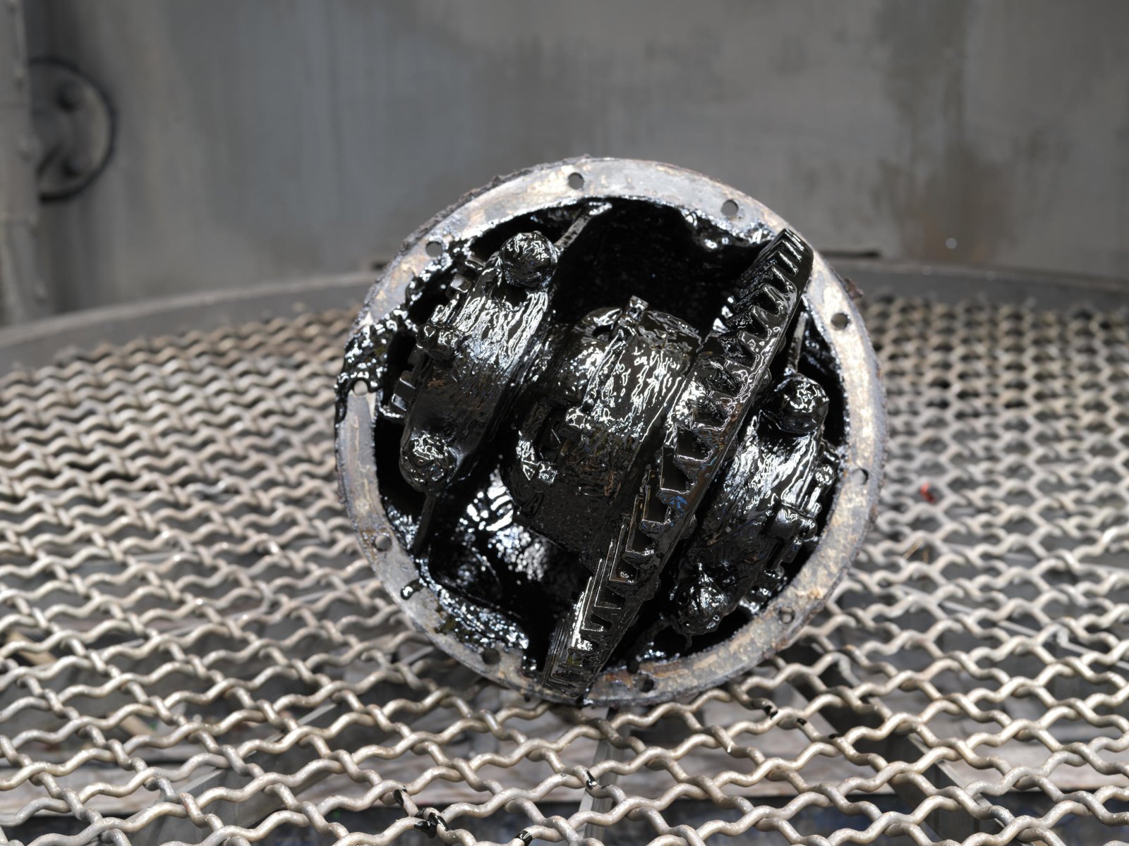

We use a spray type automatic parts washer for cleaning industrial gearboxes and axles. It's 2m x 2m x 2.5m. The product we use with this is a water based alkaline cleaner which gets heated up to 80°C. The attached photos shows a Timken crownwheel/differential off a 1916 Cole V8. For stubborn gaskets and 100 year old grease it still sometimes needs some manual scraping.
We used to have an agitation type parts washer but found the rotating table/spray bar washer works better at cleaning off the type of debris we come across (grease/soil, clumped coal, chicken manure, etc).
We also have a basin style parts washer which we've used with a variety of different products. We currently use this with Simple Green SG13484 Gearbox Cleaner. The best product for the basin styler washer was the Safety-Kleen solvent type cleaner but we moved away from that for health reasons.
