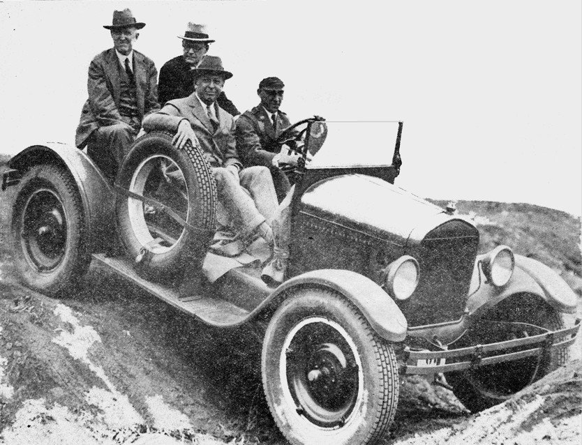

Attached a photo of the Army's version in tests in 1926.

It seems that problems presented here by some were not problems at all. No great modifications were needed to the steering, the disc wheeled balloon tires gave extra height to the vehicleand better ride over rough ground, the disc wheels did not clog with mud easily and no alternative steering box was needed to replace the Ford one. A larger steering wheel and a strengthened drag link was used and it was decided by the Army and Marines that the cheaper 30 by 5" balloon tire was satisfactory so the airplane Balloon tire version was eliminated. As the Army spent several years (1920 to 1926) and ended up with a balloon tired Ford with very capable off road features the system obviously worked.

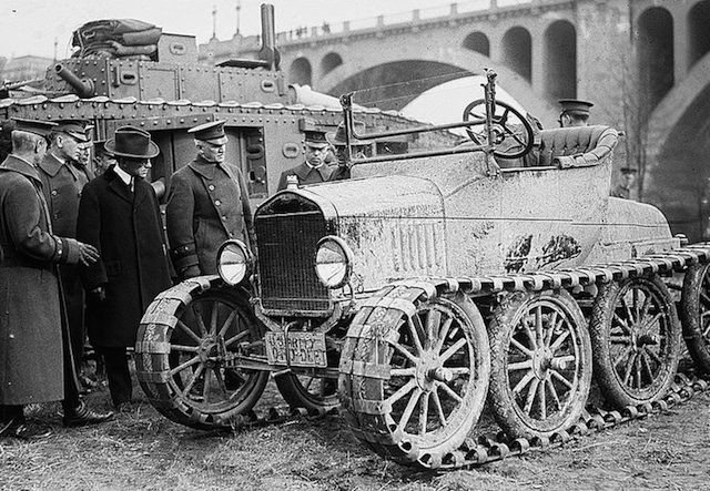

These vehicles were a further experiment after the Chase tracked Ford offered to the Army after the war proved unsuitable. The track design prevented fast speeds and tires were quickly destroyed by the track. At the time materials available to make the tracks were not good enough to handle the forces involved. You have all seen the Chase track Ford at Ford Benning,

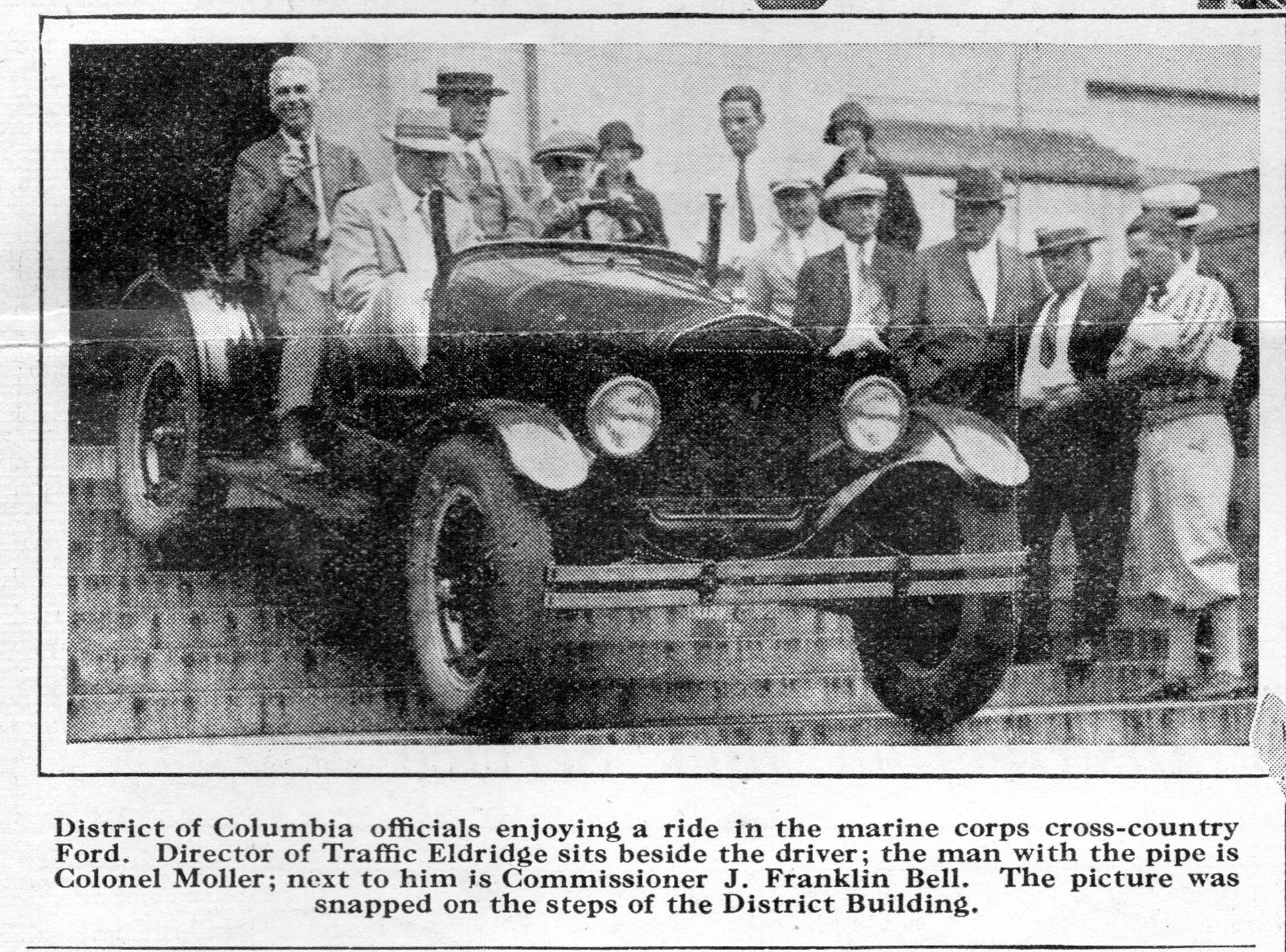

Here is a copy of the Marine version of the cross country balloon equiped vehicle as well as the Chase tracked Ford.
The balloon tires on disc wheels have a demountable rim with tire mounted on the side of the vehicles which would make it easier to change a flat tire if required. No one was trying to mount balloon tire on rims for high pressure tires, the balloon tire had their own disc ( and wire wheels) made for them, thats what the Buffalo wheels were advertising - a new better softer riding wheel for the Ford and other makes.
