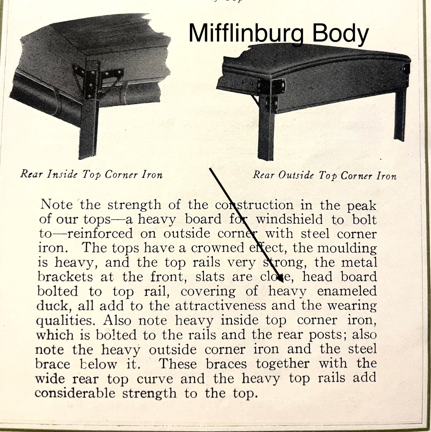

Catalog page details top construction.

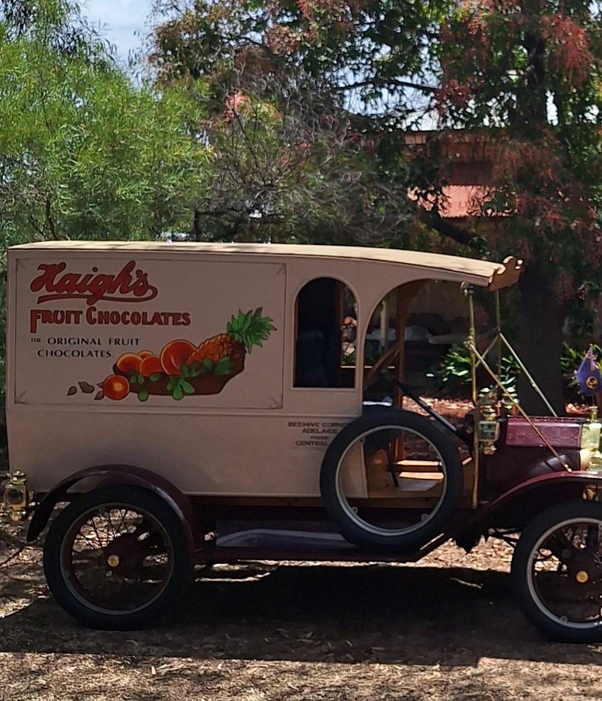

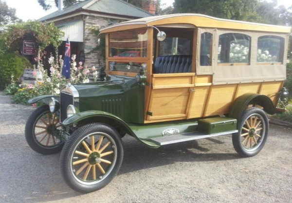

Most of our Colonial built car bodies had light coloured canvas tops rather than black vinyl type covering. I used canvas over cedar laths on both my 1912 van and 19 17 shooting brake. Modern canvas fabric contains a percentage of polyester fibre in the yarn which makes it longer lasting, stronger and less liable to shrinkage. The one one my van is 33 years old now and is still as god as the day it was fitted.
My motor trimmer advised against using foam as an underlayer because some types decay under hot conditions. He put me onto the dacron sheeting used by quilters. It is stable, does not shrink, is not affected by moisture and is available in multiple widths. I used 1/4" thick stuff so the top does not look padded out on the sides where it is finished.
- Posts: 7298
Re: Roof Covering
Have no idea where the photos other than the van came from!
Here is the shooting brake.
The laths are spaced with equal width gaps between them. A natural coloured burlap goes over them, stapled at the edges. The dacron is llightly glued at the edges to cover the burlap, and was trimmed with a 1/4" lap over the sides. The canvas went on next and is finished with an aluminium C molding. There is enough give in the canvas to be able to pull it tight, even over the valley behind the curved front
Hope this helps.
Allan from down under
Hope this helps.
