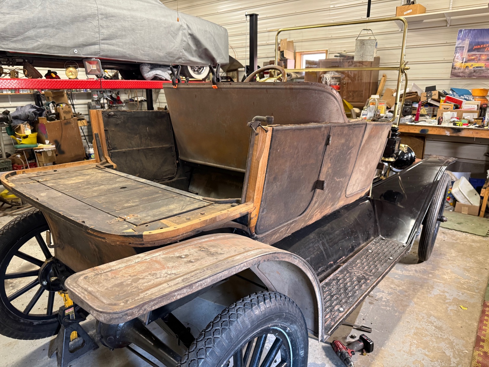

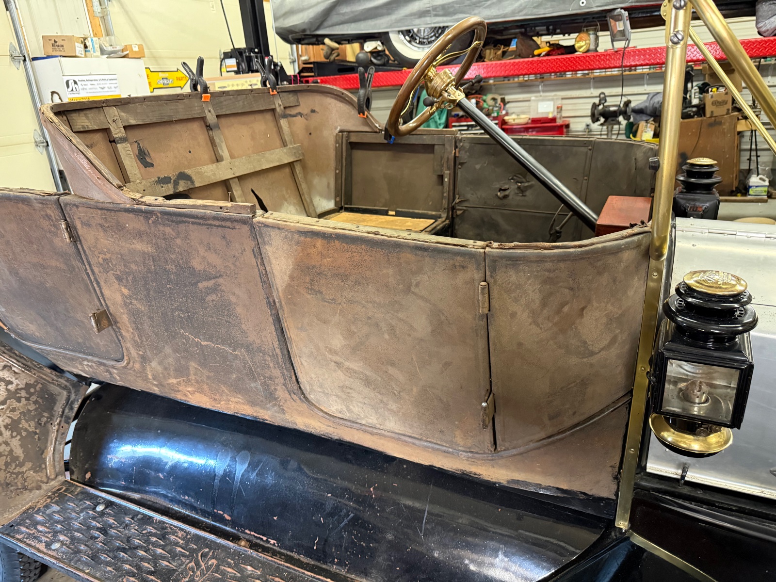

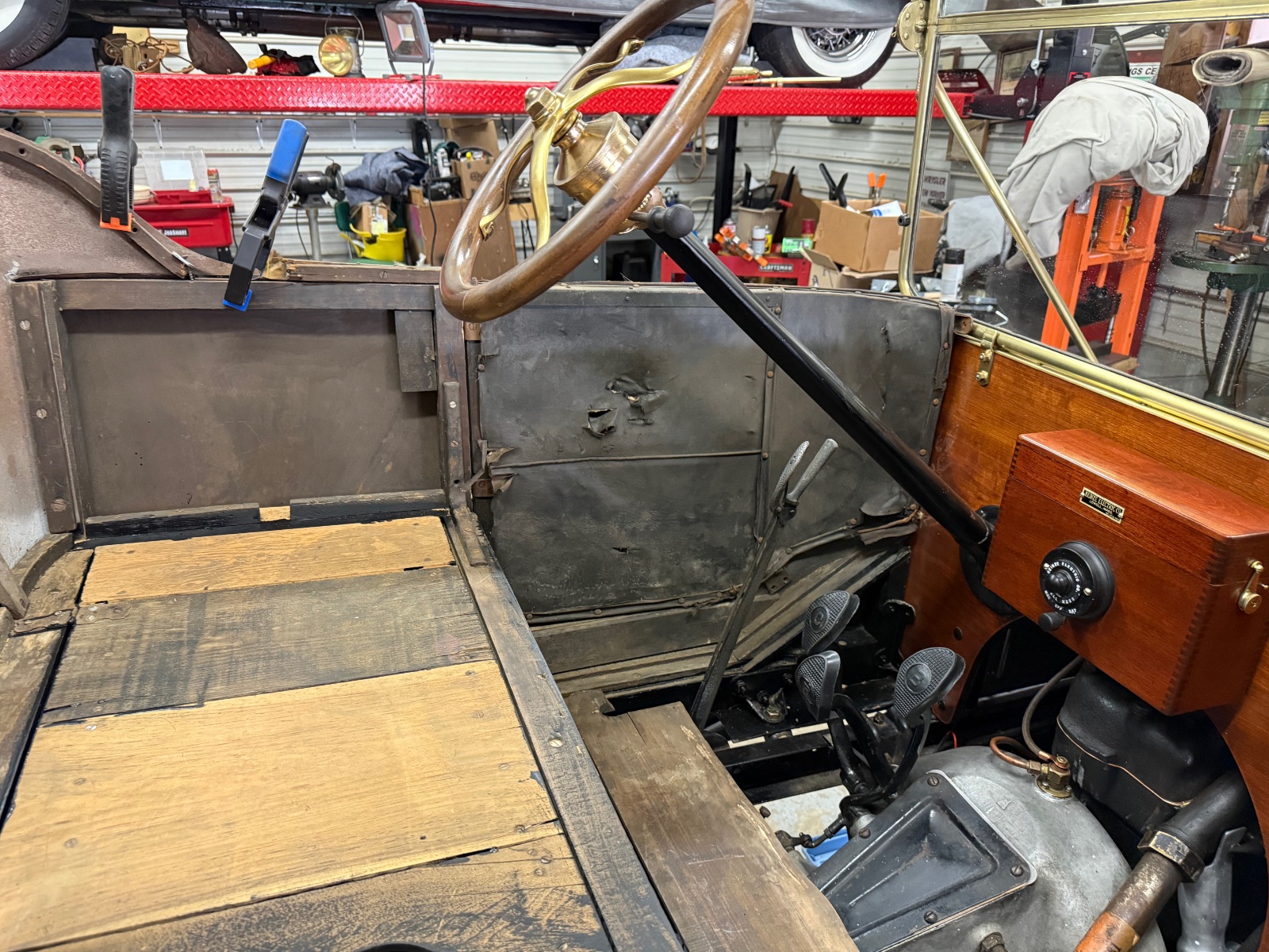

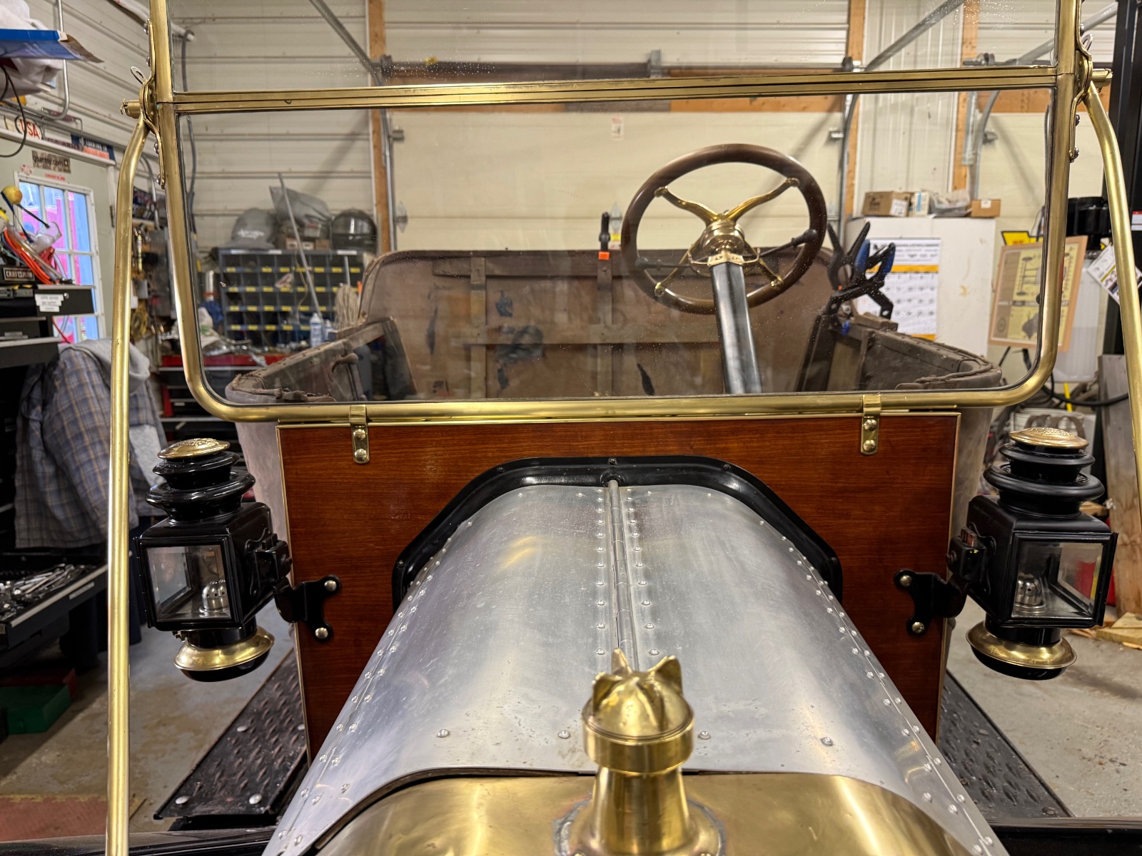

i set the body on the frame the other night and used 1/2 inch bolts to secure to the 6 frame mounts and everything seemed to line up but I see the front fourdoors seem to be above the firewall so I'm guessing the firewall was not raised up to where it should be. My question is am i overlooking something as when i picked up the car the firewall was on and I assumed they had it where it belongs. Should I measure and raise the dash or is it going to be a pain as the steering is attached and I’ll shave to adjust the hood support on the firewall. I am also missing the fender to splash apron braces so I need to figure out what they look like. Any other suggestions on things I should be doing to get the body and doors all Alined. I do have a retired buddy that used to do body work his whole career and is going to help me out with the rear seat sheet metal and any alignment then paint the car. I have 4 of the top irons and think the front ones are not correct as I need to mount them and then clean up the top irons and line all this up. This is a labor of love for this early Brass era T and i want it to look nice but not a show car.

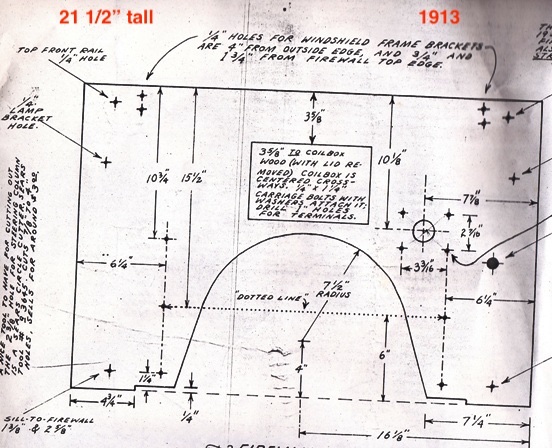

May be prudent to recheck the dash height for correct 1912. The sketch is for a 1913 dash, but the '12 should be 1 1/2" taller.......as mentioned if you read all the way thru this older post on '12 dash.

It appears to be a "slab-side" body, so it requires the later/taller firewall. I can't really tell from your photos, but it looks like you may have the earlier 1912 and earlier style (shorter) firewall.
You will also likely run into some fitting issues with the windshield.

Once the firewall is sorted out, fitting the hood former comes next. Forget measurements/drawings and heights and fit the radiator in its final resting place first. Then put the hood and all its cushion pieces on and move the hood support around until you have it in the position which gives you the best fit for the hood. It is not uncommon for the former to be offset somewhat, and a little higher/lower than plans suggest it should be, but it is rarely noticed as you can't see both sides of the car at once.
You can get a better fit by off setting a little the hole in the former through which the centre hinge rod fits. It is a good time to bronze weld a sleeve to the back side of the former to spread the wear surface on the hood rod rather than rely on just the thickness of the sheet metal. From memory, I used a 3/8" hex nut with the thread drilled out for the sleeve. That soft aluminium hood will appreciate your efforts.

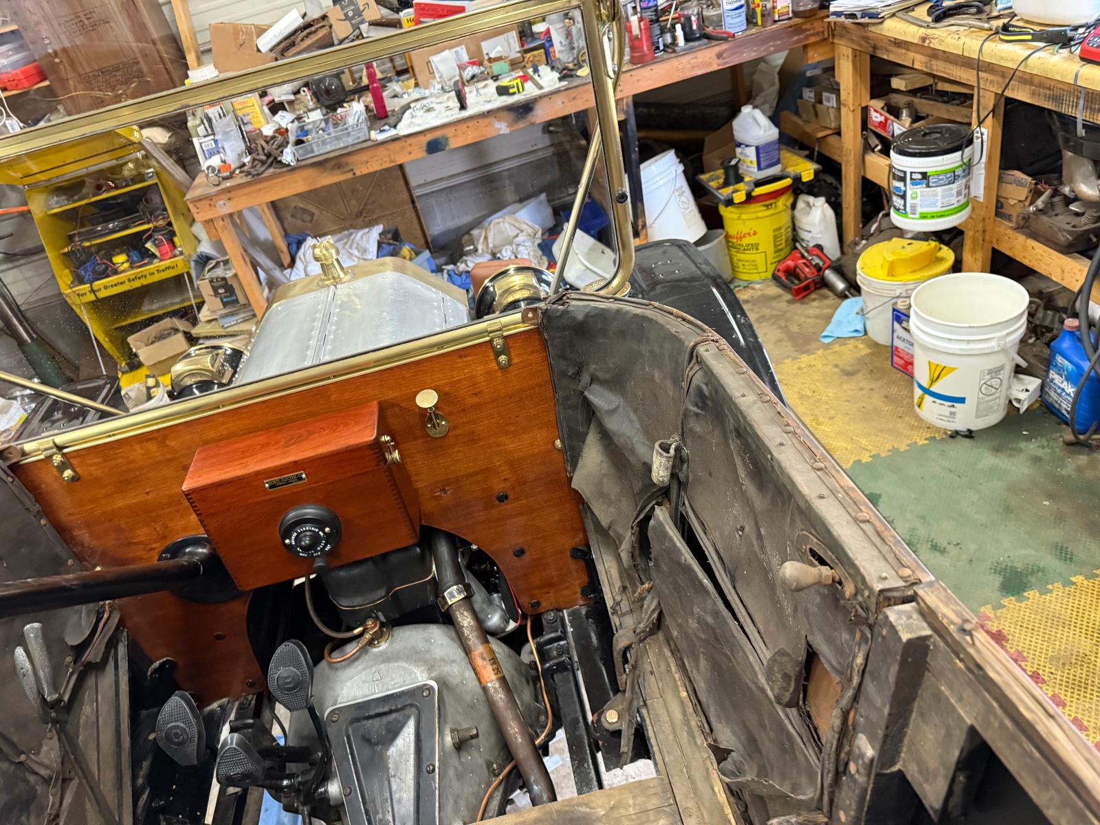

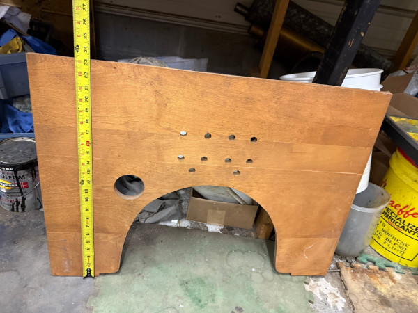

Thanks for the information as it has helped me , I did grab the extra Dash they had at the estate when I picked up the car and anything related to it. The extra dash is the correct height (23 in) and seeing that most of the holes are drilled all ready I may use the one on the car as a template but ill drill the body mount holes first as other than the height it seems to match up. When im all done I may keep the old dash as I put some effort into cleaning and staining it. If any other advice or photos of any wood or top iron brackets would be very helpful. I love the challange of this car but it’s 2 steps forward and 1 step back. ( dash was done and looks nice but too short, :lol:

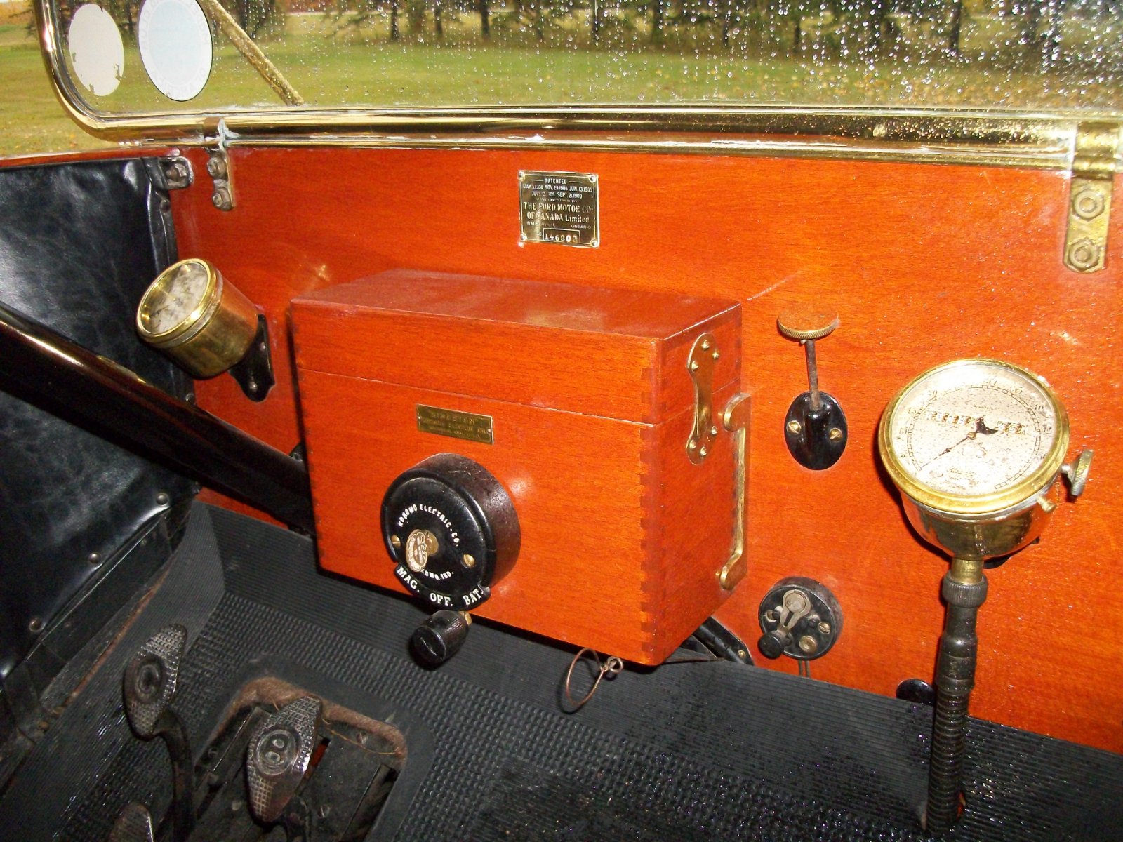

This is my 12 you are definitely short from coil box to windshield
