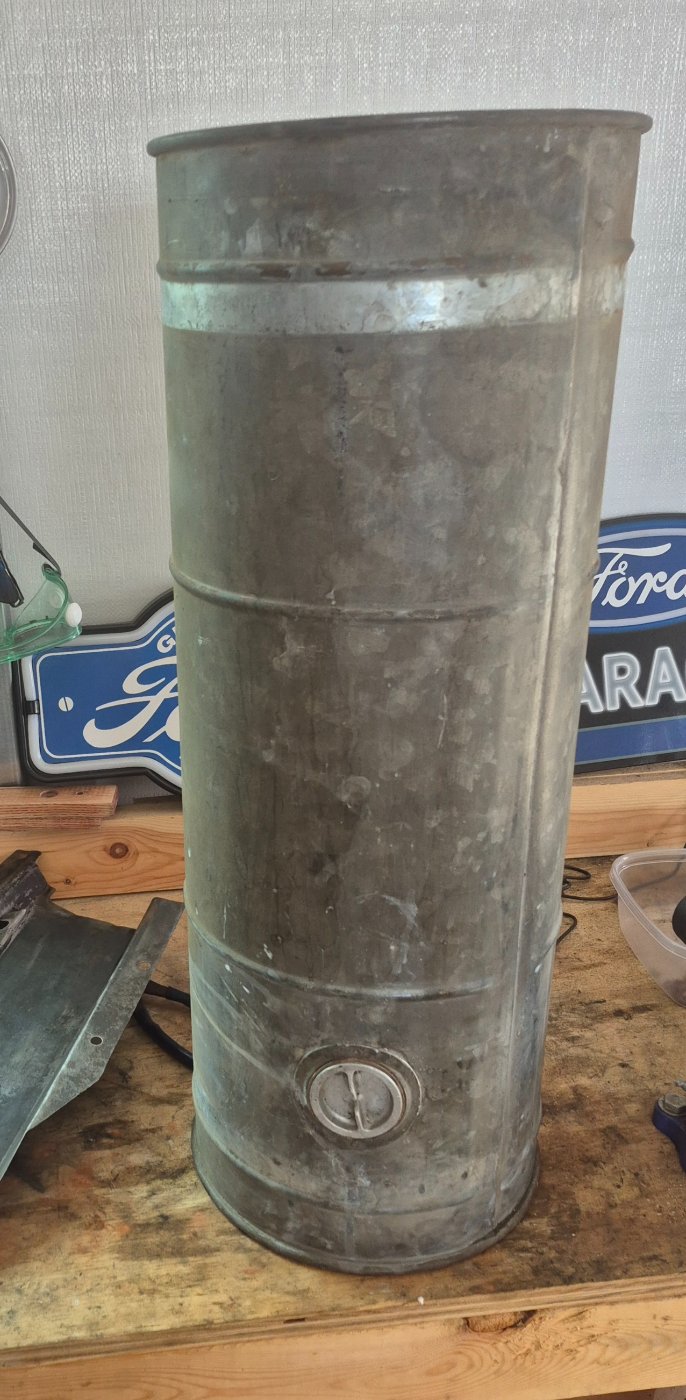

The 1911 T that I restored came with a Holley H1 carburetor, which Corey Walker refurbished for me. It's a great running carburetor, but it has an elbow that doesn't allow the installation of the usual shutoff elbow that is often installed on later carburetors as a safety feature.
After 3 1/2 years of crawling under the car to turn the fuel on and off at the sediment bowl, I found a small inline brass shutoff valve that I installed yesterday. FINALLY, no more crawling under the car to turn the fuel on and off!

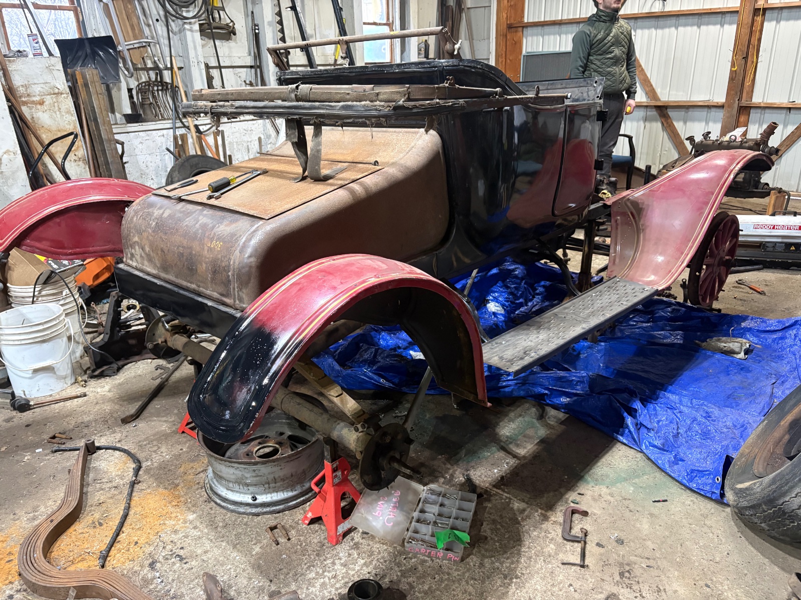

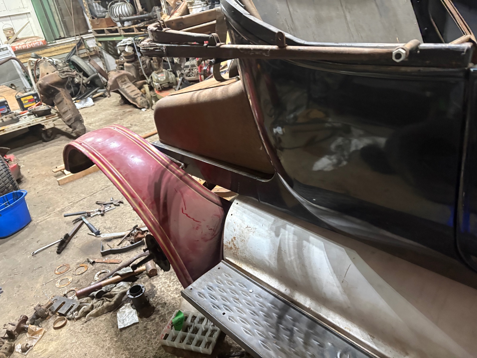

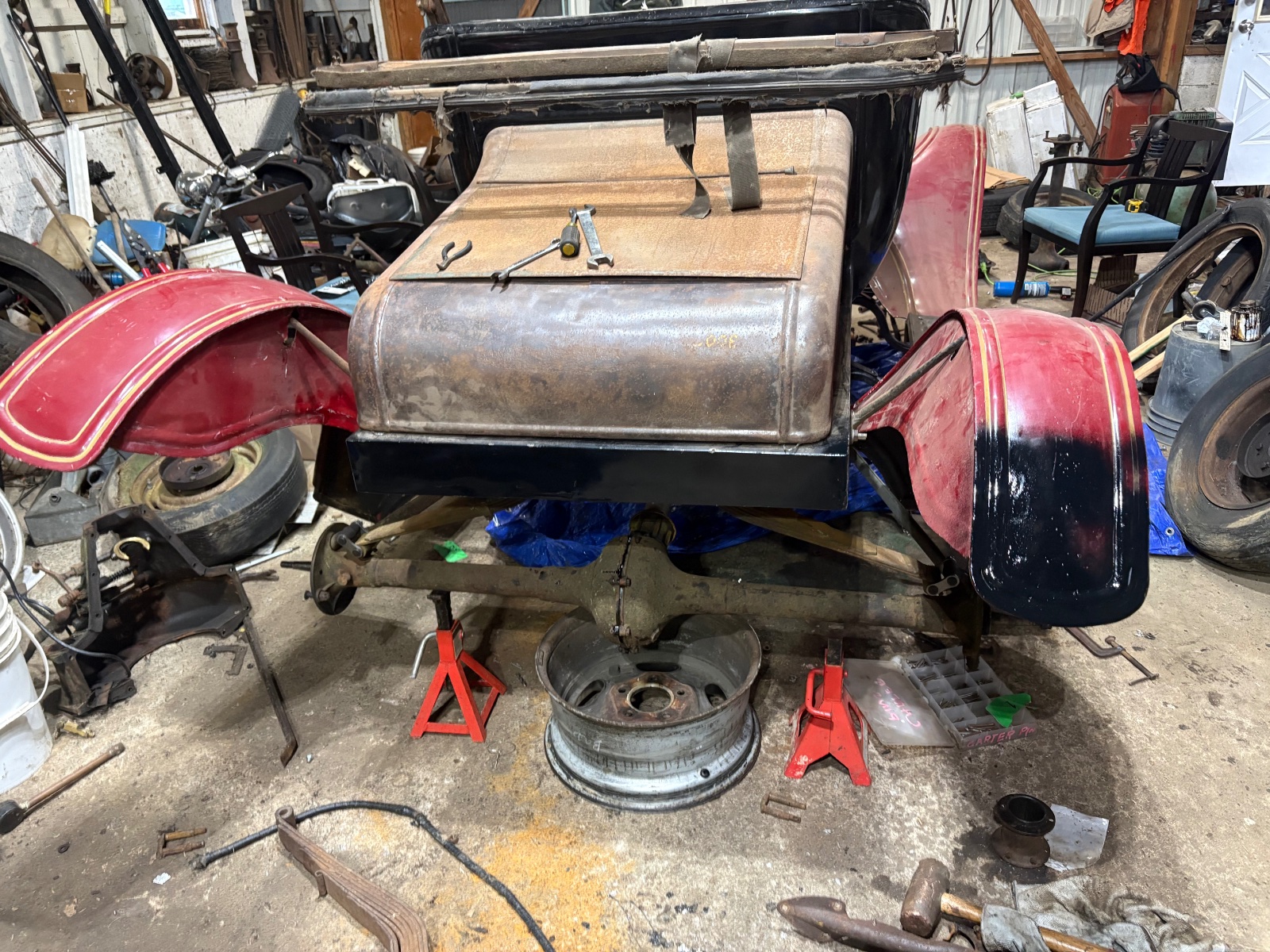

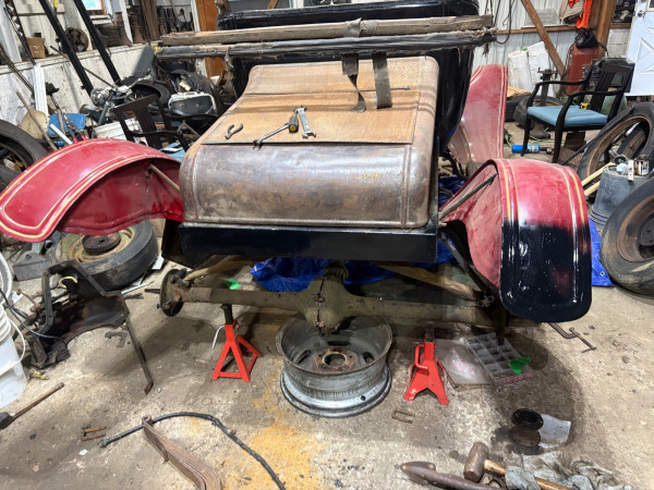

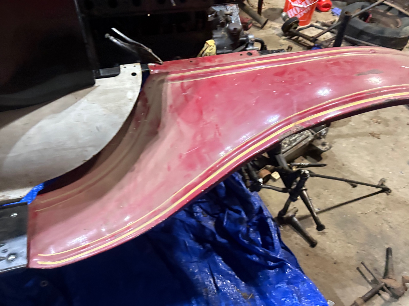

Giving an old "Gow Job" a makeover. Its going to take awhile for an nice speedster look.
I bought this and numerous good parts from an estate. Don't know if it was intentional but beat up fenders, spot welded to the fender arms, mixed up nuts & bolts, rusted parts were used. Block is a 1926. Its next in line for a look see what I got. Rear tapered leaf spring will be replaced.
I removed my friend from the original image with an AI App on the internet https://cleanup.pictures/

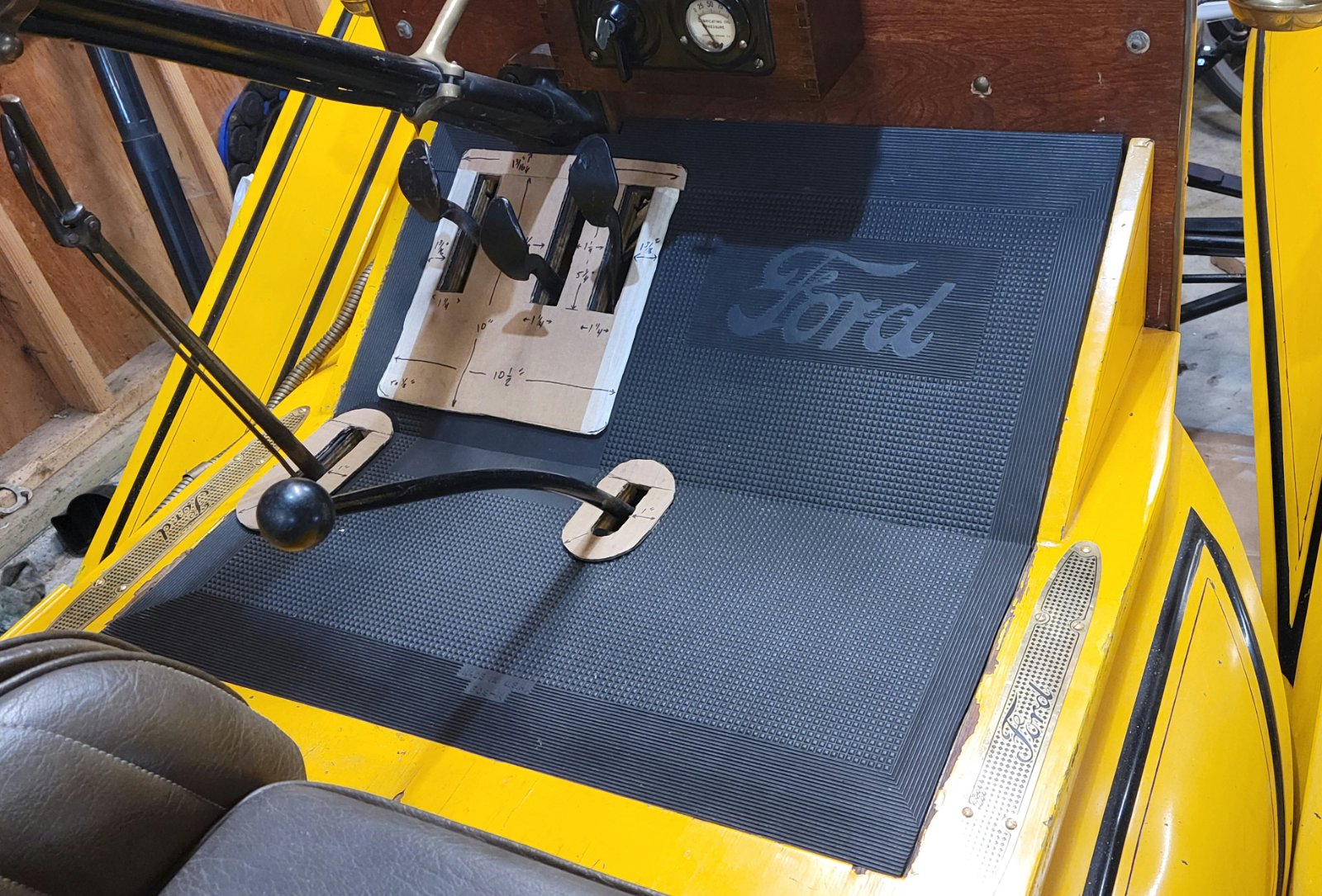

Post by KWTownsend » Mon Mar 23, 2026 6:02 pm
Worked on the floor boards of my wife's speedster.
The cardboard templates show the design of the trim plates a buddy of mine is making.

Re: What have you done with your T in March?

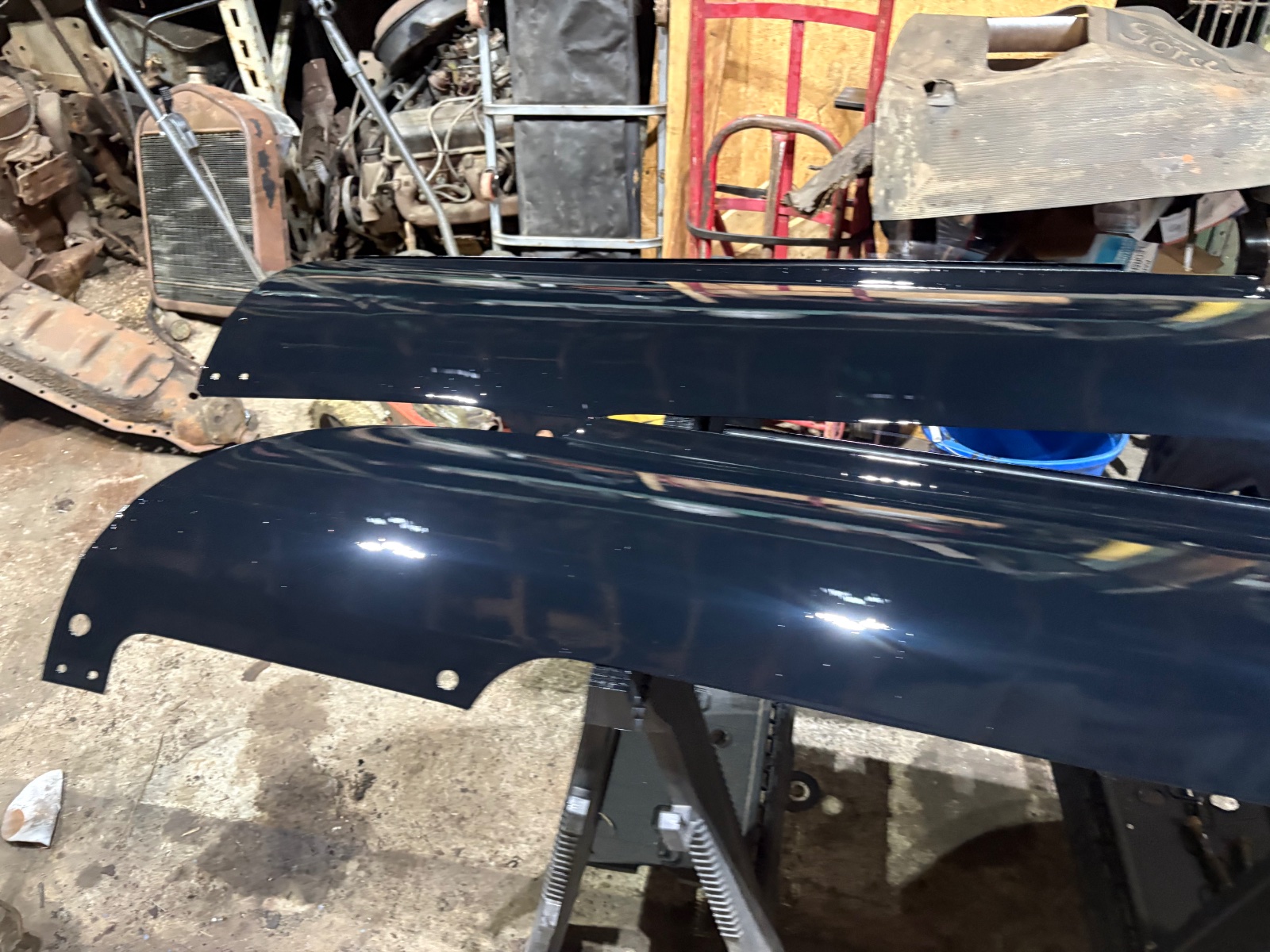

Post by Oldrusty26 » Wed Mar 25, 2026 12:13 pm
Still mocking up the roadster !!

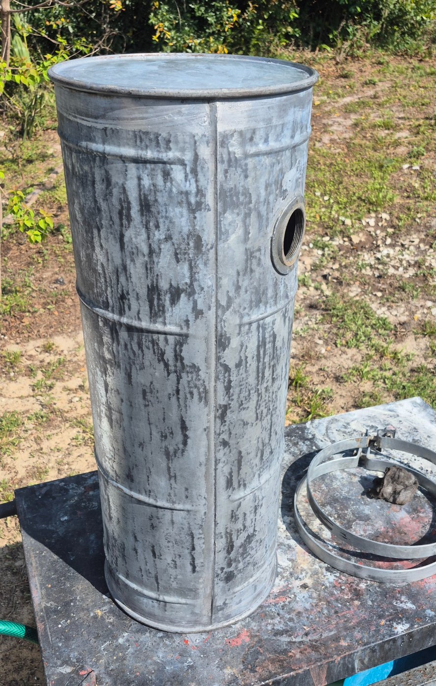

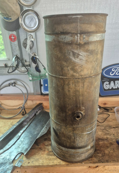

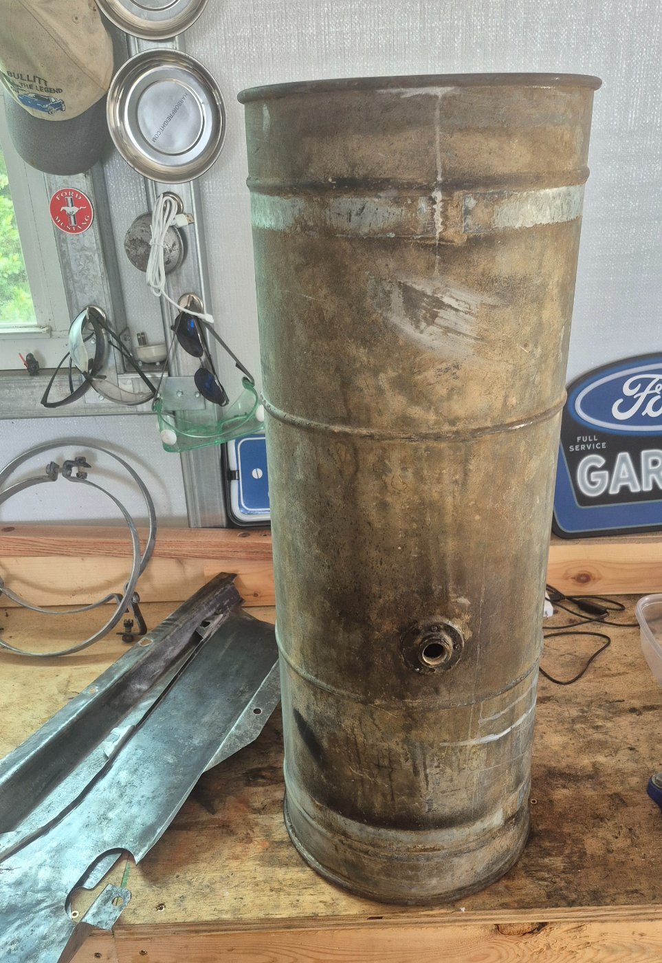

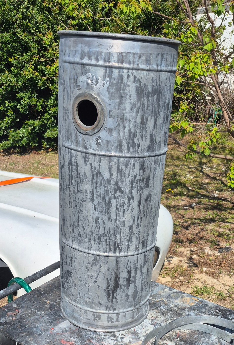

Post by Daisy Mae » Wed Mar 25, 2026 4:46 pm
Cleaned up the fuel tank on '14 Daisy Mae.
Great shape, no rust inside/out.
The inside had only a very slight layer of greenish sludge/lacquer on the bottom. Dumped some vinegar and some nuts & bolts and spun it around some, followed with some water/baking soda and an acetone dry, and she's spotless.
Outside I tackled with some Comet and some 0000 steel wool.
Not too bad for an old tank.
