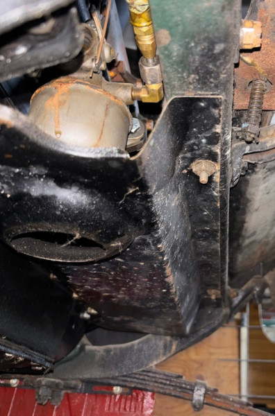

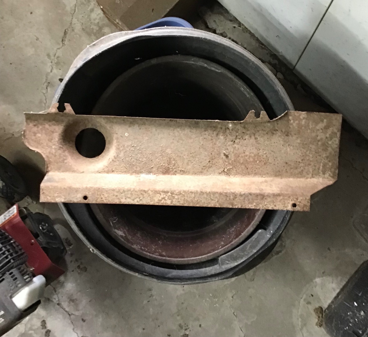

I don’t recall ever seeing much discussion on engine splash pans on these boards over the years. Just curious whether anyone has researched them, and if there is a chronology that attends changes in their form.
Question arises from an original condition ‘23 centerdoor with this pan, in 64 years of “T-ing” I have never seen one like this.

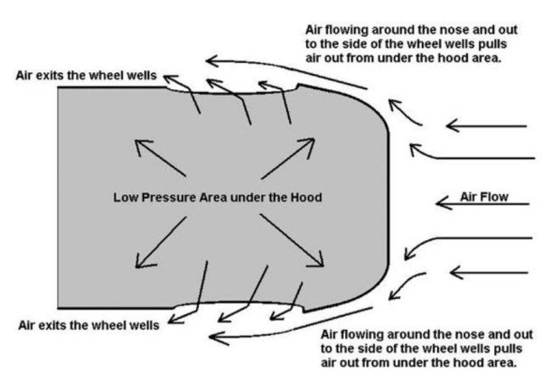

The air flow through the radiator and out through the louvers. Early hoods had no louvers, then more were added with he 1926-27 having the most

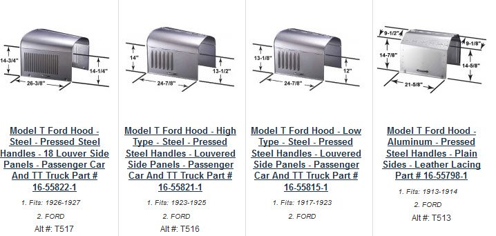

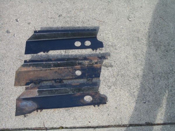

Looking at some earlier posts about engine splash pans I found a photo of 3 of different designs. The discussions had come to the conclusion that there wasn’t a clear timeline of the differences that occurred. There is one that has the oval bowl shaped into it like in the photo that’s posted that’s close but the bowl may be more shallow.

Louvers were added to provide extra cooling - Ford progressed from none to 6 to18 on the 1926-27 to enhance cooling. It was obvious that it reduced heat buid-up in the engine bay. The leader in airflow/aerodynamics back in the day was Paul Jaray. His aerodynamic designs revolutionized engine cooling by integrating it into the vehicle's airflow, a necessity for his high-speed, streamlined "teardrop" cars. https://www.neroeditions.com/architecture-of-speed/

Re: Engine splash pans

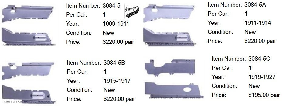

The bottom one looks like a late 24 - 26
- Posts: 5269
The hole lines up to the carb drain. The top one is a fitz both ( nh or vaporizer ) repop? or factory. The second one is for a vaporizer Only?
There were a few variations. If I recall correctly there is an early version(14ish)) that has an oval indented pan under the carb with a small drain hole. & then theres the early (13ish) transmission pans (not commonly seen as many got pitched)
It would be nice to show all the variations tied to correct years.

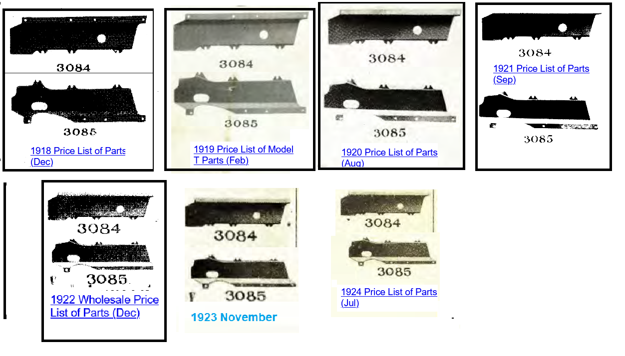

- Posts: 6590

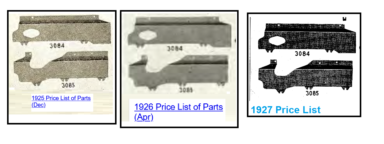

Differences
Note dates for Engine Pan in Ford parts manual (December 1925)

The vendor provided pictures are not complete, but instructive anyway. The vaporizer pan is not shown.
There would be a pan with the drain hole more forward OR a second forward hole.

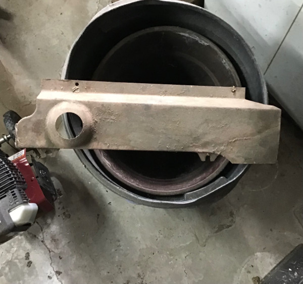

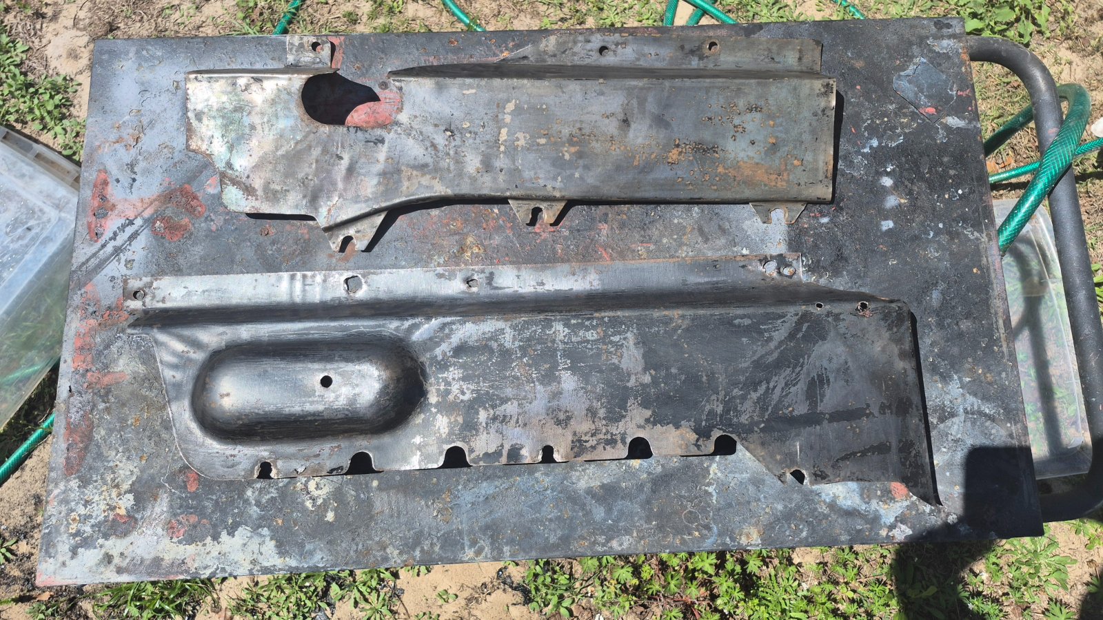

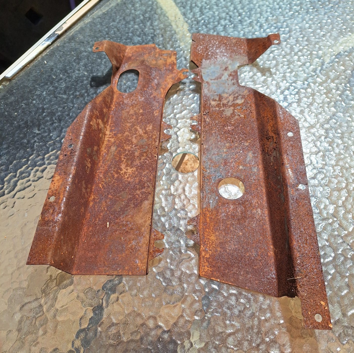

Here’s the carburetor side engine pan I’ve had since the 70’s when I bought a garage full of T parts. This pan has the round bowl pressed into it whereas the reproduction ones from Lang’s don’t and the one from a Ford parts book isn’t round or has the oval. The repos doesn’t have the round bowl pressed in the because of the cost of the press die and etc. I’m assuming.
This looks like the on that R. Bingham posted to begin with.
This seems to at least in a way from the post I found that even back then there wasn’t a a concise shape exactly for the different year T’s. I guess sheet metal makers that Ford used made the parts a little different like the body makers did. They were real close but not quite.

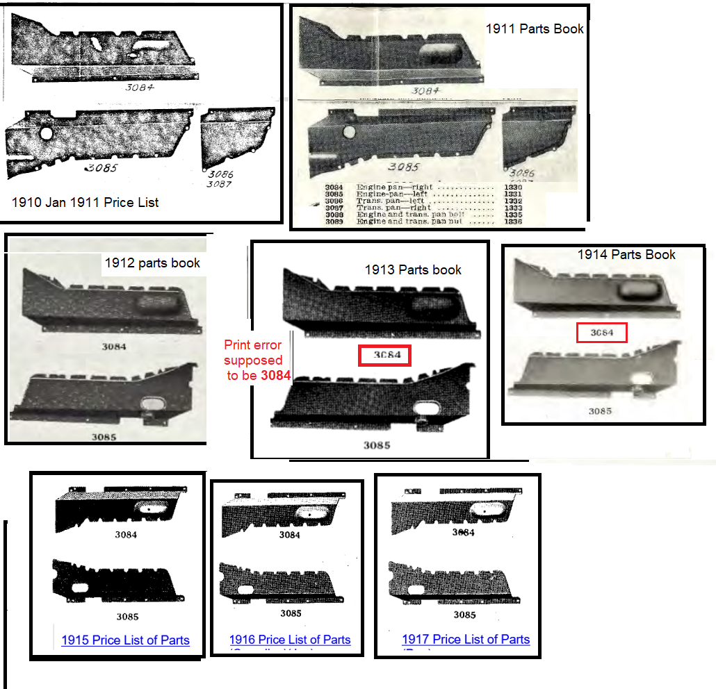

- Posts: 6590

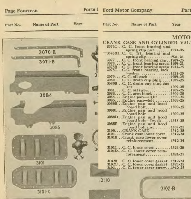

Curiosity got me to browse through all the parts books to see differences in engine pans. It appears that there are 5 variations.
Not sure how accurate parts books are
1. 1910 - 1911
2. 1912 - 1914
3. 1915 - 1917 --
4. 1918 - 1924 --
5. 1925 - 1927
1. 1910 - 1911
2. 1912 - 1914
3. 1915 - 1917 --
4. 1918 - 1924 --
5. 1925 - 1927
Frank, thank you much for posting those parts book pages. Interesting to note that the earlier pans indicate a capture point for every bolt on the crank-case - then trimmed to three, and then two only on the manifold side ! Also noted, the parts listings don’t seem to show the style with the formed “bowl” below the carburetor.

The pan with the bowl could just be a variation that was used from an outside supplier and not shown in the parts catalog like the hood sills that used the raised rolled over hole for the light wiring used around 1920.
Timely topic, given I'm currently in the process of prepping the pans off my '14 to be repainted...
