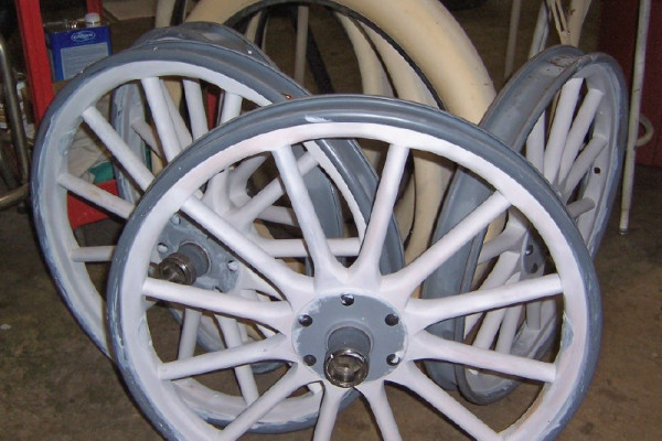

[image][/image]I made a tree with cut off ends of rear axle shafts, and hooks to mount a pair of front spindles. I drove it into the ground behind the shop, and painted the wheels on a sunny day. I spun them slowly by hand while spraying. I'll try to post a picture.

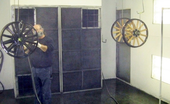

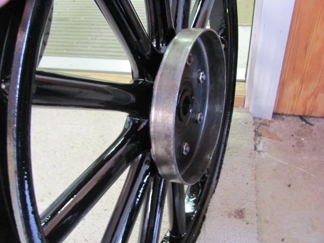

Will be more successful if you spray paint vertical and rotate the wheel as you do.
Photo is from the forum on this subject, pro method.
For home garage work, placed a piece of PVC tubing clamped in the legs of a ladder, to rotate the wheel front hubs, used steel rod for the rear hubs.
Have also primed with brush and then sanded each spoke, more work but results on final spray was good.
Final finish on later steel felloe wheels using rotated vertical method.
