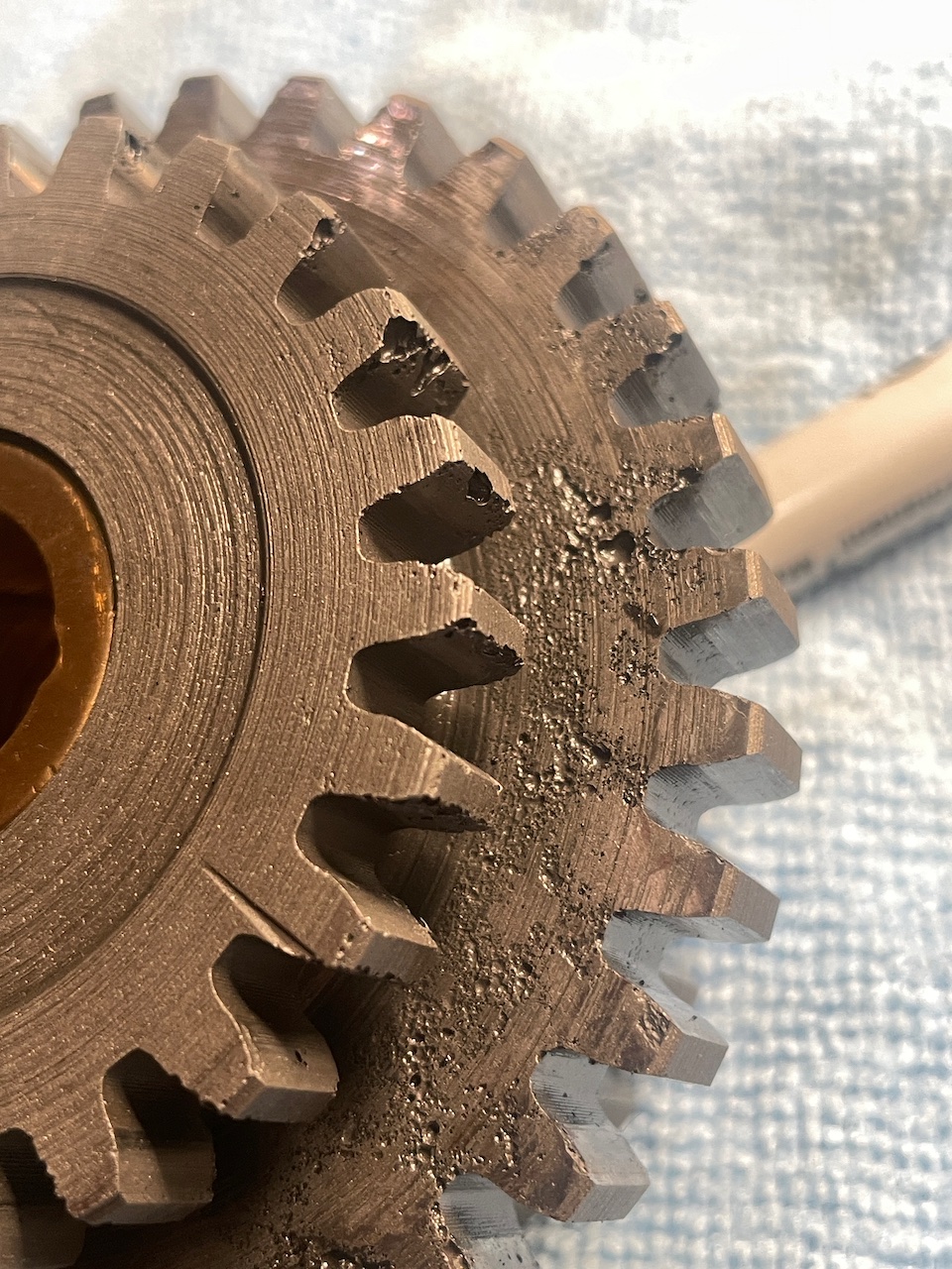

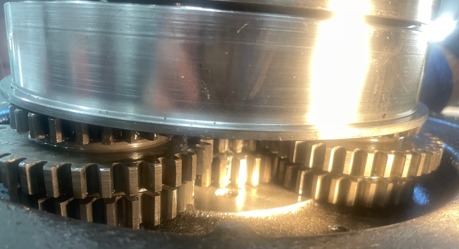

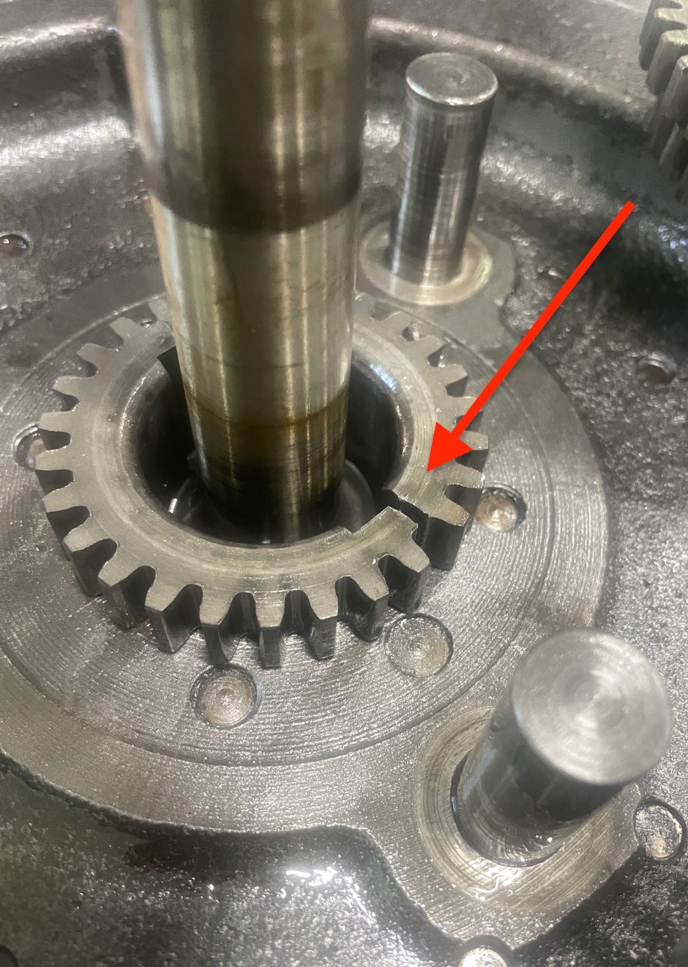

Thought too the triple gears, so when inspecting after disassembly, every thing was pretty ok, clutch spring and drum ok, the turbo discs without wear, but when revolving the drums, there was a bit of catch as the brake drum was rotated.
Peaked at each gear revolving and found this :shock:
Click on photo to enlarge.
So lifted off the drums and took closer look.

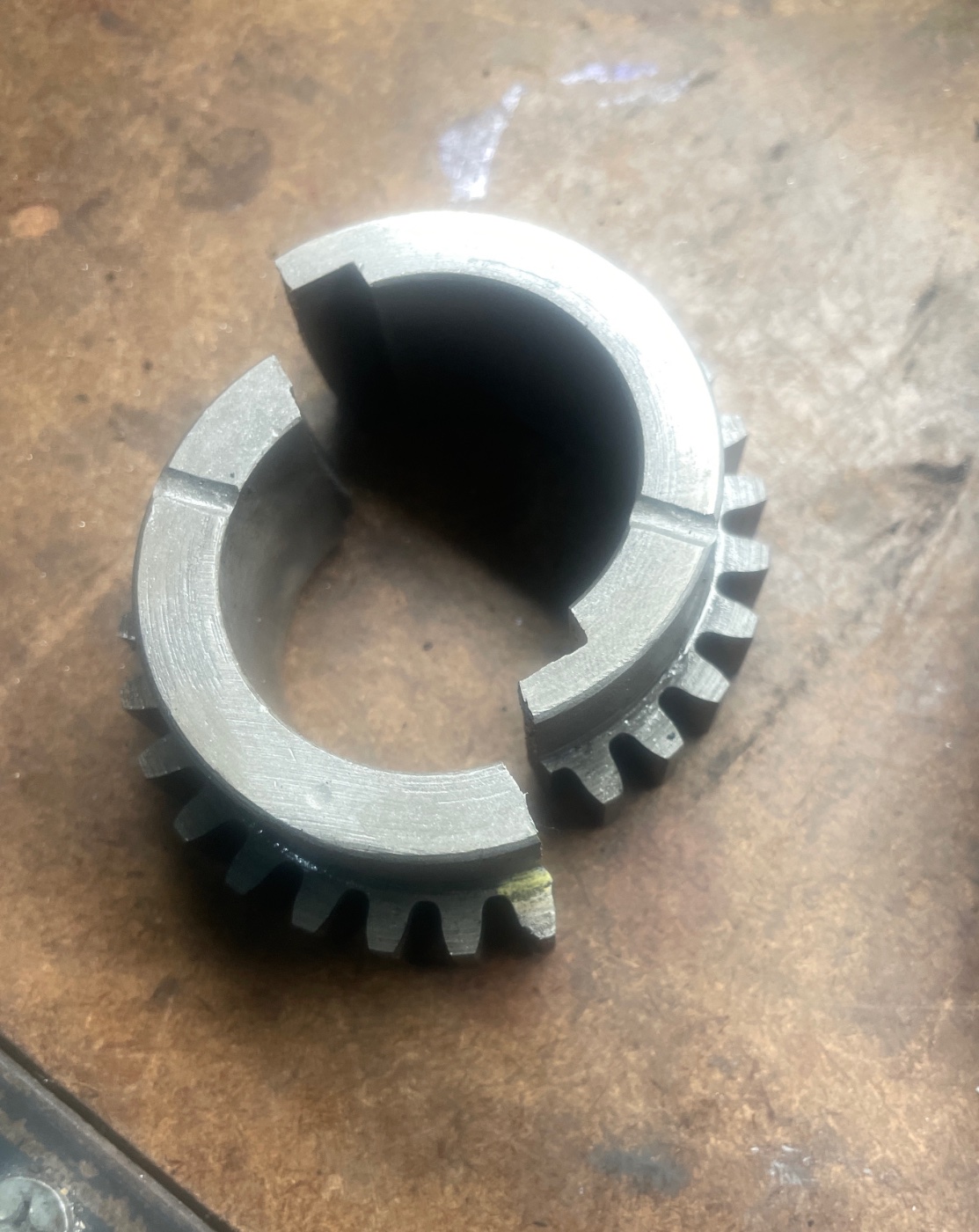

Haven't had this occurrence before, the new driving gear cracked in two pieces, right at the key slot corners. That was the jerky rattle alright!
At least the flywheel recess kept the two pieces together, not sure how long it ran before both sides let go, perhaps the gear ran for a while with one side cracked?
So fix will be to replace the gear with a new one, not sure why this driven gear failed in short time, engine built and put in service May 2022, had about 3500 miles or so on it. Couldn't find a Ford marking on its so guess its a repop gear.

It may be that the gear was defective, or it could be that a problem in the u-joint, driveshaft or rear axle put a shock load on it, causing a fracture. I'd do some checking on the driveline downstream of the new transmission.

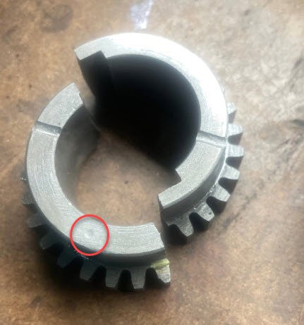

You had me worried for a moment, that drvien gear appears to be an original. I say that because of the brinell hardness test dimple that is visible in your picture. Brinell testing is how FORD checked the heat treat on the transmission gears. Hope that helps!

Well, that's a new failure, I have not seen before.
Why?? Is the shaft new with a slight oversize. Did it press on extra hard?
Posts: 4114
Re: Trouble in the transmission, what's up?
Post by DanTreace » Fri Mar 20, 2026 9:09 am
John
All the parts were new on rebuild, shaft, drums, triple gears, pins , etc.
Thought the gear was new too, but have looked at other Ford driven gears (worn parts I have) they each have faint script or at least letter marks for inspec or maybe steel type, the busted one had same ‘brushed like” finish on the outer rim but no marks I could see.
So it must be a 100 year old part that just gave up finally….stuff happens.

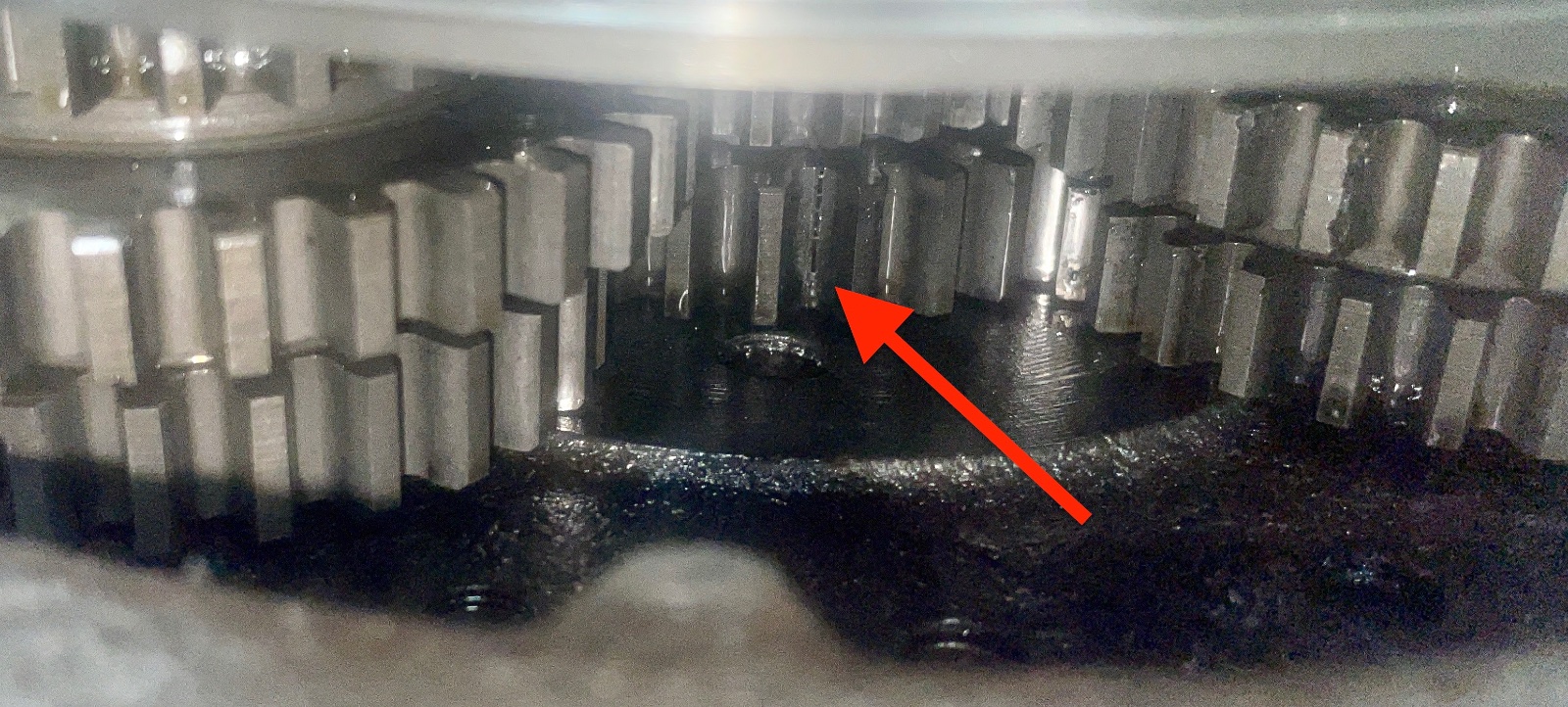

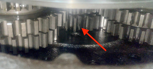

The first picture appears to show damage to teeth on the gears to the right of the cracked one. If something got between those gear teeth, it could have overloaded the gear that cracked.

Might just be oil artifacts on that first photo, but all triple gears and parts going in cleaner tank to inspect carefully. Casual look seems triple gears were ok.
Posts: 8713
Post by TXGOAT2 » Fri Mar 20, 2026 2:21 pm

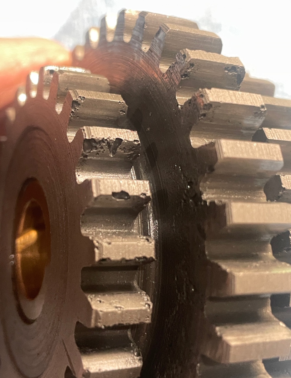

The one on the left in the first picture looks good. The one on the right looks damaged.

Post by DanTreace » Sat Mar 21, 2026 6:12 pm
Pat
You were very correct, one of those triple gears was indeed very poor condition. Was under the impression all new parts were used, the drums are new, but triple gears and driven gear Ford used parts.
Very surprised to see this poor gear used in a total engine rebuild, 2 of the triple gears are what I call very nice still, but this one is something I would have chucked in the scrap metal bin!
Now I got to fix this stuff.

Post by TXGOAT2 » Sat Mar 21, 2026 6:37 pm
I don't think those nasty pits would cause trouble, so long as no teeth chipped or broke or shed flakes. But if the wear on the old gear is different from the other two, it might cause trouble, since they all work together when engaged and all share the load equally when they're in good condition.
