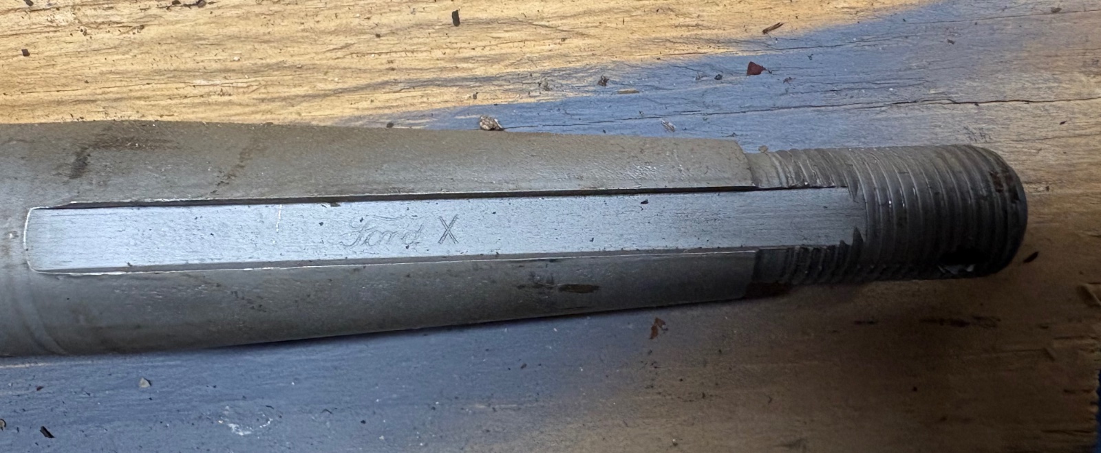

I have a number of axles with the Ford script in the keyway, but I was not aware of the significance. In mining stuff from my stash at the farm, my spares could have come from any rear axle assembly, but while i do have Ford axles so stamped, I do not have many big brake drum housings.

Surely that transcript is incorrect ? Ten million cars on the road represents 2/3 of all Model T production, with rear wheels falling off at an alarming rate ? (Maybe after 10,000 cars ? “. . . period from 1908 . . Z)TrentB wrote: ↑Sun Mar 22, 2026 9:34 pmThe following is an excerpt from The Reminiscences of Mr. John Wandersee:
All during this period from 1908 . . . after we had about 10,000,000 cars on the road, you could drive from here downtown any day you wanted to and see two or three rear wheels laying on the pavement . . .
And, is there any significance to the “X” after the Ford script in the photo ?
Excellent, informative post !! Thank you, Trent !!

That Wandersee posting above is only 1/2 the story regarding axle breakage...it is followed by:
"...We cut out the vanadium. It wasn't so much cutting out the chrome vanadium as it was going to a different heat treat. We devised by proper analysis manganese carbon steel and then heat treated it to give us the designed results. We just dried up everything. We dried up our rear axle trouble and our crankshaft trouble. We had a lot of crankshaft breakage. We substituted manganese carbon there too, properly heat treated.
The manganese carbon steel that Wandersee refers to is Ford Type EE steel. Most of you already know that the EE steel crankshafts were the best Model T crankshafts Ford ever made, and are highly sought after today."
So, the rest of the story regarding 10,000,000 cars on the road and seeing wheels in the ditch are all Model T recollections of trouble which was finally rectified late in production with the introduction of EE Steel.

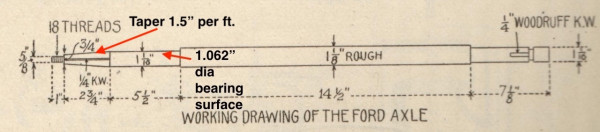

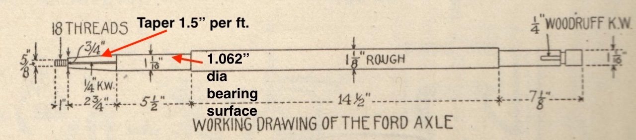

Interesting on breaking Ford axles back in the day. Had posted the below pic of axle dimensions some time ago, obtained it from this article from 1920 issue of Automobile Dealer and Repairer, May 1, 1920, "Special Ford Number" as this issue has lots of Ford info.
Here is the rest of the story on garage shops making Ford axles for customers who have busted axle like this sad fellow
Note the need for repair men to get a share of those 10,000,000 Fords that give way in the rear
