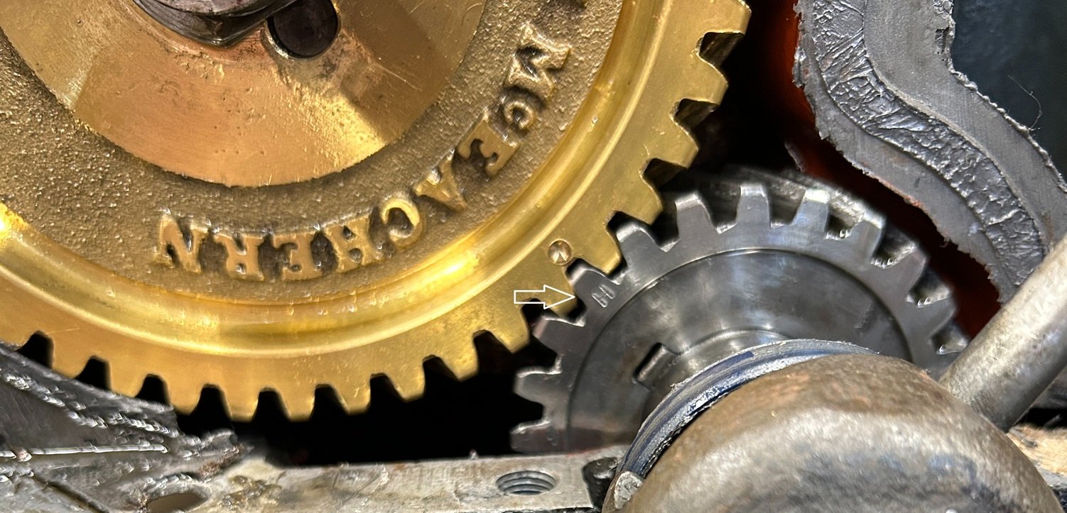

Here is a possibility that John and I discussed. See the photo of the 2 gears, which for all practical purposes are new, due to the rebuild. Note that the dimple in the brass timing gear and the alignment mark on the Scat crank are aligned, as they should be. Have any of you ever run into the situation where one of the spots got “mismarked” during factory production which could put “perfect timing” “one notch away from perfect timing”? A single notch could possibly effect TDC to the point of a "misfire", but not one that a human can feel. Has anyone ever had that situation? Not me, that I know of anyway.
I’m fortunate in that I have access to an exact replica ’27 Tudor (but the replica has a stock crankshaft) that runs very well and with me being a parts swapper, if a defective part is suspected, such as a timer, I simply borrow a known good part from the other car. Timers have been swapped, BTW.

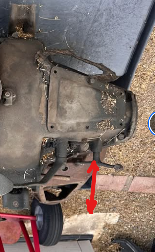

Drive it with the floorboards removed. Keep an eye on the clutch bell crank, (or, have someone else look, so you don't run into anything). When the noise begins, look for side-to-side movement of the bell crank shaft. As the bronze throw-out bearing wears, it can allow a lot of side-to-side play and make a pretty good rattle. When you're in low gear, the throw-out is loaded up with the force needed to compress the clutch spring so, no noise then.

As Jerry VanOoteghem suggested, I was able to manually move the bell crank shaft side to side (Langs calls it a clutch lever shaft), by hand .157” or 5/32”. The bell crank shaft movement was by-hand, not while driving as he suggested. Mainly because I’m waiting for some RTV to dry before I drive it. Maybe tomorrow. I’m hoping that his guess is a good prospect.
