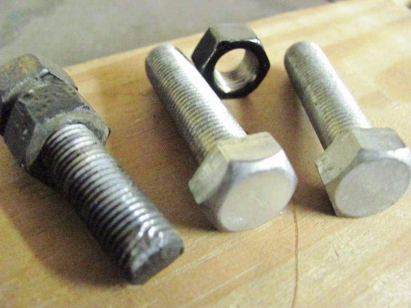

p/n 3403 is 3/8" - 24tpi x 1 5/16". Can also use Fan adj. screw, p/n3973.

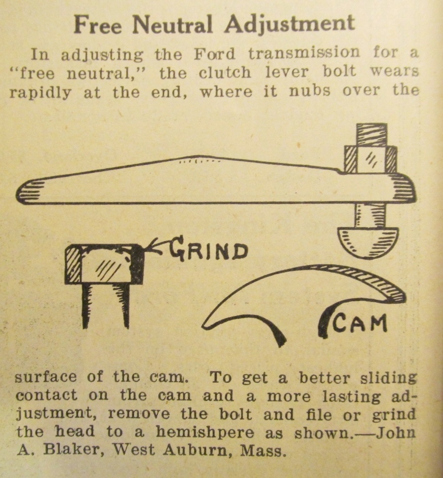

Like to turn the bolt head upside down, and grind the hex a bit rounded as that make a wider surface for contact on the controller shaft. Add some grease too.
