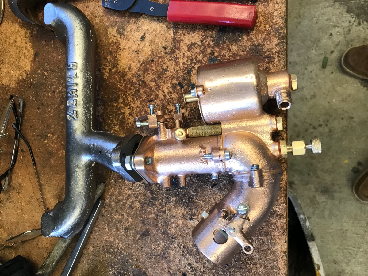

Now the Winfield. The Winfield rebuild kits are hard to come by - I’ve emailed and called the guy who makes them a dozen times - he answered once and then I never heard from him again.. but Robert Weitzel had an extra kit and he parted with it after my pleading when he helped me rebuild my Ruckstell. So, yesterday I grabbed that kit and rebuilt the carb and got it all working. Today I battled with the friggin linkage for a few miserable hours and finally got it to the point I could test drive it. I had to richen the intermediate up a full 2 turns more than the 32 clicks starting setting on the intermediate to get it to even start.

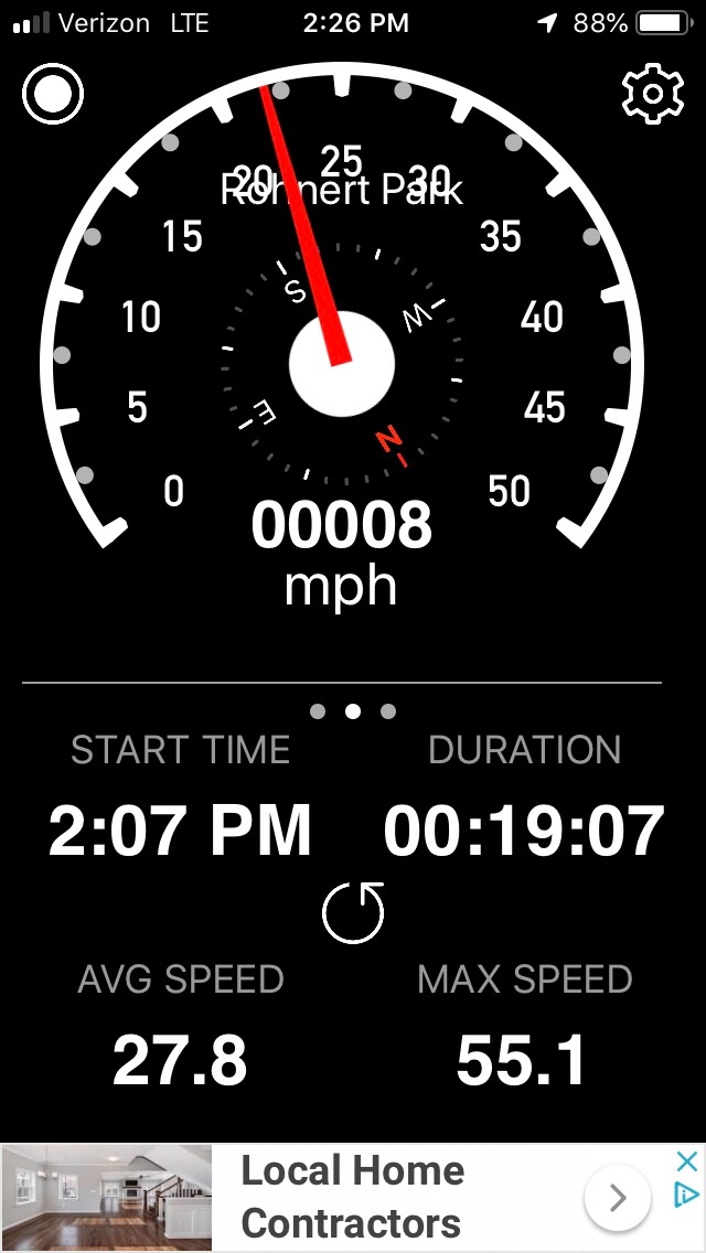

But, once I’d made a few on the road adjustments, holy cow. It’s night and day difference. Two places I really notice it - acceleration is seriously better and an increase in the top end speed which, frankly, surprised me. I didn’t believe the Stewart Speedo so I got my iPhone speed app out:
Only once before have I been at 50mph and that was in Buelton on the 101 going downhill chasing Brad Lusk with the wind at our backs. This time I was on flat road, no wind.
My maximum top speed with the Zenith on flat road is about 45-47 mph. I’m NOT condoning driving at this speed in this car... but as a former racecar driver you always want to know what Bessie is capable of.

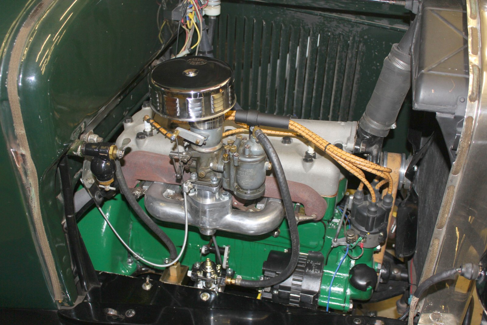

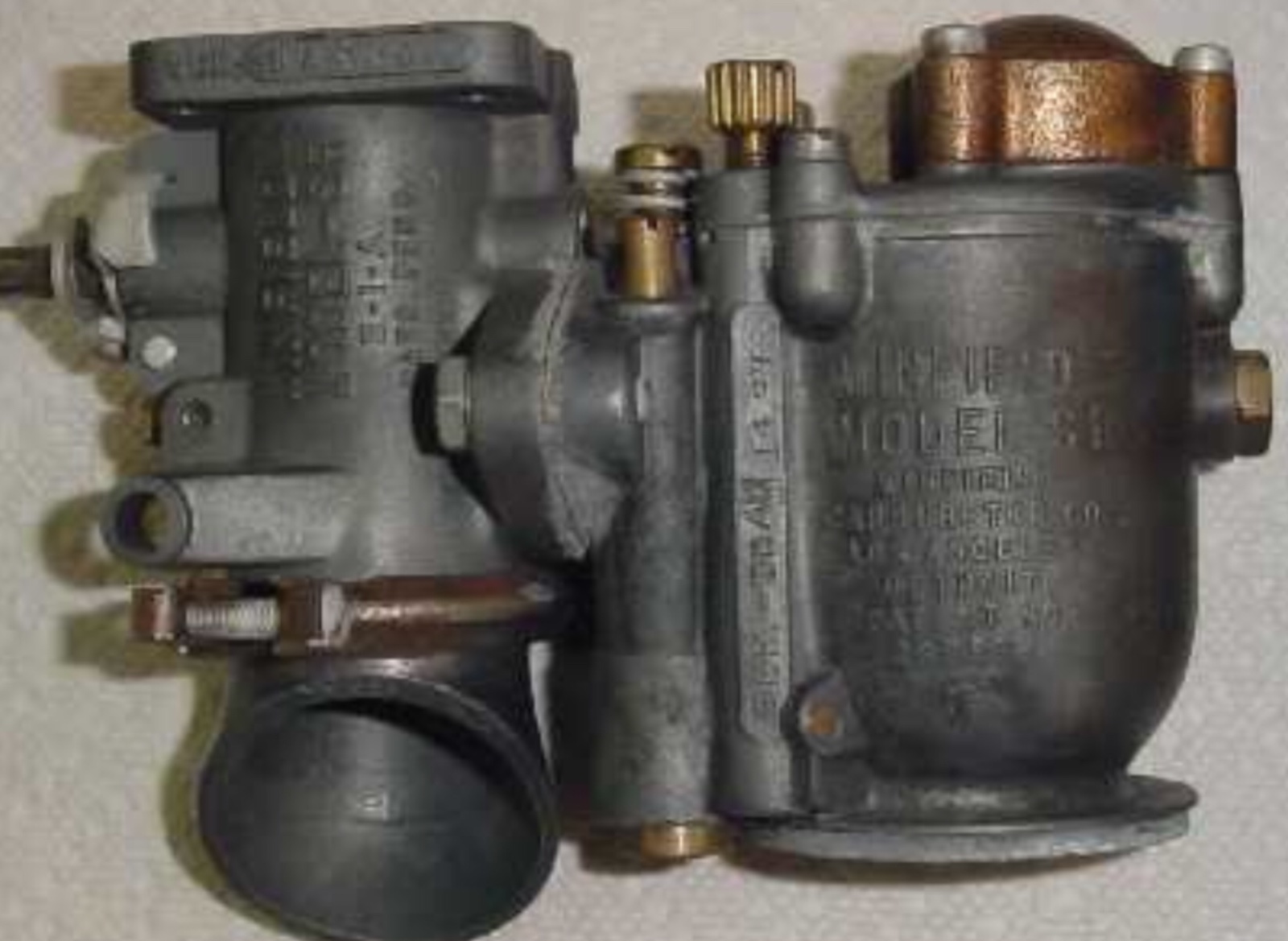

Jeff, In case you didn't know, in your picture of your Winfield SR the carb is missing the bottom half of the accelerator at the fuel bowl bottom. This is the part that gives the engine extra gas at quick throttle opening, like the accelerator pump on a more modern carb. On the Winfield S the bottom of the fuel bowl is rounded and doesn't have the accelerator at the bottom.
Yup, I know. From all the research I’ve done it appears that some SR’s have the accelerator pump and some don’t. Mine doesn’t. Depends on how the dealer who sold the carb configured it.

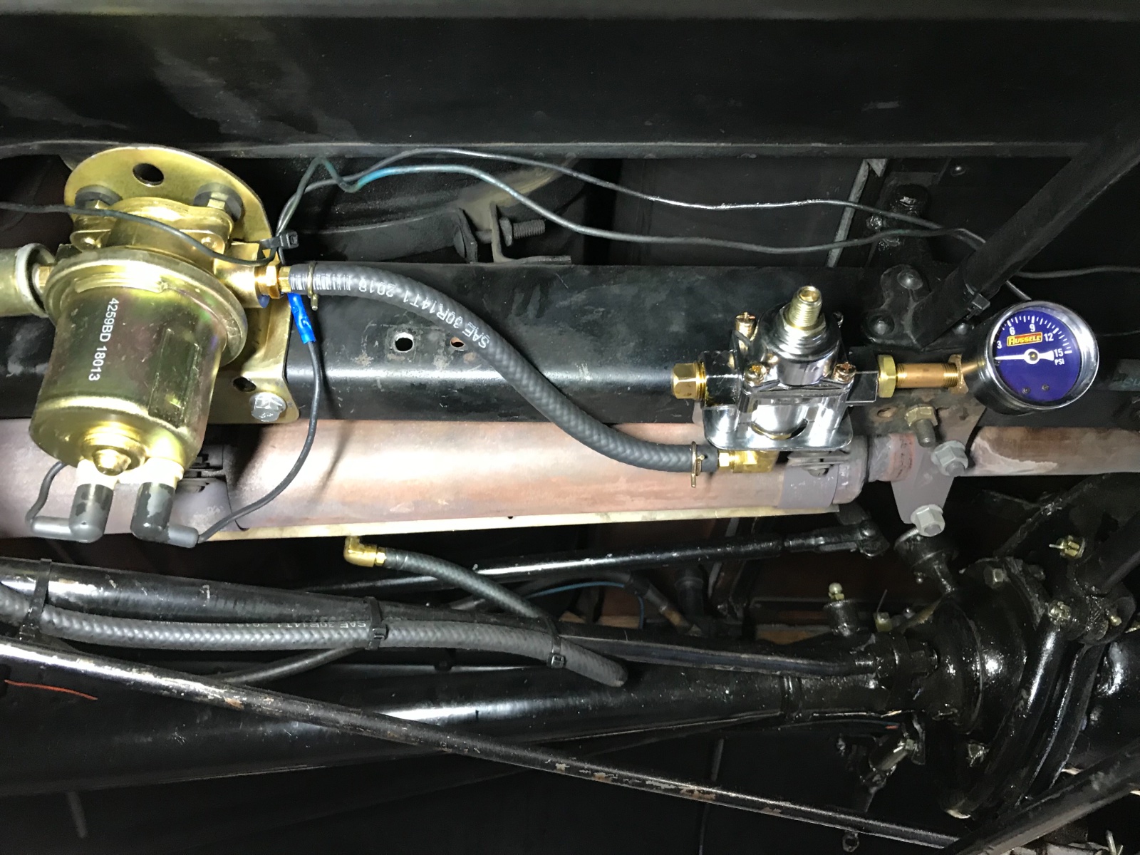

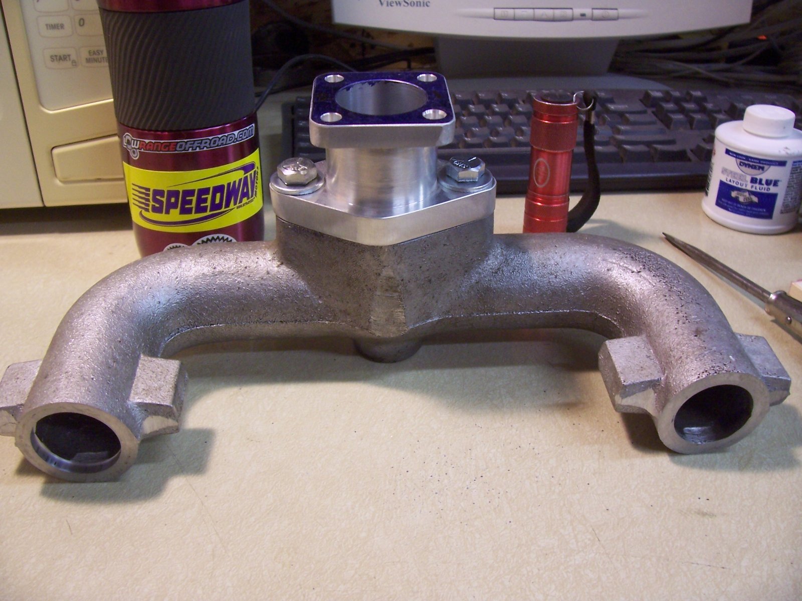

There is a guy in L. A. that makes kits for the SR, good quality. I ran a fuel pump and a regulator on my SR. My reading indicates a gravity float and needle and a pressure float and needle. I set the reg. at 1.5 psi. My SR has an accelerator pump and it works good. I get good mpg and it will idle good. Very good performance. I have to watch my speed as it will run right on up to 50 easily on the flat in this 27 Tudor.
AdminJeff
Re: Winfield SR vs Zenith S4BF
Post by AdminJeff » Tue Jul 16, 2019 2:57 am

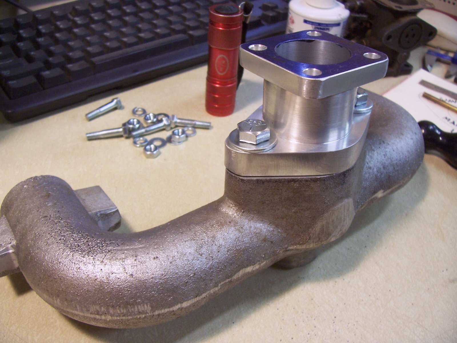

Very interesting intake manifold... I like it. looks like mine was a hacked flange welded on to on a stock NH from what I can tell. Yours looks MUCH better, more volume. Would you mind getting me a close-up pic of it? I might get inspired one day and fabricate one like it.
My regulator pressure is set for 1 to 2 psi as well. Luckily I crossed that nasty bridge a while back when I installed the Zenith carb. I went thru 2 fuel pumps and 3 regulators before getting the Carter 6v pump and the Holley regulator.
kelly mt
Posts: 271
Last Name: Kelly
Location: Noxon MT
Post by kelly mt » Tue Jul 16, 2019 9:52 am
The manifold was an unfinished casting that I picked up on ebay. I had to make the carb adapter and the finish work on the manifold.
AdminJeff
Post by AdminJeff » Tue Jul 16, 2019 10:41 am
Wow. Really nice. Do you think the casting was one of a kind or mass produced? Ok I guess I need to start looking on eBay! I thought it was aluminum tubing at first.
kelly mt
Posts: 271
Last Name: Kelly
Location: Noxon MT
Post by kelly mt » Tue Jul 16, 2019 10:55 am
I think Smith & Jones used to sell them.
babychadwick
Posts: 732
First Name: Chad
Last Name: Azevedo
Location: Henderson, TN
Post by babychadwick » Tue Jul 16, 2019 7:03 pm
I just bought one a while back, Langs sells them.
https://www.modeltford.com/item/INTAKE1.aspx
On mine I increased the size of the mounts so that they can be drilled thru. This allows me to mount the exhaust manifold then mount the intake separate allowing for removal without having to disturb the exhaust.
