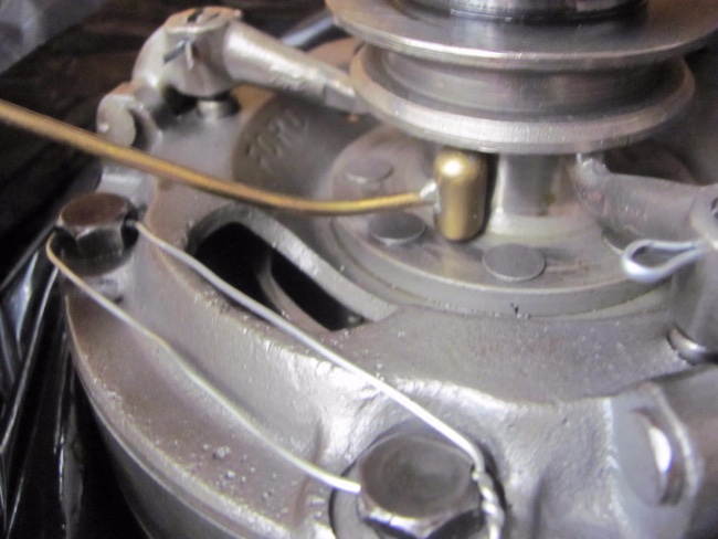

On a 1926 transmission, the rear band (the brake) is supposed to be wider. Your Kevlar material is wide, but your band is narrow, like low and reverse. This combination of parts will not last very long and will not provide all the brake power that you should have.
This may be a difficult search for you, but you need to be using 2 narrow bands and 1 wide band. Then follow advice given previously and make sure the low pedal shaft moves in to squeeze the band for low gear, and then FULLY releases it to go into high gear.
Posts: 4102
Re: 1926 Ford Model T Transmission Bands
Post by DanTreace » Fri Jul 12, 2019 12:20 pm
Scott
The trans drum shown in his photo is a Large '26-'27 style drum. You can see it clearly and the special long boss 3323B driven plate bolts used in '26-'27 too.
Nice about this forum, if you click on his small photo, and allow your PC to run the foreign site, the photo is enlarged to wonderful big size!
And you can clearly see the Large drum.
I only lightened the small one some, but you may can see if zoom in large drum and those 'standoff' bolts on the recessed large drum driven plate.
Posts: 6817
Post by Scott_Conger » Fri Jul 12, 2019 12:25 pm
Dan
You're right, but I did not say the drum was small. I agree, it is clearly big.
Now that we're past that... do YOU normally see that much Kevlar sticking out from the width of a wide band? This transmission appears to have a wide drum, wide Kevlar material, and a narrow band that the wide Kevlar is riveted to...OOPS! ;)
Posts: 4102
Post by DanTreace » Fri Jul 12, 2019 1:46 pm
Scott
Oh my :oops:
You are soo... right! Totally missed that! Large brake drum with narrow drum band.
Dan
Posts: 7306
Post by Allan » Sat Jul 13, 2019 1:21 am
Scott, I made the same mistake, and I was looking for just that situation. I took the wired bolt heads as those used to fix the driven plate to a narrow drum. Now with Dan's tip to magnify them, I can see what I was looking for in the first place, namely , wide drum, wide lining, narrow band. I guess there is no real problem in use, other than the benefit of the wider brake band will be lost.
