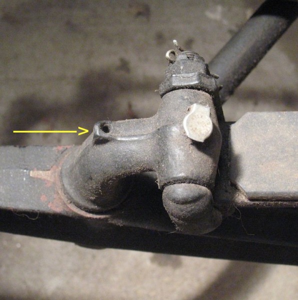

Post by Steve Jelf » Wed Jul 17, 2019 12:10 am
Here's a picture of what Jeff said. Tab goes toward the rear of the car. I agree with Allan, it's easier to turn the axle around than to switch the perches.
