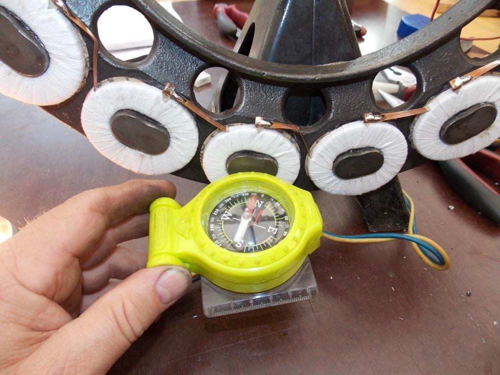

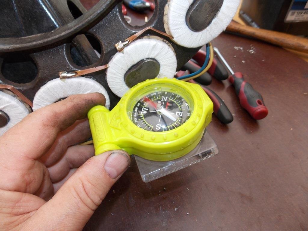

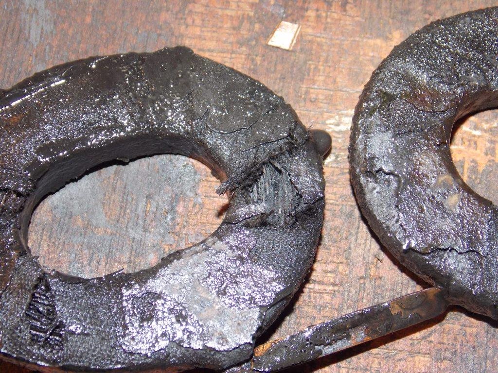

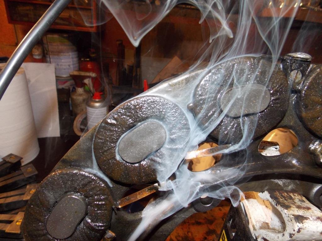

During the rebuild of en engine last Saturday I was recharging the magnets by using the coil loop that came with the engine and was looking good.

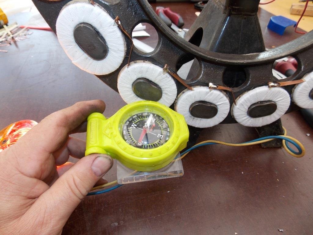

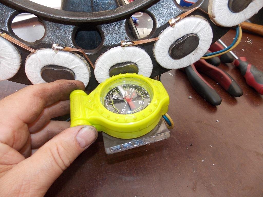

Before I tested the coil ring by building it in serie with a 12V 21W light and a 12 battery and checking the change of polarity on each coil. No problem there.
For recharging the magnets, I use three 12V battery's in serie and flash the coil ring a few times. During this there was some smoke coming out of one coil.
Result: magneto coil ring need a rebuild!!!!

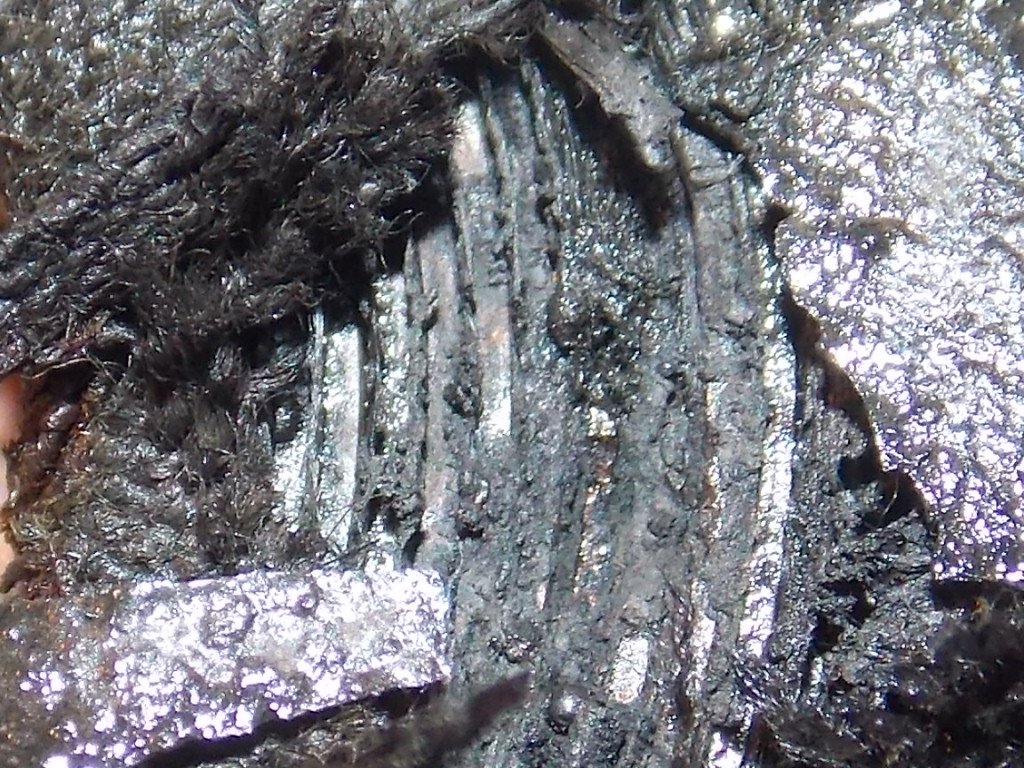

First I was thinking to replace only this coil but I found there was no insulation between the coil and the cotton warp. All the loop will come apart and will be rebuild.

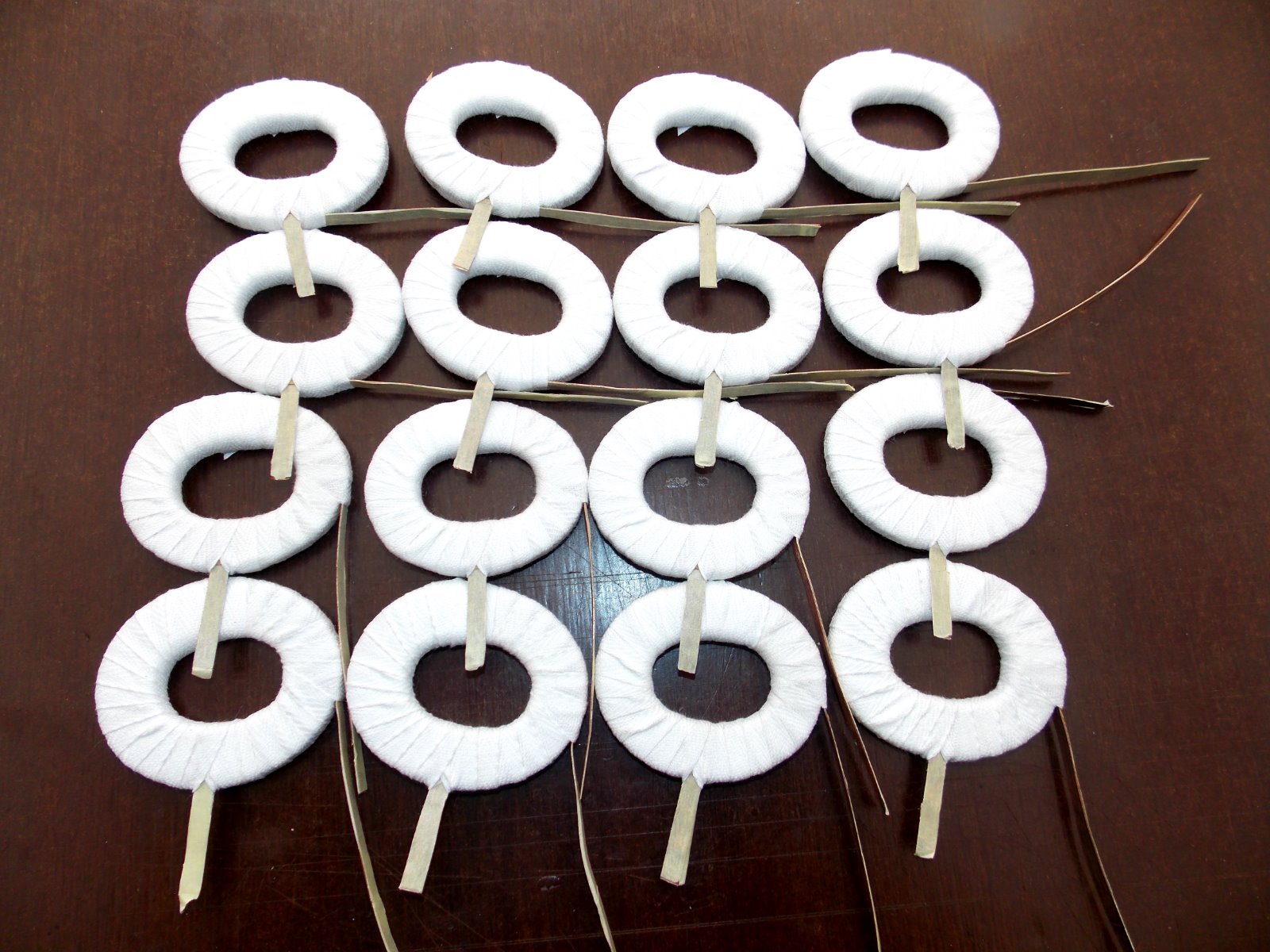

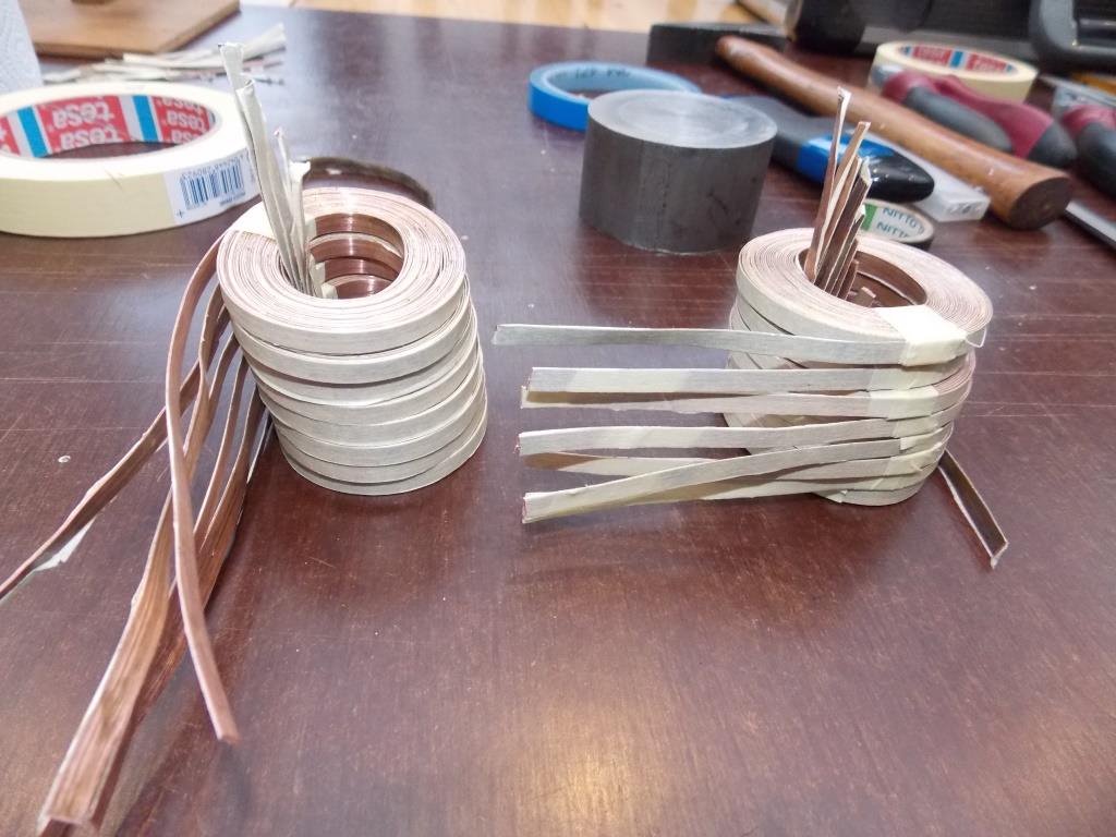

By the way the coil loop is nearly done.

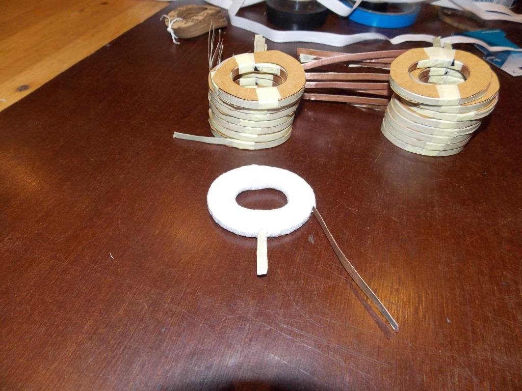

Missing two layers of polyester and one layer of isolation varnish to go and the fire is out.
