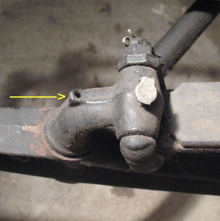

The perches set the angle. The top of the perch has a little tab that is offset slightly, that tab should be on the back to set the correct angle.

- Posts: 7393
Re: 26 front axle trouble
Here's a picture of what Jeff said. Tab goes toward the rear of the car. I agree with Allan, it's easier to turn the axle around than to switch the perches.
