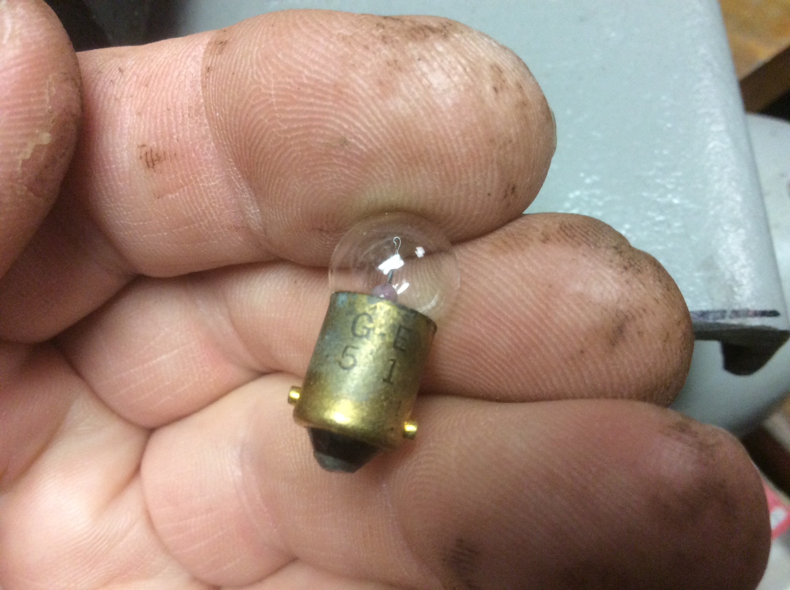

Does anybody know what bulb is used for the pilot lamp on a Yankee 960 turn signal switch? This is for 6V. It's a smaller base than BA15s but I don't know if it's a BA9s or something different. I think Yankee and Signal Stat would be the same, I'm just not familiar with them.

Gary, I use old 1940s signal stat #700 mechanisms inside old turn signal boxes from the 1930s. Those use a GE 1-5 It’s a very small bulb. Maybe that will work

Sorry, GE-51

Is yours screw in or pin type?

It's a bayonet style bulb (pin).

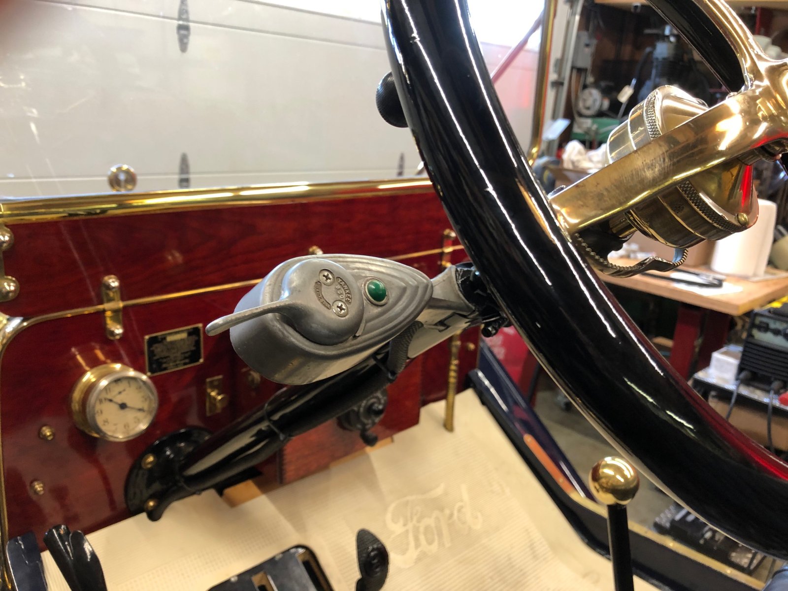

Post by modeltbarn » Fri Jul 19, 2019 4:31 pm
This is the switch I used, and the lamps.
