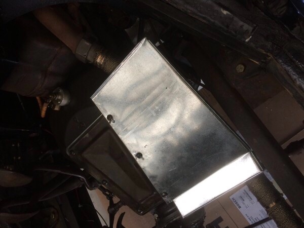

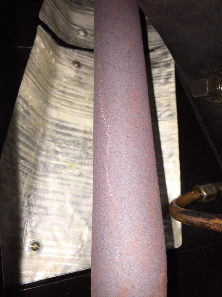

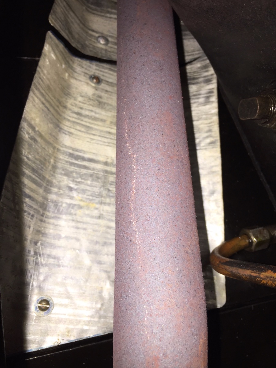

Or you could use an aluminium shield mounted with spacers and wood screws under the floorboards. Two pieces . One for each floorboard.
Ps:Sorry Had to repost this due to the website transfer the picture got lost.

Post by Mountainrider » Sun Jul 21, 2019 2:16 pm
Repost of picture
