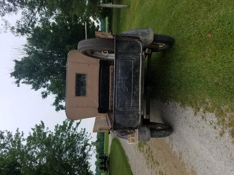

Re: Pickup spare tire holder
My solution. Bolted to wood side board at rear of bed.
I have yet to install the original pickup box on my ‘23 runabout but here is the vintage spare tire bracket that came with my car.
