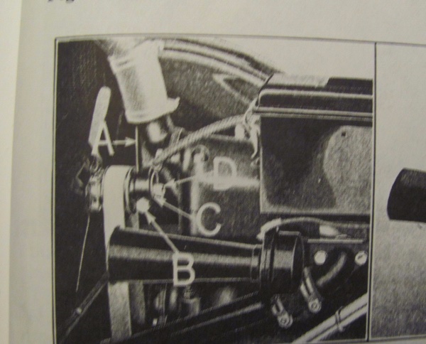

Do you have a picture you could post?

Think these match the description that was given. I copied them from previous MTFCA threads

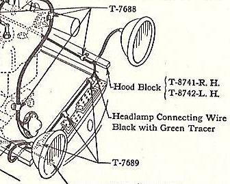

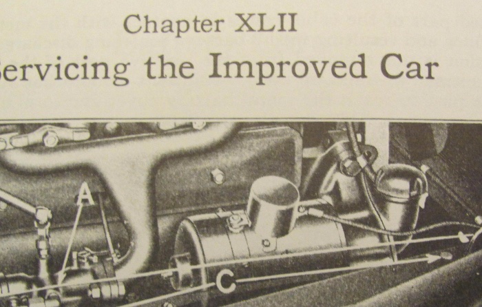

Post by DanTreace » Wed Jul 24, 2019 9:40 pm
Those spots are correct for the harness clips, #7688, under the drivers side water outlet bolt, and another clip under the large hex head bolt on the timing gear cover. The correct clips have large diameter hole to fit to these large bolts.
As noted in Ford Manual:
IMG_2984 (600x484).jpg (117.58 KiB) Viewed 3795 times
