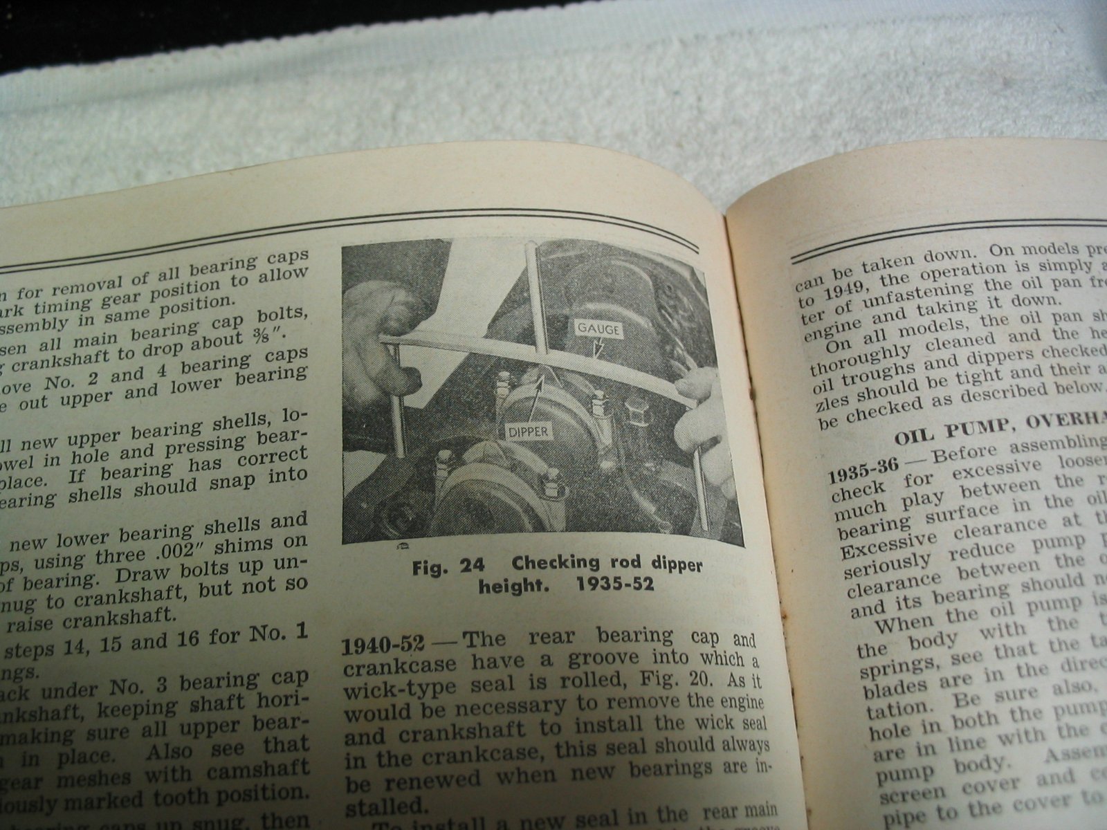

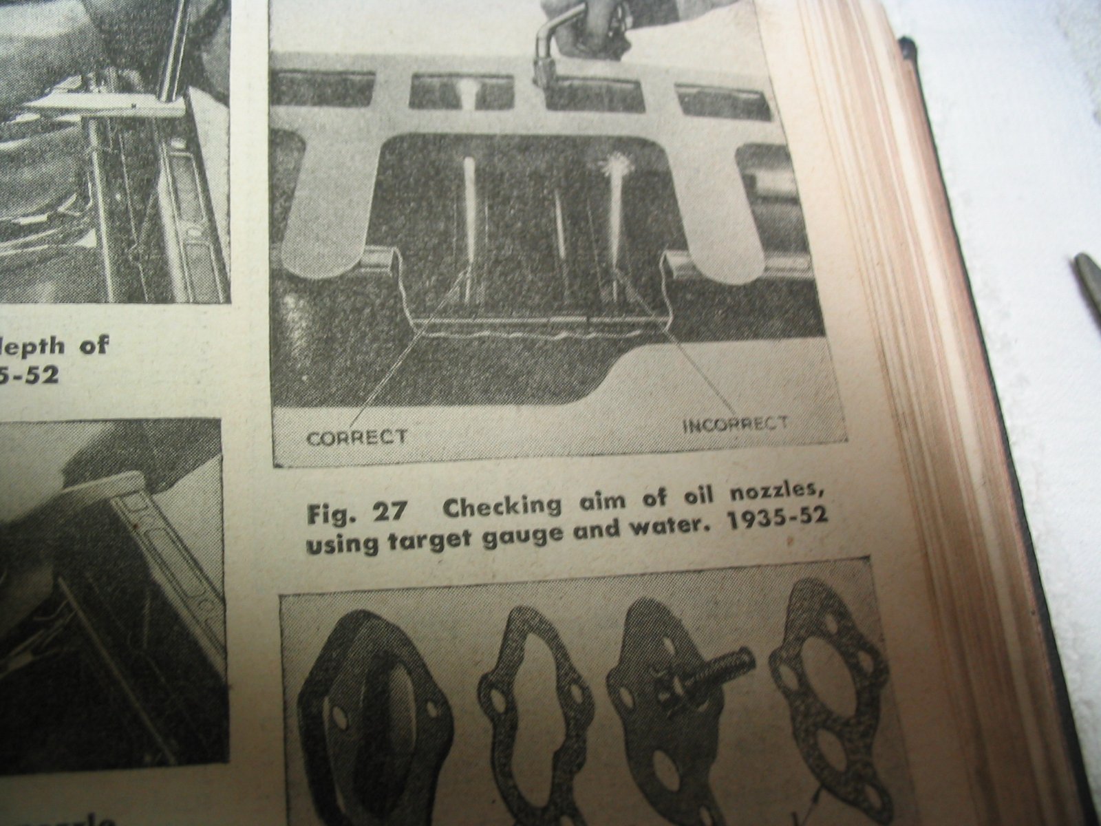

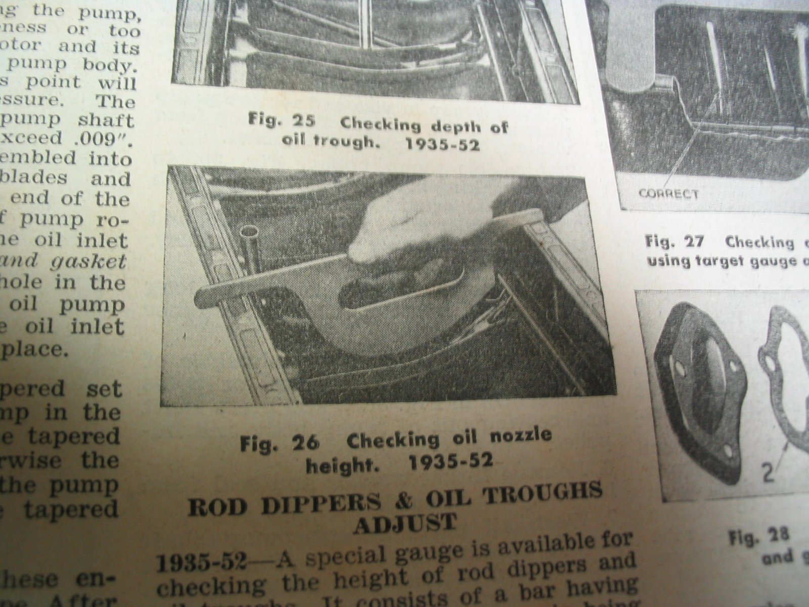

Do you know how many degrees of the crank rotation the oil spray set up would hit it's target of the dipper? would it be more than the oil dip of a T ?

Frank, I don't know the target info in crank deg's of rotation, the spray hits the dipper a little before BDC above the dip tray that fills with oil, and would hit the bottom of the rod a little after it leaves the dip tray. The targeting left or right is the more important than up or down a little off so that the dip tray fills with oil on the rods up stroke.

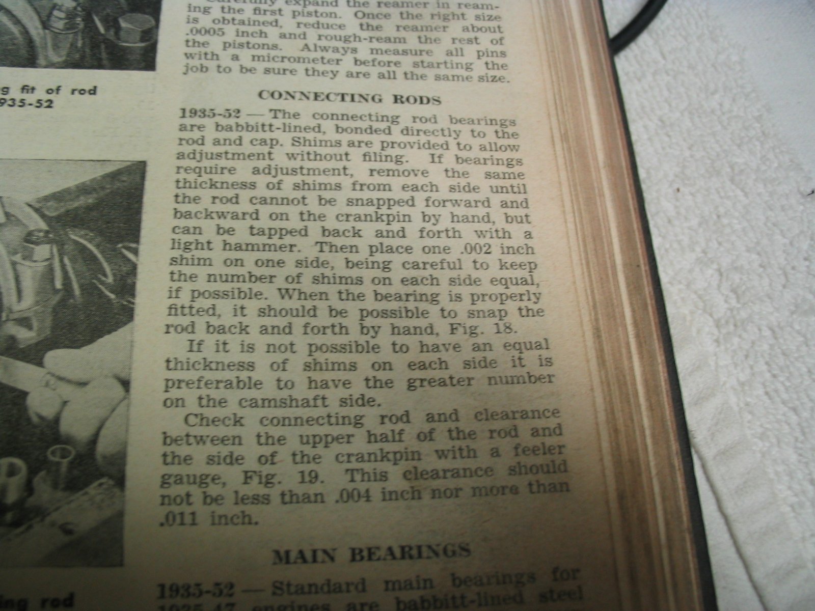

Post by Kohnke Rebabbitting » Fri Jun 07, 2019 8:09 pm
Pictures.

Thanks Herman for the pictures.
