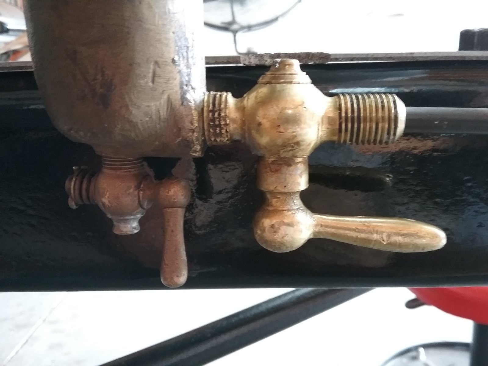

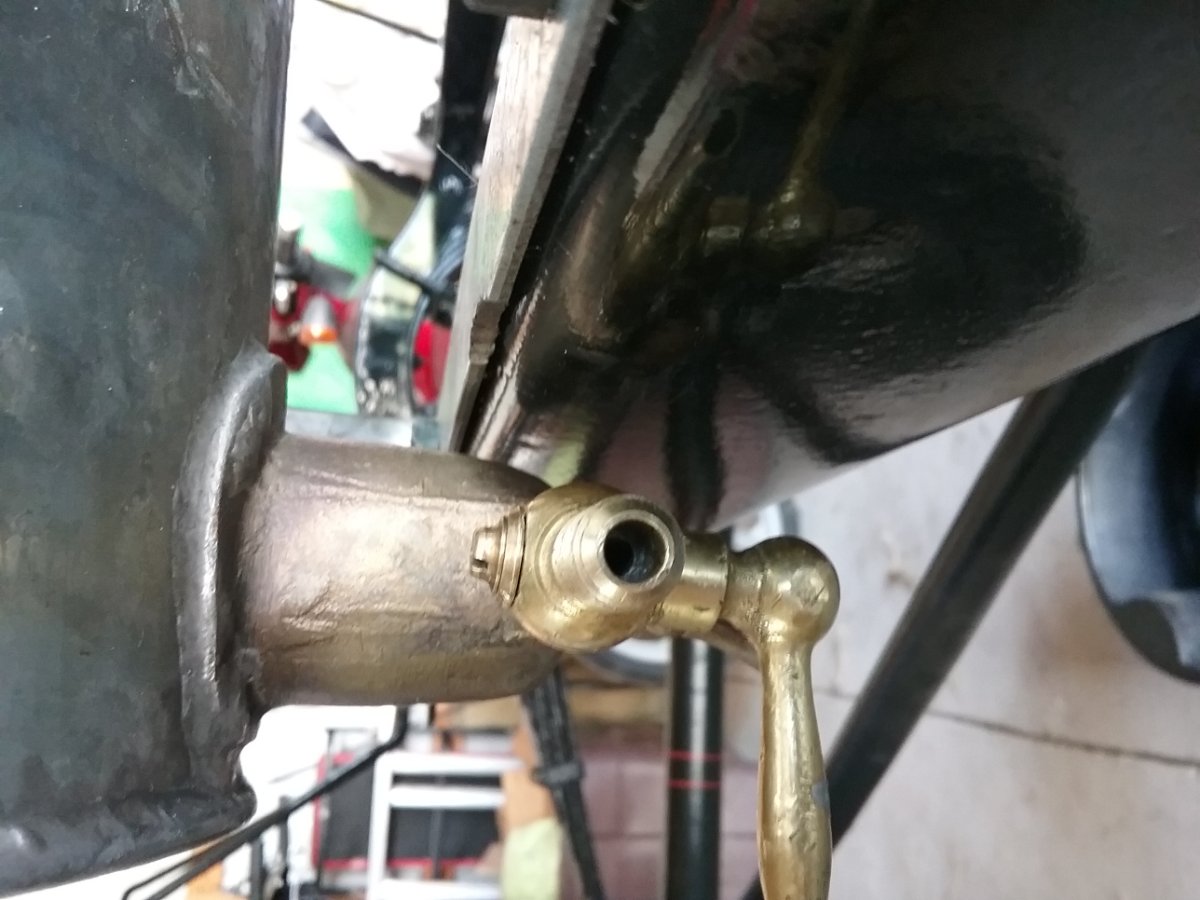

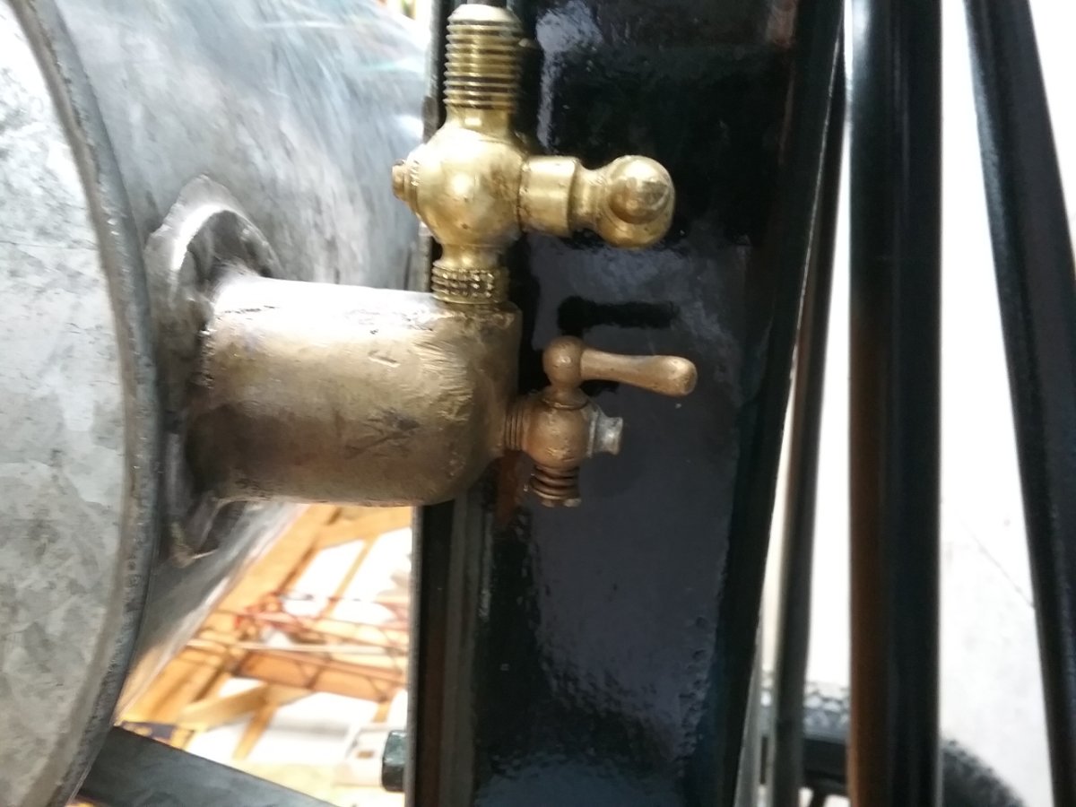

Here are some more photos of my sediment bulb. It doesn't appear to be like any bulb Ford supplied on the 1909/10 Model T's; in fact, I don't see anything like it in any of the supplier catalogs! The tank looks pretty new, but the threaded filler opening, as well as the sediment bulb, have been soldered on and look pretty original. Can anyone identify this particular bulb? I don't know why the pictures are sideways, but if you click on them they will turn to normal view.

Your sediment bulb is the Ford correct soldered in place bulb. Found on 1911's, so your tank could be later or your '10 is a late build. The '09-'10 more common ones are threaded, but very short rounded bulb.

Knowing what products are designed to do is usually a help...
Permatex is a sealant. It will seal imperfect or damaged threads and when used on NTP threads, the fitting can be stopped short of "tight" and still seal. This is probably a benefit on a fitting that is #1 damaged as shown in the photo, and #2 really requires that the shutoff valve have a beneficial location ie not facing toward a structural member so as to allow access.
Fuel Lube was originally Mil-Spec'd as a tapered-plug type fuel shutoff valve lubricant. It is excellent for that. It is also used occasionally on NTP threads to allow (as a lubricant) the extra "oomph" to seat tapered threads. I do not believe this would be an ideal application in this instance as neither end of the coupling has virgin, undamaged/worn threads and thus will not seal through intimate material contact. You are now relying on a lubricant to seal.
I prefer lubricants to lubricate and sealers to seal

Bill, the outlet fitting on your sediment bulb has a tap with which I am unfamiliar. It looks to have a parallel thread on the fuel line side as is usual, but it appears to have the angled face on the end to accommodate a flared fuel line, which I believe is not usual.The round handle on the tap is also not that with which I am familiar, but that could well be a reflection of my very limited knowledge of the early T's.

It appears that your threads are not compatible, the casting is tapered pipe and the fitting is parallel. Find a valve with a tapered pipe thread.
