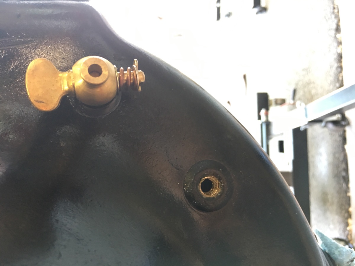

Post by Quickm007 » Sun Jul 28, 2019 2:48 pm
A petcok just broke in the pan. How to remove it without damage the pan ?

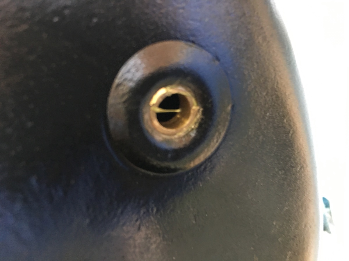

I would try an "easy out" of the correct size.
Posts: 4042
Re: How to remove a broken petcok in the pan
Post by DanTreace » Sun Jul 28, 2019 2:53 pm
A small Ease-Out tool, works like a tapered tap, threads in with opposite threads on the tool, allows simple twist with small wrench to remove that stub of the 1/8" pipe -thread petcock.
Posts: 7392
Post by Steve Jelf » Sun Jul 28, 2019 3:20 pm
There are two types of Easy-outs, spiral and straight. For a small brass item like that I'd use a straight one.
Howard Tomlinson
Posts: 44
Joined: Sun Jan 06, 2019 7:23 pm
First Name: Howard
Last Name: Tomlinson
Location: Orange VA
Post by Howard Tomlinson » Sun Jul 28, 2019 3:51 pm
The last one I had I used a square "cut" nail as a easy out. Drove it into the broken end of the petcock (just enough so it got a bite on the brass) and then vice grips to turn the nail/broken section out. A "old time" hack.
Ruxstel24
Posts: 2379
Last Name: Hanlon
Location: NE Ohio
Post by Ruxstel24 » Sun Jul 28, 2019 4:00 pm
A good quality torx bit socket will work.
Drive a snug fitting one in till it bites.
I have used them to extract broken exhaust manifold bolts in cylinder heads before.
Post by Rich Eagle » Sun Jul 28, 2019 4:32 pm
I have used the straight easy-out for that. If it doesn't take it out it will ream it down to the threads which can be picked out. Then clean up with a pipe tap. It will most likely come out easily.
Posts: 4618
Last Name: Kuehn
Location: Texas
Post by John kuehn » Sun Jul 28, 2019 5:21 pm
In my years in maintenance work I have found the the straight type Eze out usually work better than a spiral type. That twisted off petcock should come out fairly easy by the looks of it.

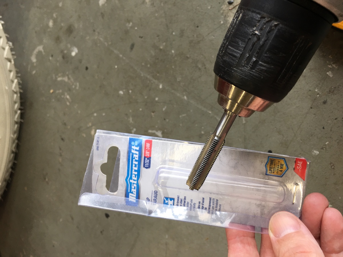

ehhhhh....3/8-24 is NOT a 1/8-27 pipe tap
you no longer have a tapered hole and if the drain is a tight fit it is only because it is now cross-threaded.
plan to use sealant
