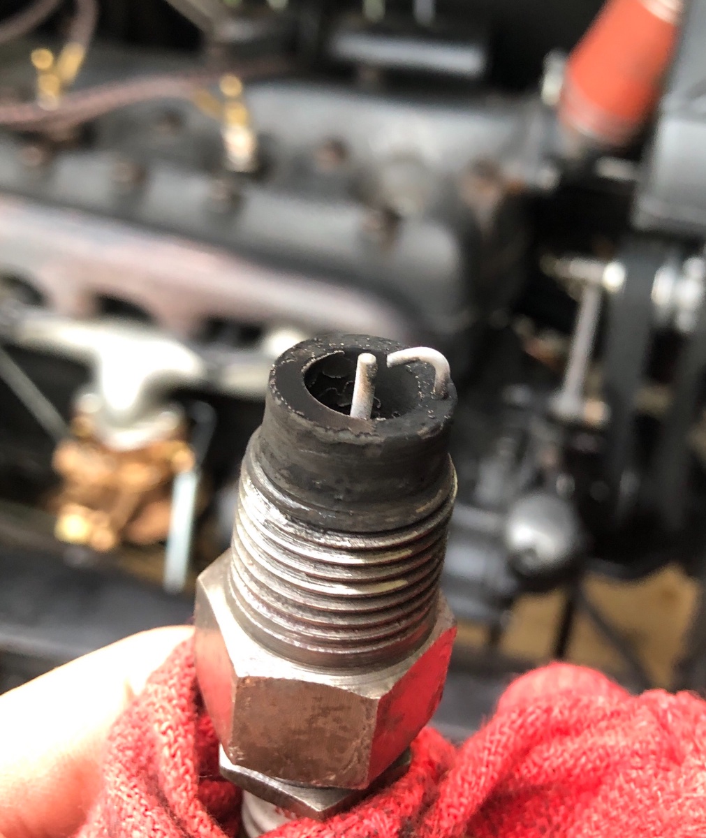

Been wrestling with the fuel input in the U&J carburetor and checking everything in the fuel and electrical systems. I usually drive with the spark advanced pretty far except when climbing hills and the gradually advance as I gain speed. Here is one of the vintage Champion X plugs. They all look pretty much like this. I keep a thin Barber dime on my key chain as a thickness gauge.

Mark,
You need to look at the porcelain inside.
It looks good from that shot, maybe a little lean.

Yes, they look good on the porcelain. Didn’t take a picture. I think most people who drive Ts have pretty sooty plugs from short drives and too rich a mix.

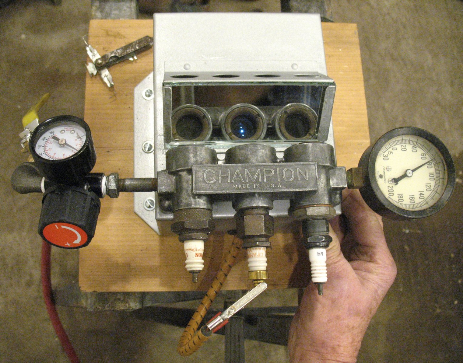

I would measure that dime and be sure it's close to .03125".
The only real spark plug test I know is to see how they fire under compression.
Champion X plugs are great, but if they're assembled too tight or not tight enough they can go south on you. Cary plenty of spares so you don't have to limp along on three cylinders when a plug fails.

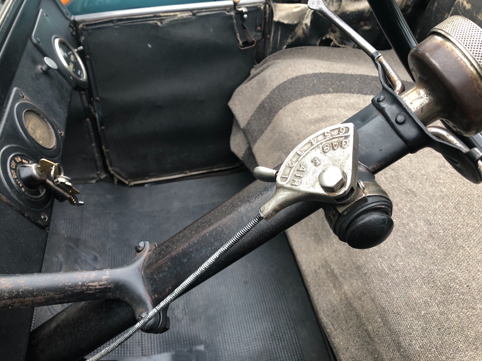

I’m still trying to get more gas into this carb. I’m using the remote choke control now .. see picture. I’ll clean the plugs and inspect them again after an hour long drive.

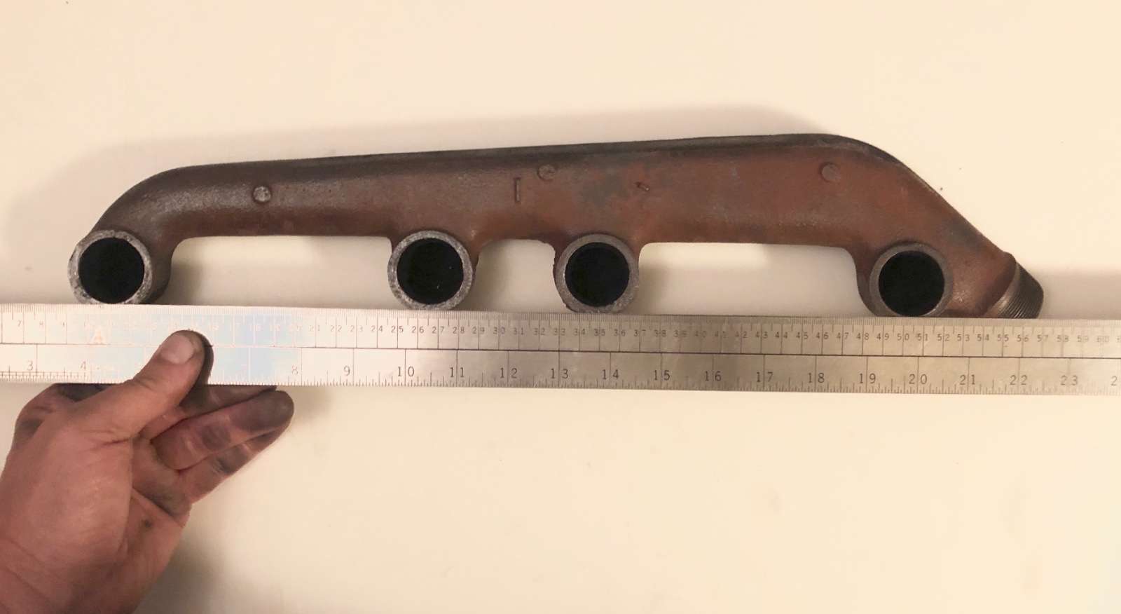

Yes “manus manum lavat” the exhaust was warped. It prevented me from getting the intake tightened down enough. Who knows, could be the source of the fuel problem of the carburetor. Never had a problem with that manifold before installing the U&J. Engine ran fine. Guess it was just its time.
- Posts: 7398
Re: Evaluating Spark Plugs
I believe new exhaust manifolds come only in the 1925-1927 style. If you care about that, you'll need to find a good used one for an earlier car. I consider a manifold toast if it's warped more than ¼". Under ¼" it will probably survive straightening. Some claim that straightening a manifold burns up more gas than the price of a new one, but that has not been my experience.

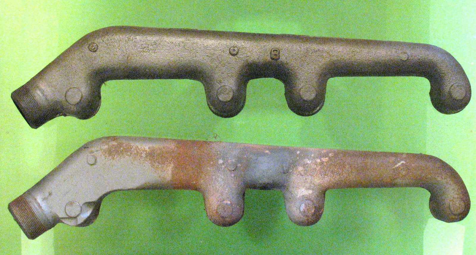

I’ll buy a new one at Lang’s this week. Don’t care if it’s a little different than the original. Will be nice to not have to wrestle with a warped one. If I can find a decent used one at Hershey this year I’ll buy it. What is the diffeencd between the 1923 and 1925 design?
- Posts: 7398
Top is 1924 and earlier; bottom is 25-27. All the dealers have used parts not listed in their catalogues, so Don may have the right used one for you.
