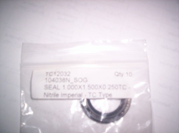

For years I fitted the seals supplied by the vendors and we all know that the have too smaller OD and need to be glued/sealed in place.
So the million dollar question is, why have we been putting up with them when I simply walked into our local bearing store and bought the right size to fit in??

So, what is the number of the seal with the proper OD?
- Posts: 7165
Re: Cam shaft seal
Frank, that's the standard size, 1.0" internal 1.5" external, 1/4" wide. I have bought the same size from CBC. Sometimes they fit, sometimes they don"t. My guess is the timing covers vary. After all, a lump of felt will fit any size hole.

Kerry, Have you tried your new seal in your timing cover yet? Was it a good “press fit”? If it was, then that seal is oversize, or the hole in your cover is undersize...
Kerry
Topic author - Posts: 1462
- Last Name: van Ekeren
Re: Cam shaft seal
Yep, a good tight fit, tried another in several covers on the shelf 1916 and up, same thing, I've never had one from the vendors be any more than a fall out fit and need to be glued in and I've fitted many on every rebuild over the years.
