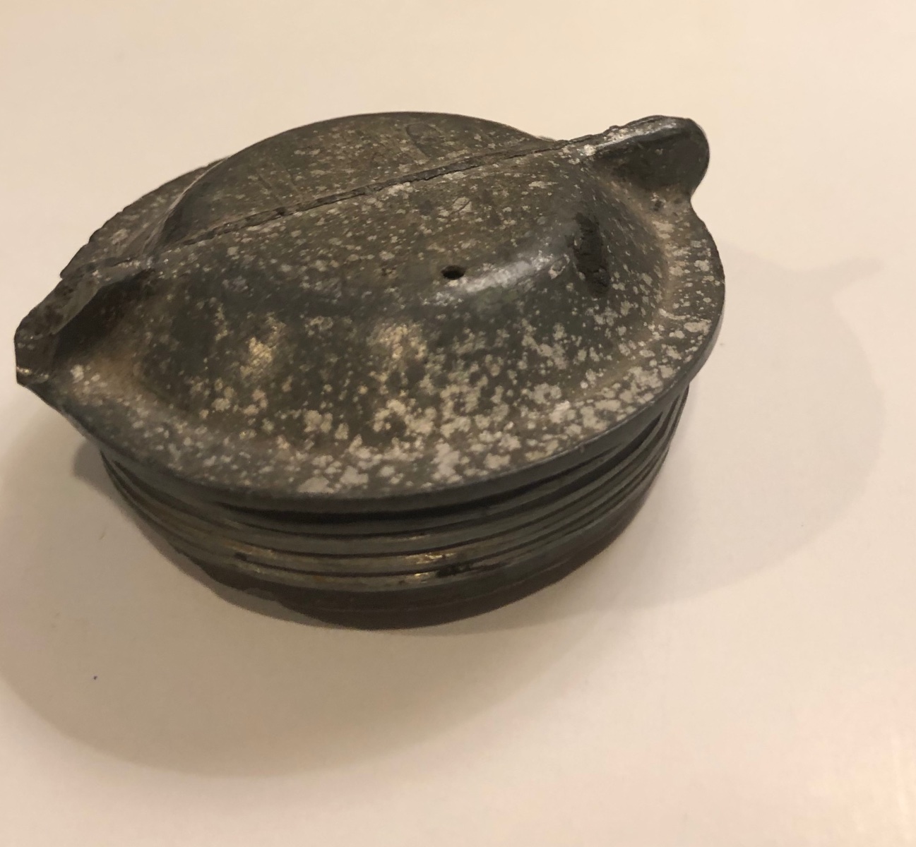

Re: Gas Cap for 1924
'24-'27 gas cap. Wings on outer ends, two=piece, baffle across bottom of cap to prevent slosh out the vent holes.
Original type cap for '24-'27
Lang's made repros and still may have them on hand.
Hi Dan, thanks for posting. Do you know if it is made of steel or?
- Posts: 3976

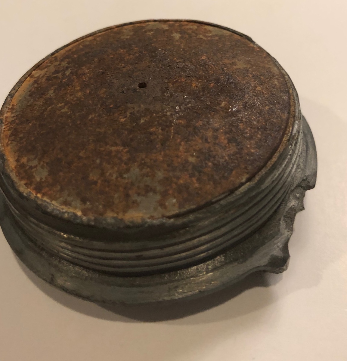

It's made of die cast metal, likely a zinc alloy, the baffle plate is a thin dome shaped steel sheet, soldered in place.
My original is now rattling too, as the plate is a bit loose from its solder.

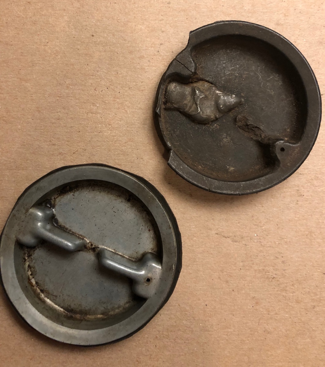

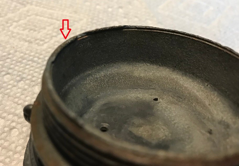

- Posts: 6458

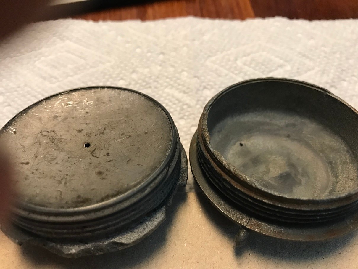

I don't think the baffle is soldered, just the edge rolled over onto it. I don't see any signs of solder. Sure Henry found it cheaper to roll the edge than add the cost of solder. The one without the baffle is missing most of the edge (2 o'clock position). Agree in material used.
So you might be able to eliminate the rattle with a little tap on the edge or some Permatex Blue/Red

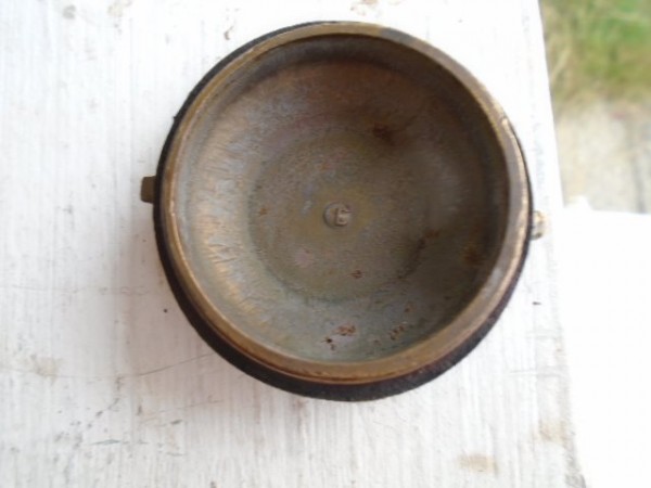

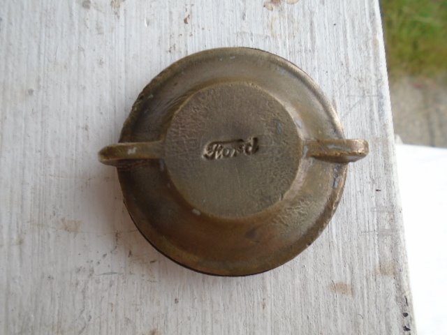

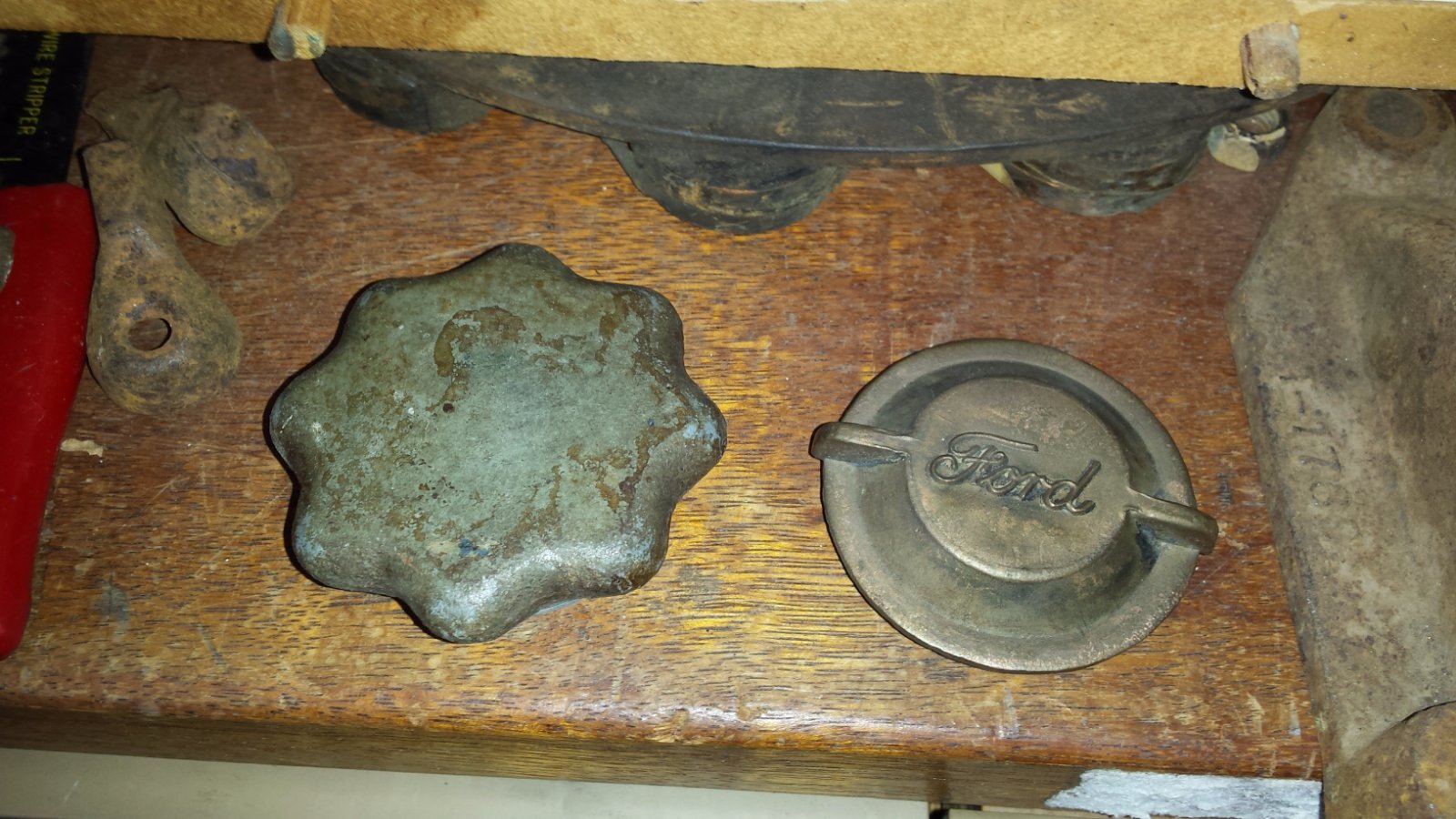

This one was on the gas tank that came with my 1925 parts chassis that was last part of a running car in the 1950's.
I'm assuming it's factory because of the Ford script...unless someone made Ford script repros many years ago.
1924 Touring
- Posts: 3976
Don
Your cap is a later reproduction.
The original style is the two piece one. And yes, looking at the old cap seems no solder. Just assumed solder joint, guess that zinc die cast was formed around the thin steel plate when new.

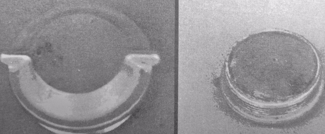

As for the earlier caps, those are zinc die cast, but one piece. Used from 1919-1923
Original is upper right, the shiny one is newer reproduction. That original is pretty used up, solder glob covers a hole placed probably to use this cap to keep pressure on the gas tank for hill climbing.
Lang's sells the late style gas cap. I'm pretty sure they have the baffle too. Originals have the part number cast into one of the wings. Yes, the baffle was just held in by the edge of the cap being rolled over to hold it. Beware when buying and original. Many times the pot metal has swollen, and will not screw into the gas tank. Often, the baffle can be found in the bottom of the gas tank. Fordson's also used this cap.

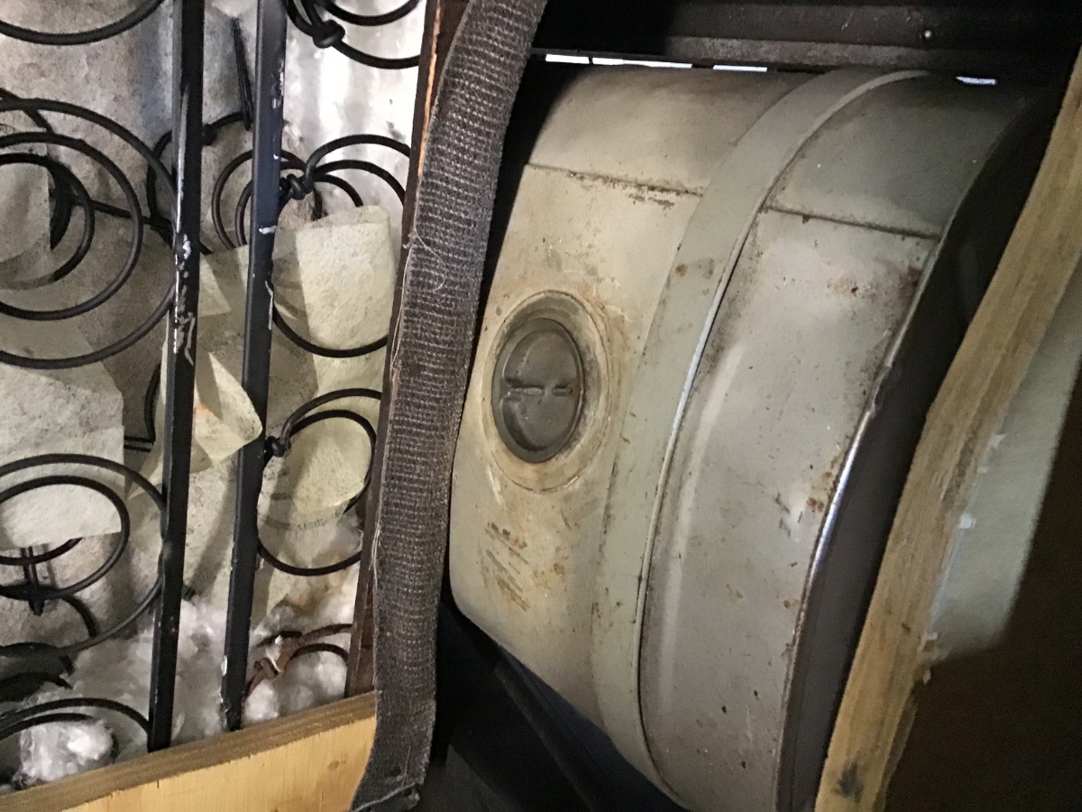

I think the bottom picture that Dan posted is from an oil drum.

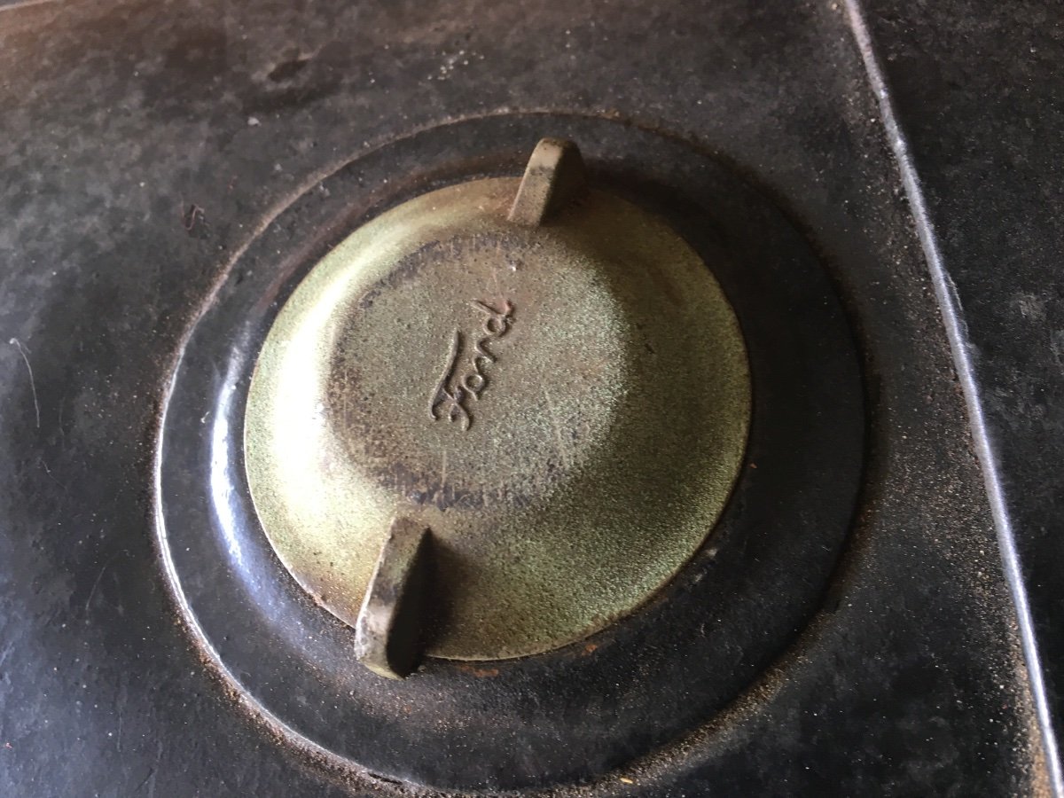

Here’s the cap in my 24 Coupe. I changed out the original tank because of to many seam leaks but this is the cap that was in the car when I inherited it in 1958.
He was the 2nd owner when he bought the car in 1942. I think I will use this cap since it was the one he would have used. Sentimental I guess.

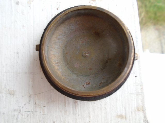

Here's a variation on the brass script Prefect cap and a later Fordson cap that will fit.
