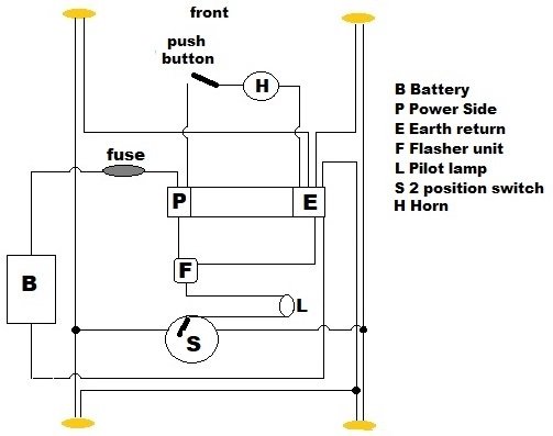

Post by havnfun » Tue Jul 30, 2019 8:46 pm
directional diagram.png (259.69 KiB) Viewed 5338 times
Hope this helps

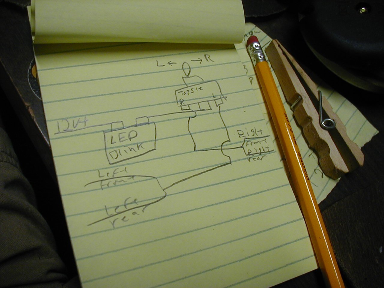

I have seen that too Dick, I thought.
I must be the dumbest tho. I look and see complex above. I scribbled just now, got it wrong the first 3 times. Not shown.
Here's how I do it at work I think. Sorry so simple :oops:
LED Blink isn't doing anything until the directional switch offers the lamps the juice to their ground and presto, it blinks.
We use cute little yellow 3" extensions for the toggle that ya stuff on. Not shown. :lol: True.
Living in madness ain't that bad.
EDIT: I did not show the L&R indicators but ya just double up at the switch terminals and it works.
I could scribble up another...

Post by A Whiteman » Wed Jul 31, 2019 2:22 am
Duane, I found it useful to 'hard wire' the earth return if you are having earthing issues. Wiring back to the other side of the battery is more work, but you always have good connection.
