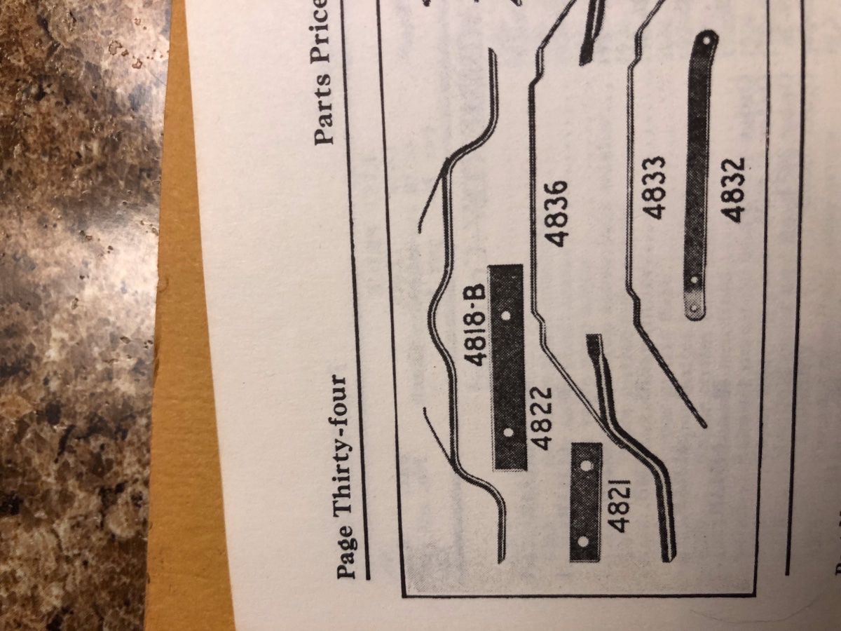

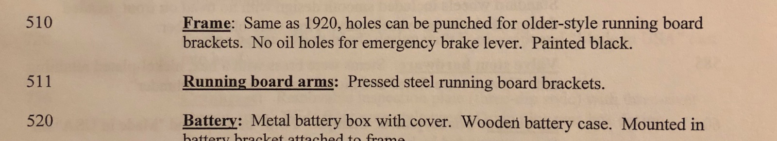

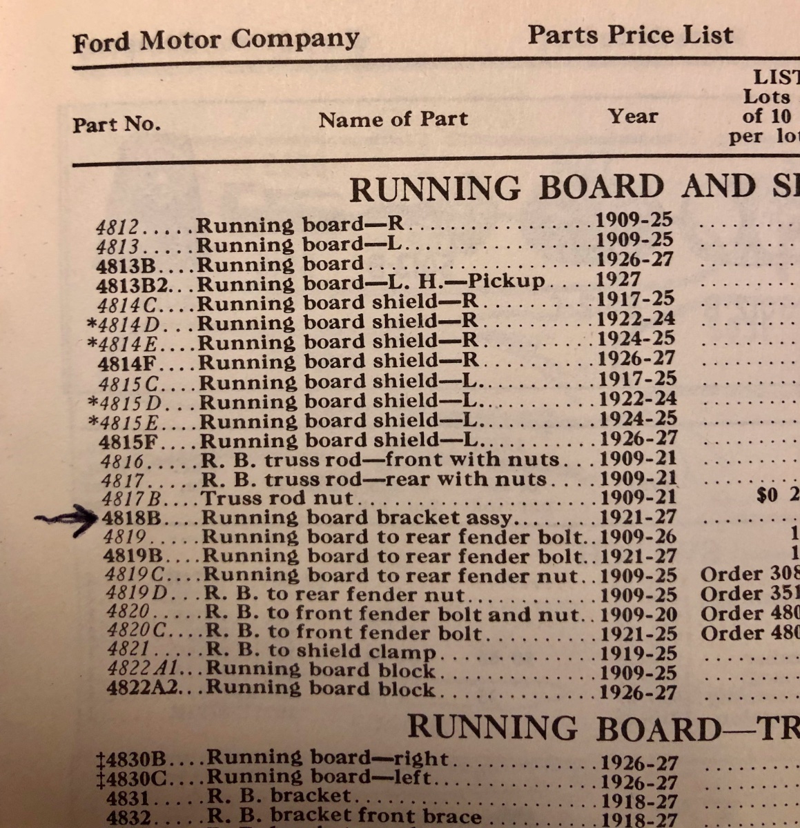

Chris
Present the officer with this official Ford record. Ford Price List of Parts, Effec. August 5, 1928
Has record of change by part number. The pressed steel running board brackets are what you say, first done in the 1921 model year, as your T is late in the year of 1921, the pressed steel brackets are correct. The frame rails on those frames have holes for both type of brackets, forged or pressed, so your frame is correct with both sets of holes in place.
P/N 4818B.
Other fact. MTFCI Judging Guide Lines note the 1921 chassis frame rail used the pressed steel bracket in 1921, the frame was same as 1920 as both had the double holes in the side rail for either type bracket.
P/N 4818B.
