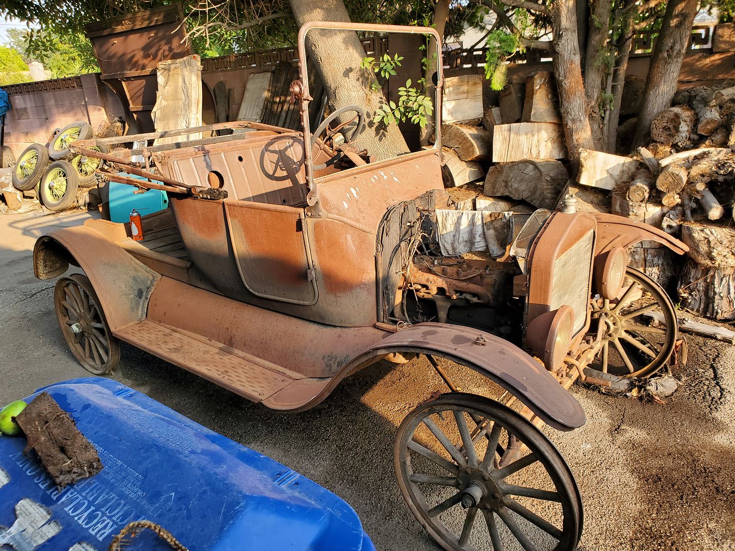

I have run into a hard ass CHP Vehicle inspector. Although every part of my car, including the engine number, puts it as a 1921. Block cast 7-2-21 vin 5130623 puts it as July 1921. It has the pressed steel running board brackets instead of forged steel. The problem with him is how do I know that frame is a 1921? He wants to see some sort of factory information that will tell him my frame is 1921. Is there any available?

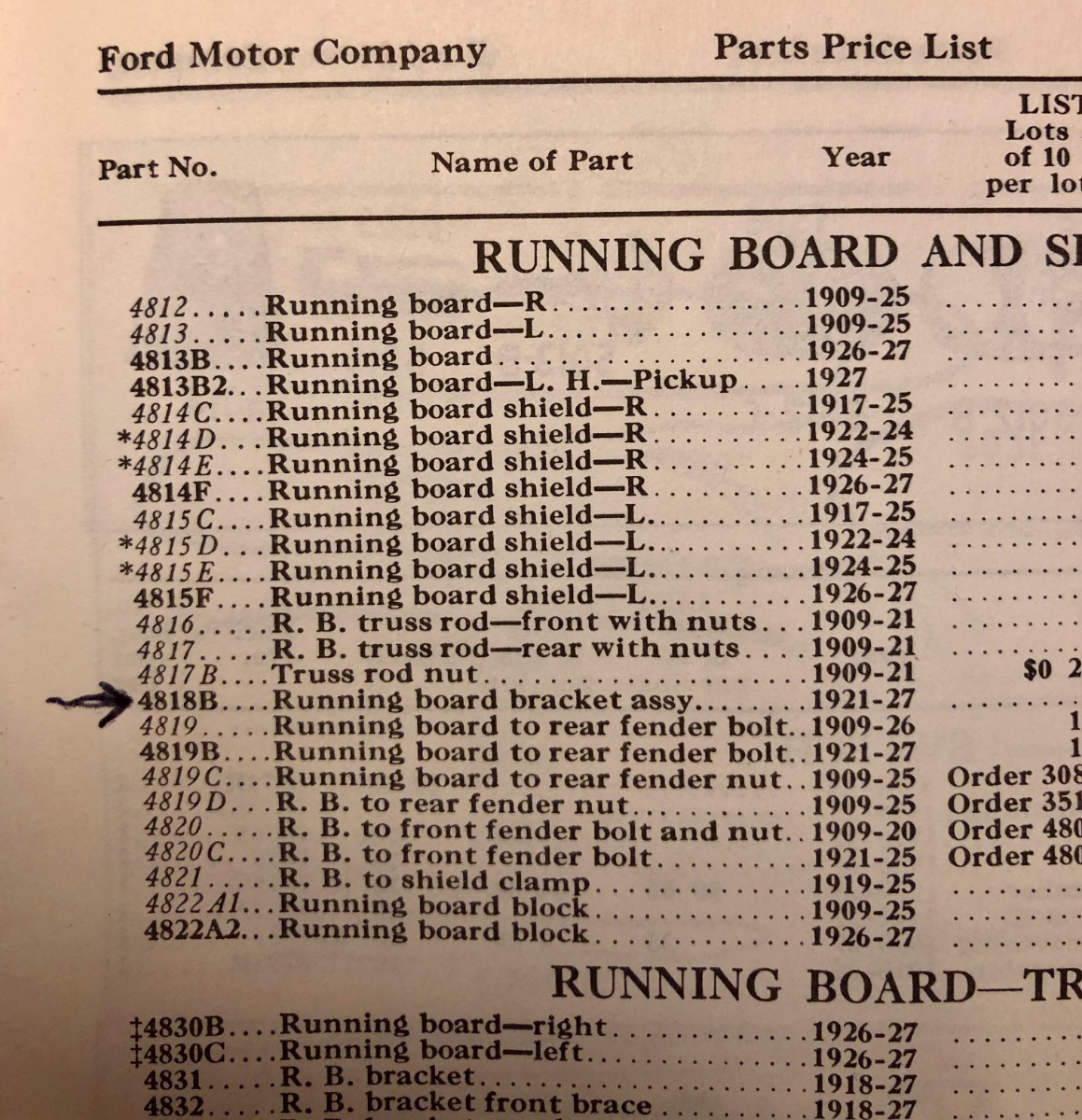

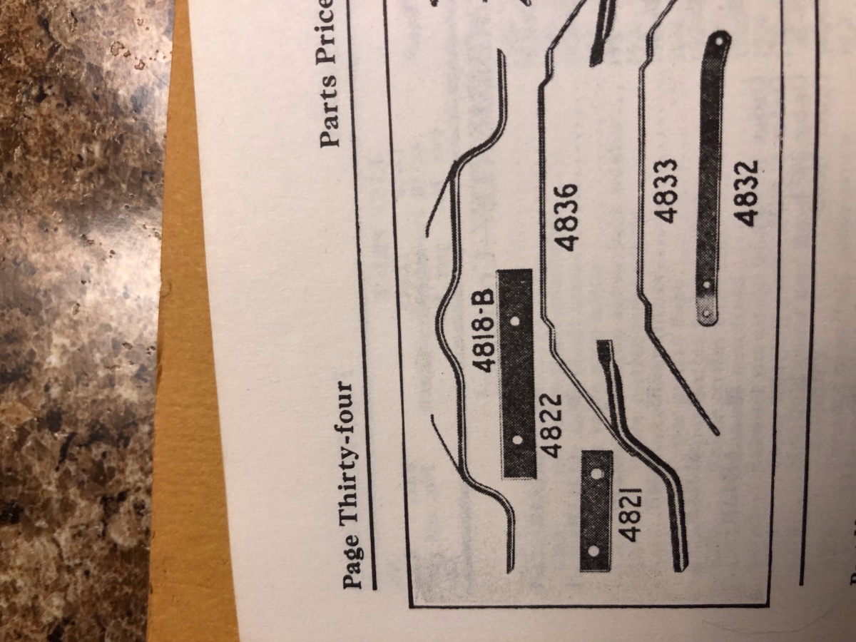

Present the officer with this official Ford record. Ford Price List of Parts, Effec. August 5, 1928
Has record of change by part number. The pressed steel running board brackets are what you say, first done in the 1921 model year, as your T is late in the year of 1921, the pressed steel brackets are correct. The frame rails on those frames have holes for both type of brackets, forged or pressed, so your frame is correct with both sets of holes in place.
P/N 4818B.

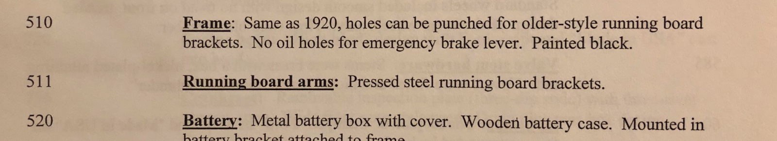

Other fact. MTFCI Judging Guide Lines note the 1921 chassis frame rail used the pressed steel bracket in 1921, the frame was same as 1920 as both had the double holes in the side rail for either type bracket.

He says it is common for engines to be replaced and just because I have a 1921 serial number on the engine doesn't mean that it is a 1921 frame. It is definitely not a Hot Rod. More like a Shot Rod. I have no choice on where to take it. The DMV directed me to this office of the CHP in writing.
https://i412.photobucket.com/albums/pp2 ... ljsuc6.jpg
