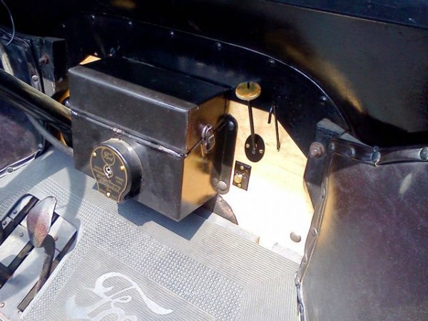

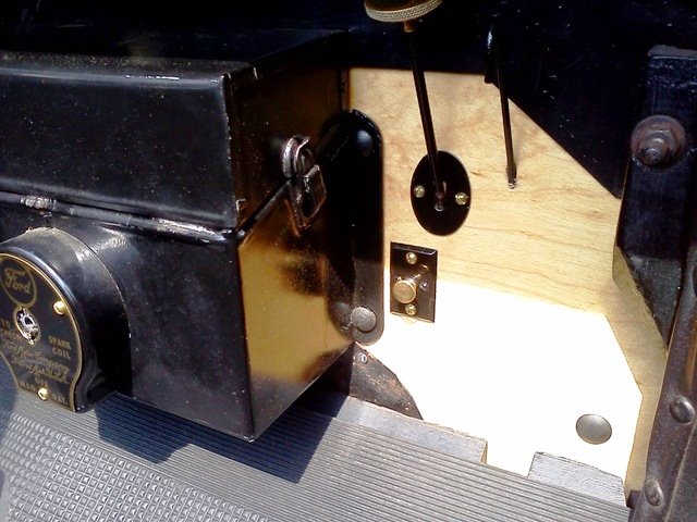

These may help verify the location.

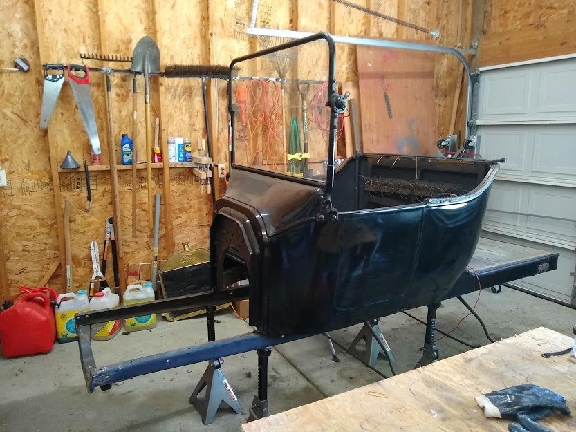

It could be that somewhere in its history the original engine was replaced with the one that was assembled at the end of September 1914. Hard to say.

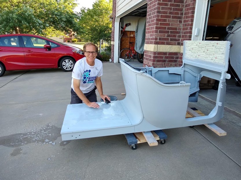

Here's a picture of the body before I stripped it, and after I primed and sanded it. I hope to start shooting black on the various chassis pieces tomorrow. The frame has been powder coated. After that I will be painting the body and fenders. That paint should be delivered tomorrow.
- Posts: 6708
Re: 1915 Headlight push/pull switch firewall location
Now that we've seen the body, you may wish to consult John Ragan again...this is different body than I think he has given you info for.
It looks like it will be a very nice car when complete
Thanks Scott for the comment. I actually talked to John last night, and he gave me the dimensions for the switch and data plate that I needed for my particular firewall. Thank you John for that information! Based on our discussion, I had to rework the edge of my firewall some to get it to fit nicely into the cowl piece. I am very glad I talked to you about it BEFORE I varnished and painted the firewall!
I think John knows more about T firewalls than Ford did. In fact, if you look at the Ford drawings, the last revision probably says "go talk to John Regan"...
John did mention that the drawings didn't have the holes for the horn though, and that they drilled them upon installation. I guess I'll wait until I get the firewall and dash shield with the horn tube cutout installed before I mount it. I recall that there's been some pictures of the horn installation posted in years past, but if anyone wants to share a picture of where they have their horn mounted on a 15 firewall, please do!
Thanks for the help everyone.
Neal

Looks like a nice runabout! Thanks for the pictures.

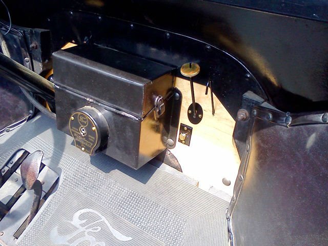

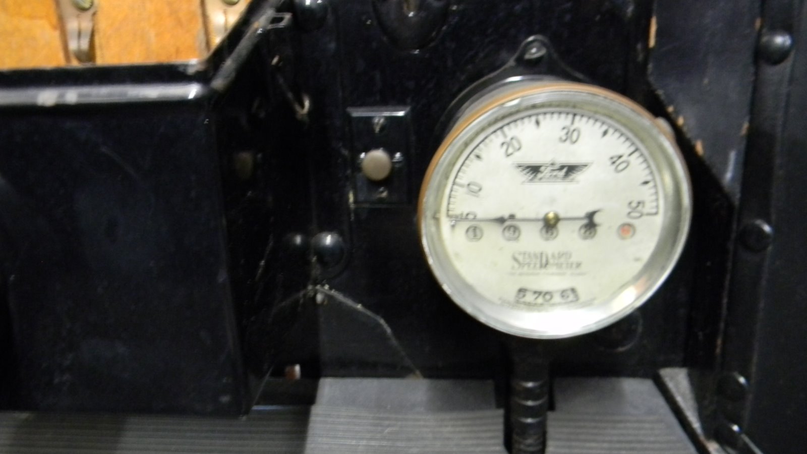

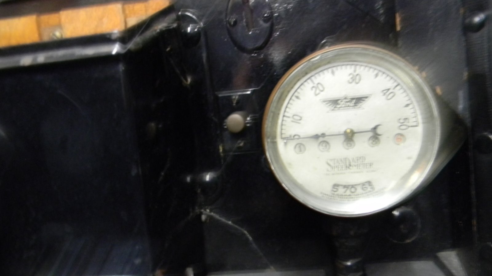

My '15 was one of those delivered without a speedometer, but that makes it easier to see the placement of the headlight switch.

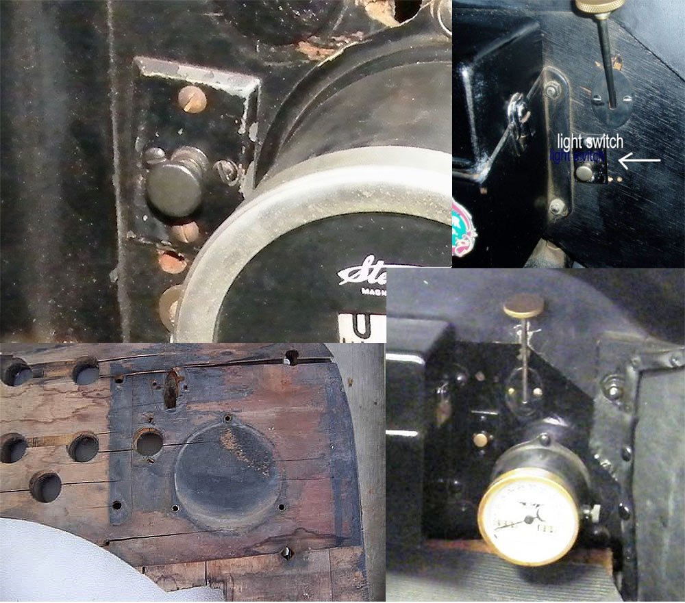

I just bought a '15, and have yet to get it to my house, but it has what I believe to be an earlier switch. It's brass, and is round in shape.

My '15 roadster is a June 4 1915 car and it has the round brass switch in the firewall but the car was restored 25 years ago or so and the dash is NOT original based upon the wrong size choke hole and wrong angle drilling of that same hole. The good news for me was that the hole was drilled to something under 1/4" diameter so I was able to clamp my hole drilling jig onto the bottom edge of the dash while the motor was out and ream drill the hole to the correct 1/2" diameter and correct angle. Luckily it corrected both the diameter and angle and looks like it was never wrong. Sometimes you get lucky. The carb control was at a severe binding angle before I redrilled it but is nice and free now and the escutcheon plate on the people side of the dash was located OK so that went back into place with same screw holes.
The 15 dash that fits the "common '15 hood former" was in fact drawn up and approved for orders on August 7, 1914. Proof that those dashes were in stock in at least small quantities on August 25 of 1914 is that they changed the drawing on that date to alter some hole sizes and added 2 holes that "may" have been horn mounting but not enough detail in the verbage to determine where those holes were added. They WERE pilot holes though.
