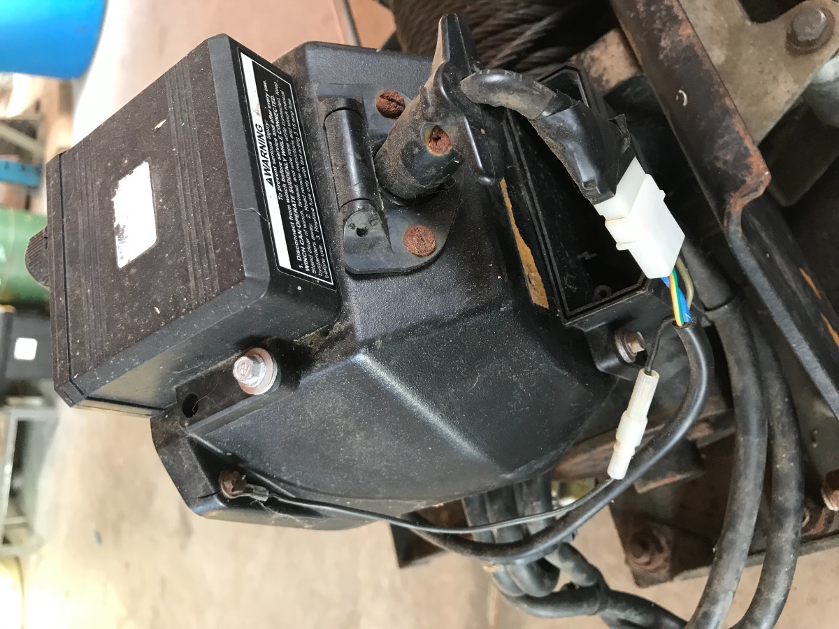

Note: any radio-control switch that comes with the winch will eventually fail. The reciever and the transmitter can both be bought for rediculously low $$ and can be installed in the system by simply removing the cover on the receiver and swapping out parts. This info will save you from re-buying the complete unit and going through the trouble of rerouting cables...this is an example of what you'd buy to repair any unit: https://www.amazon.com/Wireless-Remote- ... way&sr=8-5

Maybe a trivial question, is it possible installed a remote on a regular winches who do not have any set-up for receiver?

Yes. I did mine using a HF Badland remote.
Use your winch control cable and cut it 2-3” from the plug. Then splice it back together with a plug so it can still be used when you want to.
Then take the HF remote and again put a control side plug on it. That way you can plug in the remote or the wired controller.
I mounted the control box for the remote to the top of my X9 superwinch. Works great being able to stand anywhere when winching.
