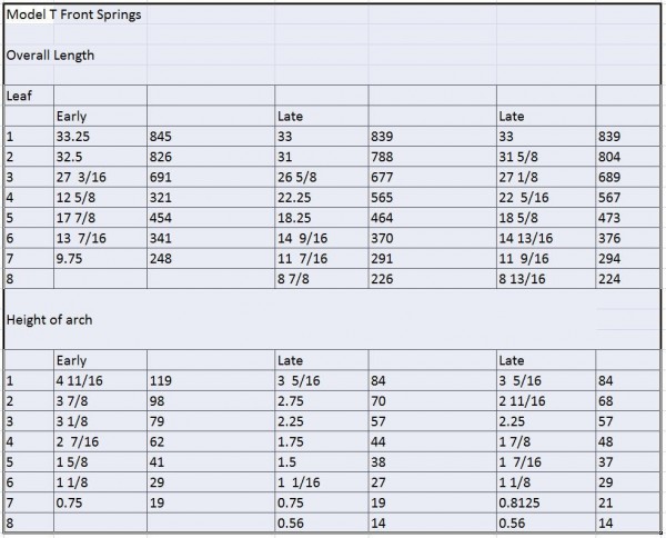

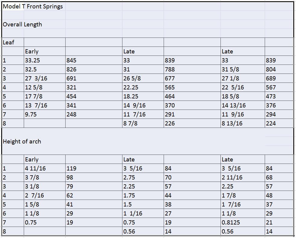

You can reset the springs cold. I did mine last year, one leaf at a time, in a broaching press. I sat the leaf between two blocks about 30cm apart and pressed down between them. I repeated this for the full length of the leaf to get the right curve.
I put the spring info from an earlier post in a spreadsheet with metric values for the modern era.
http://www.mtfca.com/discus/messages/41 ... 1411857354
With thanks to Tom Carnegie and Bill Mullins
