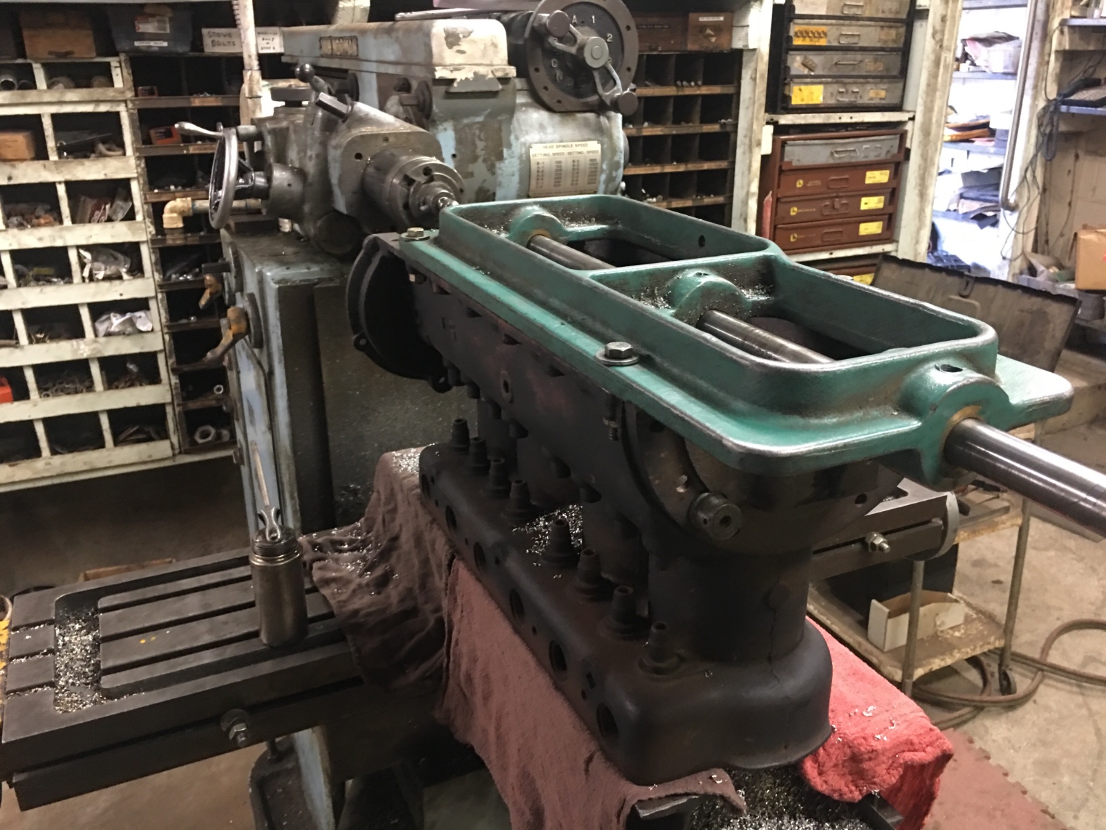

Line boring early block

That's an early Puppy Erik!'

Is that Mike's?

Yes it is an early one. Number is just over 5000. I know the owner as as Micheal.

Interesting picture, Erik. I've never actually seen a line boring operation, so maybe this is a dumb question (won't be my first ........ or last).
I notice that the block is not clamped down to the table. As a matter of fact, it appears to be sitting on a cushion of shop rags. So, what keeps the block aligned to the machine's drive during the boring operation ?

If I remember my lessons from Rumble Seat Garage, the above photographs show only the first stage of a finely tuned two jig boring process.

Erik, if you lay a standard crank in the bearing surfaces, how much wear if there? Or was the block previously babbited?

The block is clamped down through the cylinder bores. The rags are there to protect the deck surface from scratching. The mill drives the bar with a flexible coupling so perfect alignment is not required, but I get it close. This block has been opened up to use babbit on the upper main bearings. Originally it would have run the crank in the iron bores.
