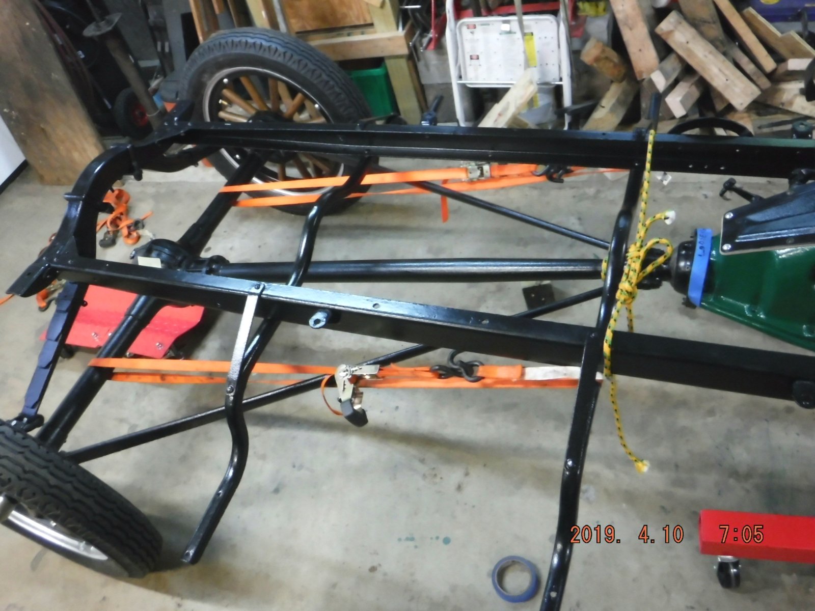

I had an issue with getting the u-joint and the engine to fully engage. I rebuilt the rear spring and this moved everything back almost 1/2 inch. I wound up loosening everything attaching the springs then used ratchet straps to compress the u-joint and cover in. Then I tightened everything down. I have driven it since then and everything is ok.

I did the same than Jim last week. But I have an early one (1911) and I Attached the strap at the front of the car, and it work well. But need to be attached at the middle of the front axel to avoid banding the front axel.
